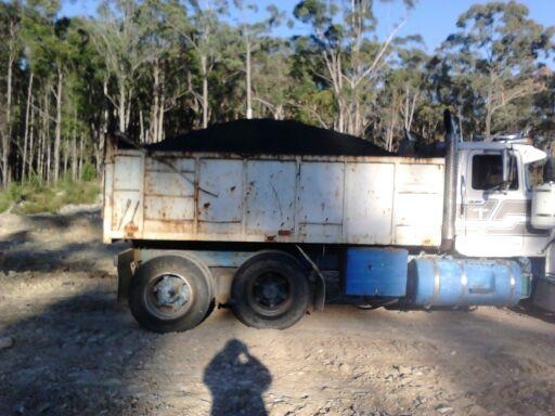

This is my 300hp 2v all loaded up with blue metal. Over 16 ton on the back, mind you it was only driven on our property but my brother who was driving said it barely changed from empty.
10 speed trtxl 1070 with 4:42 rears.
