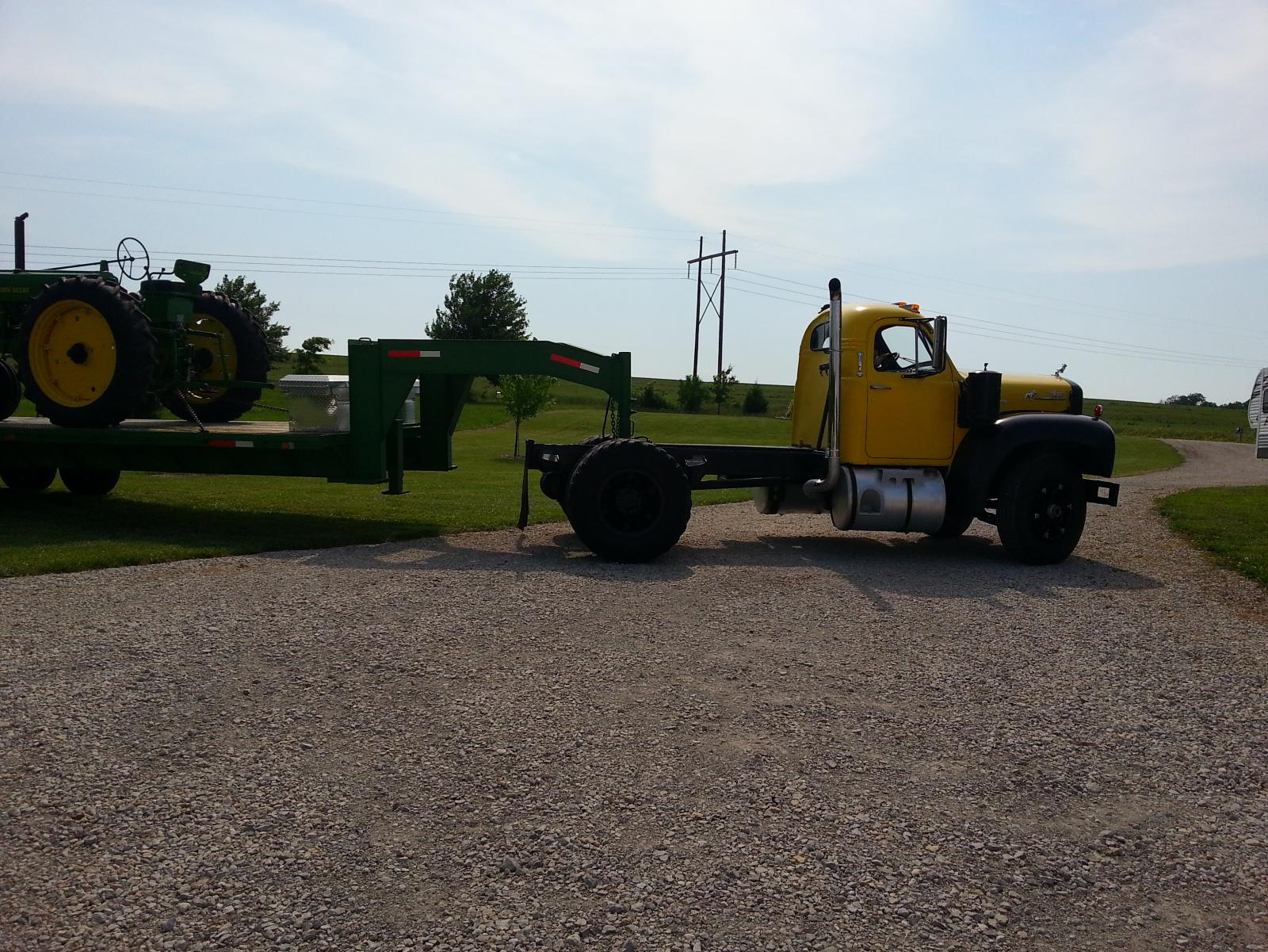

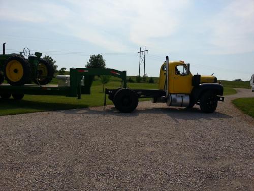

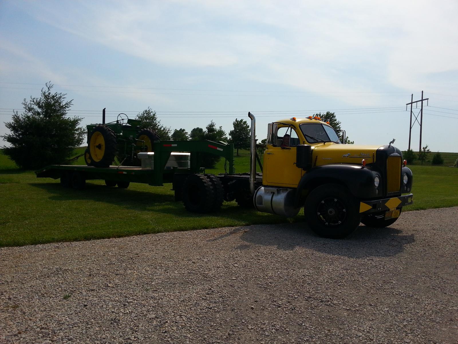

I use a regular electric brake controller set up for 8 axle I have the electronic ones with time sensor and motion. I have one in both of my Macks they seem to work good with my 20K Gooseneck trailer. My B did not have fifth wheel so I made a GN Ball mount and have it set up with a 7 way RV plug, on the R I bought a kingpin receiver tube so depending on which truck or even my 1 ton I just have to swap the tube over about 3 minutes.
