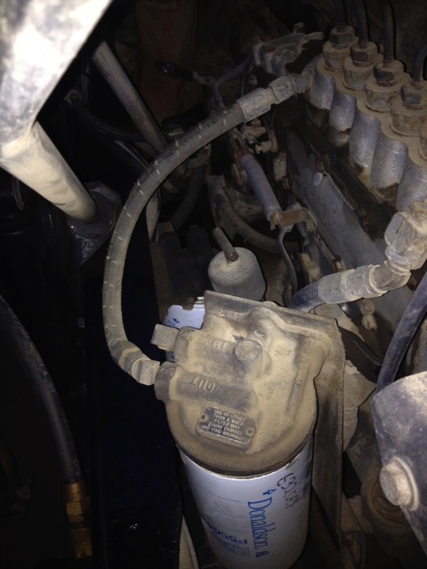

Trying now by rerouting a fuel line to eliminate a potential problem from the line creating a vertical uplift into the pump. Probably not the answer but I am clutching at straws at the moment and it was suggested that the fuel line might be better to have a straight run all downhill to the fuel pump then that setup I had - see photos

post-19717-0-02977400-1422609198_thumb.j
How long did it work for after tightening cross over tube Dave sometimes they need another nip up ( don't know why but I had one come loose again then nipped up and was good for ever give me a call when you have it sorted we finally have dry weather up here so can get back into carting onto sites again
The change of position of the fuel line to the pump made no difference at all. There really was only 1 drop of fuel in the container under the pressure relief valve indicating there isn't a leak here.
