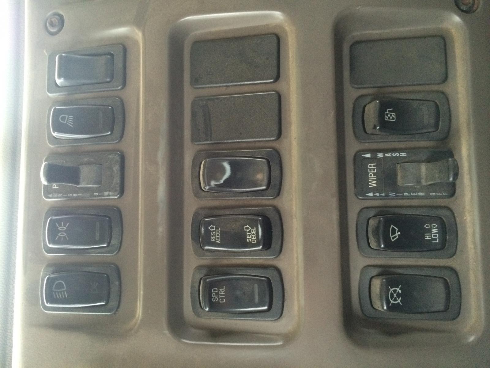

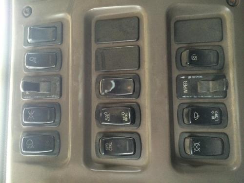

2001 CH613 Dash Switches
Go to solution Solved by Ezrider,
top right-I don't know
middle row-on mine, that is Jake switch.
2001 CX
you got power passenger window? That might be it
just hit it a few times and see happens-and video the results
Top right should be fog lamp switch looks like it might have been added later and someone did not use the proper rocker switch with the markings for the fog lamps.normaly your top row is all lighting controls .
Agree with lighting on top (left side) row but isn't the fog light switch the second one from the right (top) in pic? From left to right (bottom to top) is headlamps, marker, dash dimmer, then fog lights. Perhaps it is the hookup lamp? This is getting confusing...another reason to post pic properly...just sayin'.
Ken
  • Solution
head lights, marker lights, panel dimmer, lights on the back of the cab, not the original switch could be anything, (something someone added later or replaced a factory switch), cruse control, cruse set and resume, should be the jake break, shut down overide, wiper high low, wiper delay, heated mirrors
