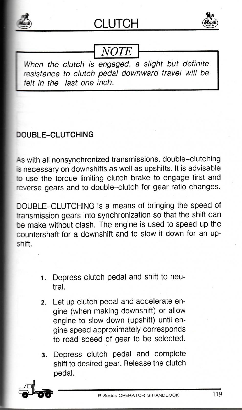

How far does one have to push in the clutch for the brake to work?
If everything is adjusted correctly, it should engage the clutch brake in the last inch of travel.
My 1992 R model handbook says the clutch brake is NOT to be used going up or down on shifts.
post-7036-0-32922400-1389985208_thumb.jp
Jim
Right! Not be used like that in today's trucks, for sure. As Jeff stated in his initial post, it was still an option in the early '70's for the countershaft mounted clutch brake. It was listed in the B,G,N,H model Operator's Manual that I have.
The MH handbook has similar verbage. I don't think I push it to the floor when I shift. Reason being, when I am sitting and want to put the tranny in gear I need to push the clutch in until it hits the floor stop. Thanks!
