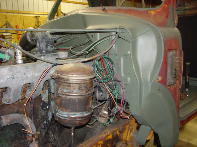

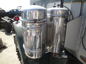

LuberFiner? its an external oil filter mounted on the drivers side of most trucks when used, a lot of older Pete, KW and Freightliners had Luberfiner external oil filters. They were designed to add oil capacity and an external high capacity oil filter to extend oil change intervals and reduce oil contamination and soot/sludge build up in the engine. I have pulled a few off of trucks for people due to the lack of parts and high cost of replacement after they are rusted and dinged up but have never run one myself. Heres a couple pics, both on Peter 359's
