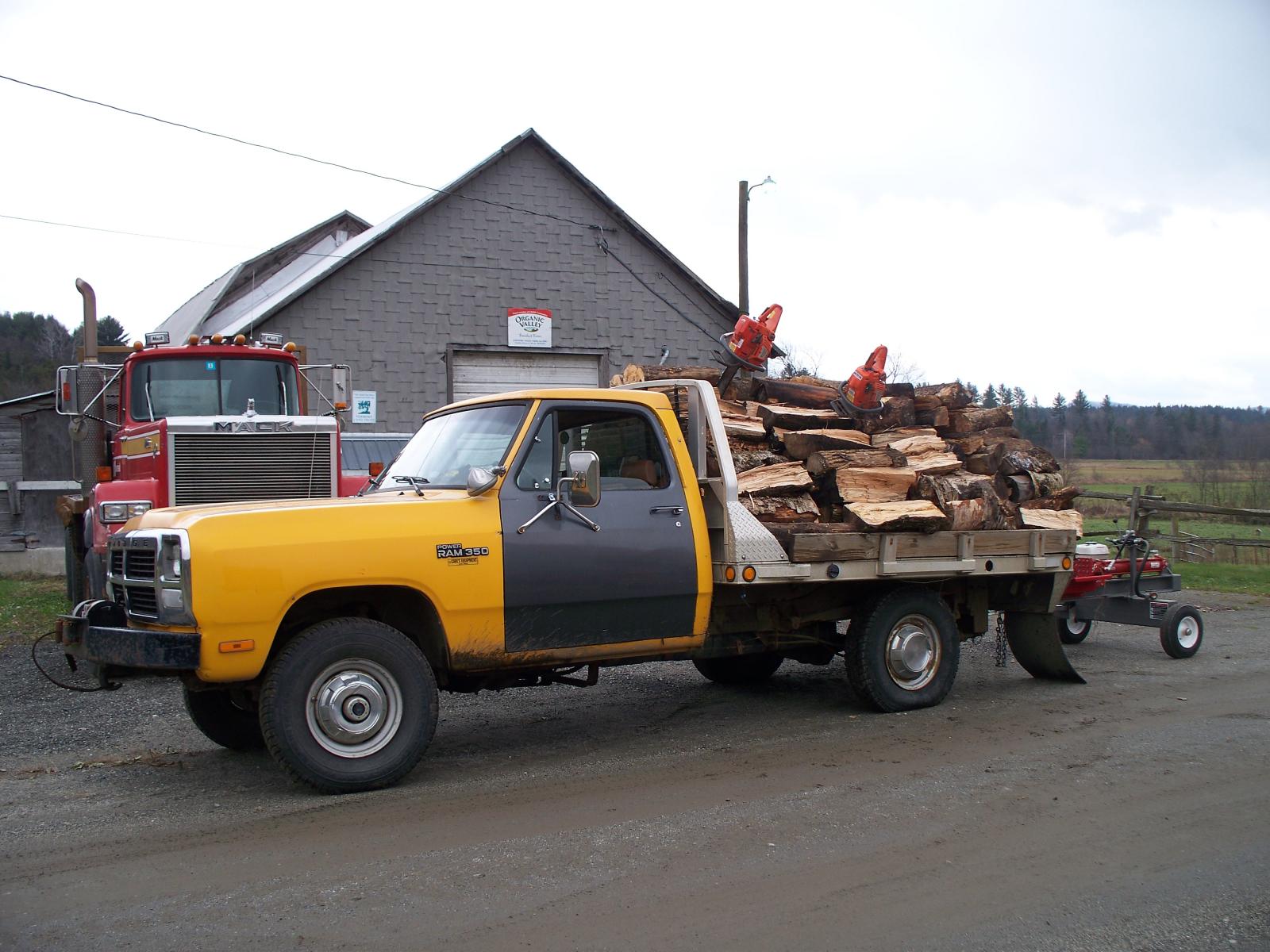

The ole Ram still doing it's job
Timothy Maikshilo
Um, the flatbed Superliner looks like its wanting a load of wood too.

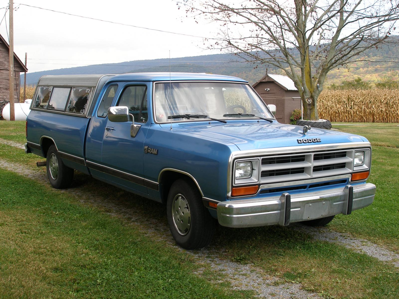

I showed my friend the picture of farmer52s' Dodge. His appears to be identical except it's 4WD. We'd like to see more of farmers' if he has any.
Thanks for the pics of your friend's Dodge. Does it have the 360?
The truck is in "winter storage". I will clean it in the spring and take some more pics. The pickup has a solid bench seat (gray interior with no carpet), 4spd OD auto, sure-grip, A/C, and AM/FM/cassette. I have the window sticker at the farm, will scan and send. It still has the original tires but are starting to dry rot bad. I plan to get new tires in the spring. Also thinking about locating a set of the optional aluminum wheels which will likely be difficult. Even with the OD transmission, it only achieved about 15mpg on-highway....a real gas hog.
