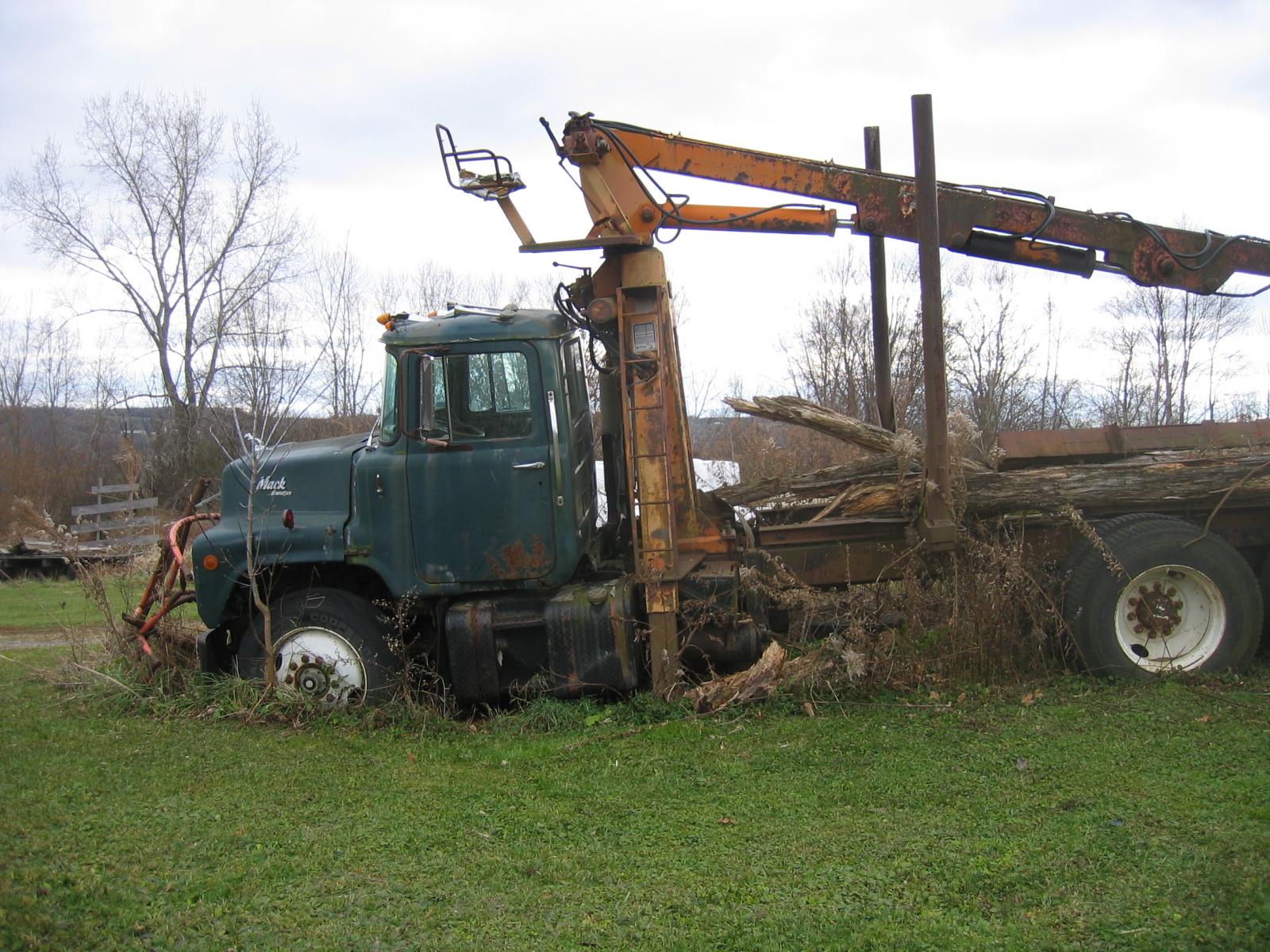

I am hoping someone can give a little help with a Mack I am looking to buy.
The truck is a 1984 half cab log boom truck with the 8th vin is a Y
first, I need help identifying the engine, what is it?
Second, maybe a little insight on it's problem: the owner said it was driving fine and then started missing and stumbling. Had a mechanic come out who took off the valve covers and told him it was the cam.
Did this engine have a problem with camshafts? Or is there another related issue common?
Thanks in advance for any input

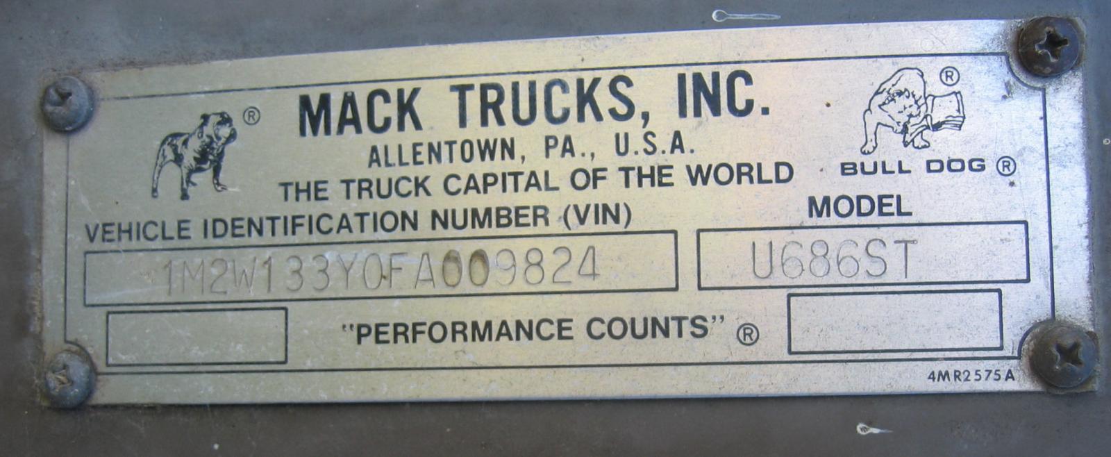

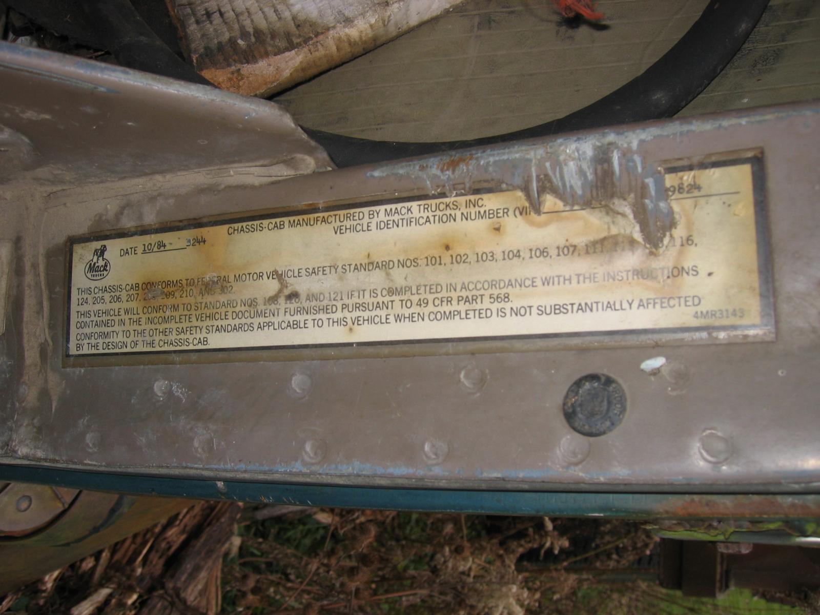

1984? The only "half cab" Mack produced was the HMM, from 1973 thru 1979. Located on the driver's door, what was the model number on the vehicle identification plate?
https://www.bigmacktrucks.com/topic/33370-y-engine-missing/#findComment-215046
kscarbel
I will get all the other info for ya'll in a few days.
It did say 1984 in the door tag, and i thought I was getting the engine with the 8th
it is a half cab... I can say that for sure, but the rest will have to wait a few days
thanks for the reply
https://www.bigmacktrucks.com/topic/33370-y-engine-missing/#findComment-215052

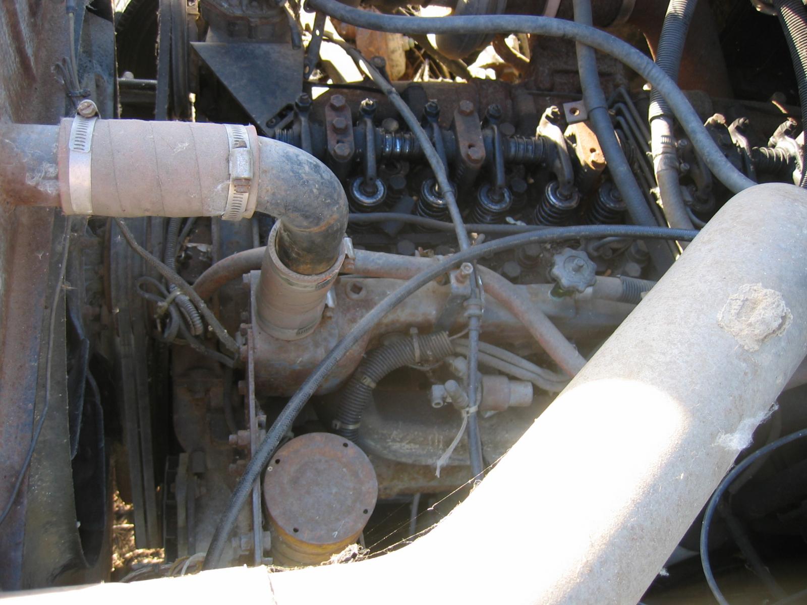

my best guess is that it is air to air intercooled, wonder if the hp is 300?
A friend looked up the vin at the mackshack and it should be the E6 300 2V engine with 5sp and 4.17 rears
ane idea about the miss?
he also mentioned this might be the engine which the faces of the lifters fell off and wiped the cam

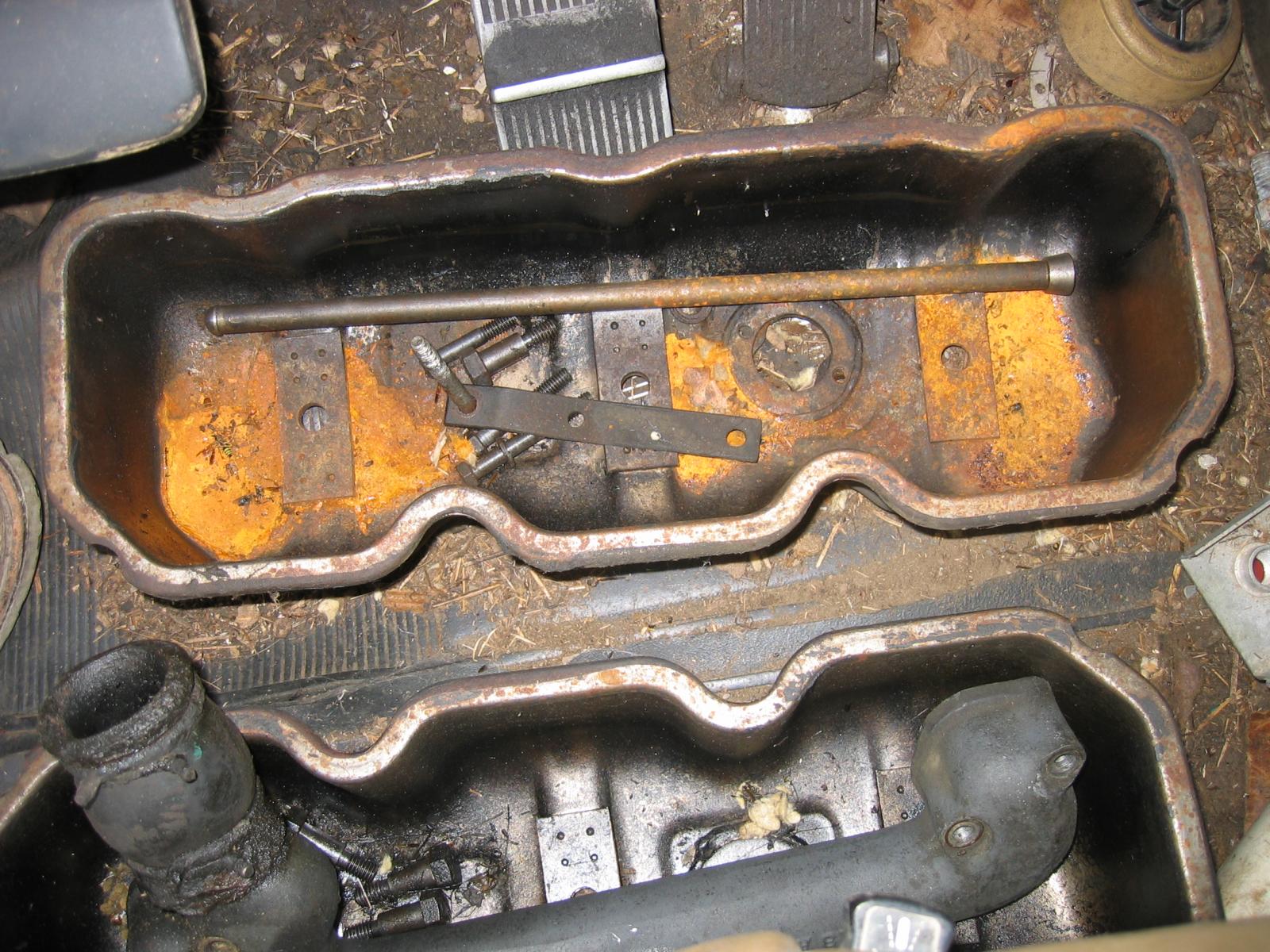

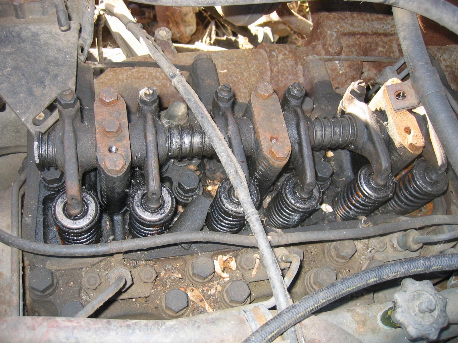

also maybe the mack eng brake stuck. can you tell from the pics if it has a brake at all ? I don't see any wires
thanks for all your advice
https://www.bigmacktrucks.com/topic/33370-y-engine-missing/#findComment-217930
Looks like the air pipe comes from the radiator area and then goes into the intake manifold.
How long has the motor been open? The top of the motor looks plenty dry with no residual oil on anything. Looks like a lot of crap has gone into the head.
Plus, there is a tree growing next to it.
Jim
https://www.bigmacktrucks.com/topic/33370-y-engine-missing/#findComment-217937
It has been sitting like this since 2005 with the hood shut though
I don't think any water got in it but if it did it went straight down and can be drained
so you are thinking maybe it has had the intercooler added?
What exactly is the tip turbine?
https://www.bigmacktrucks.com/topic/33370-y-engine-missing/#findComment-217942
