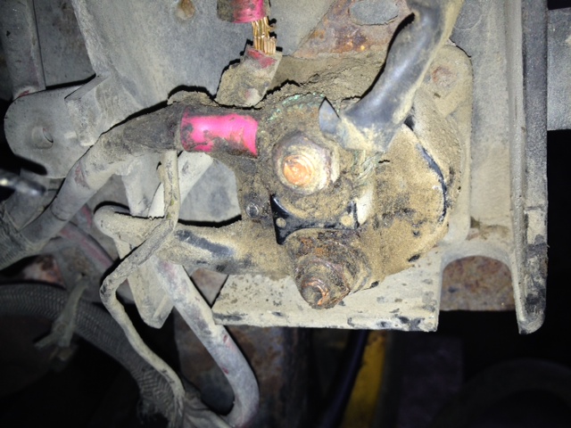

We located the solenoid under the cab on the drivers site in a black plastic box. One cable was loose on the top solenoid and if we bridge the bottom solenoid the truck fores wright up. I will replace them both at this time since the housing cover on to top one is loose. also will clean it up since there is a lot of dirt in the box. :notworthy::twothumbsup::SMOKIE-RT:
Sorry to steer you in the wrong direction, that's the junction box Mike and rw613 were talking about.

In the junction box on your truck there is a solenoid for the starter and the other thing should be a heavy duty circuit breaker.
I don't remember for sure what the rating was for the breaker but it was pretty high and was marked on the reset knob coming out of the other side
of the junction box.
It had to be manually reset if it was tripped.

Ron,no problem I have learned a lot the last couple days and apriciate al help a received from you guys. Even the boys off watts where lost. When we tilted the cab forward we noticed the box. I bought both so will install it in the morning. You guys are all great people out there that are willing to help or give advice. My next task will be the a/c unit to get it back working again.
