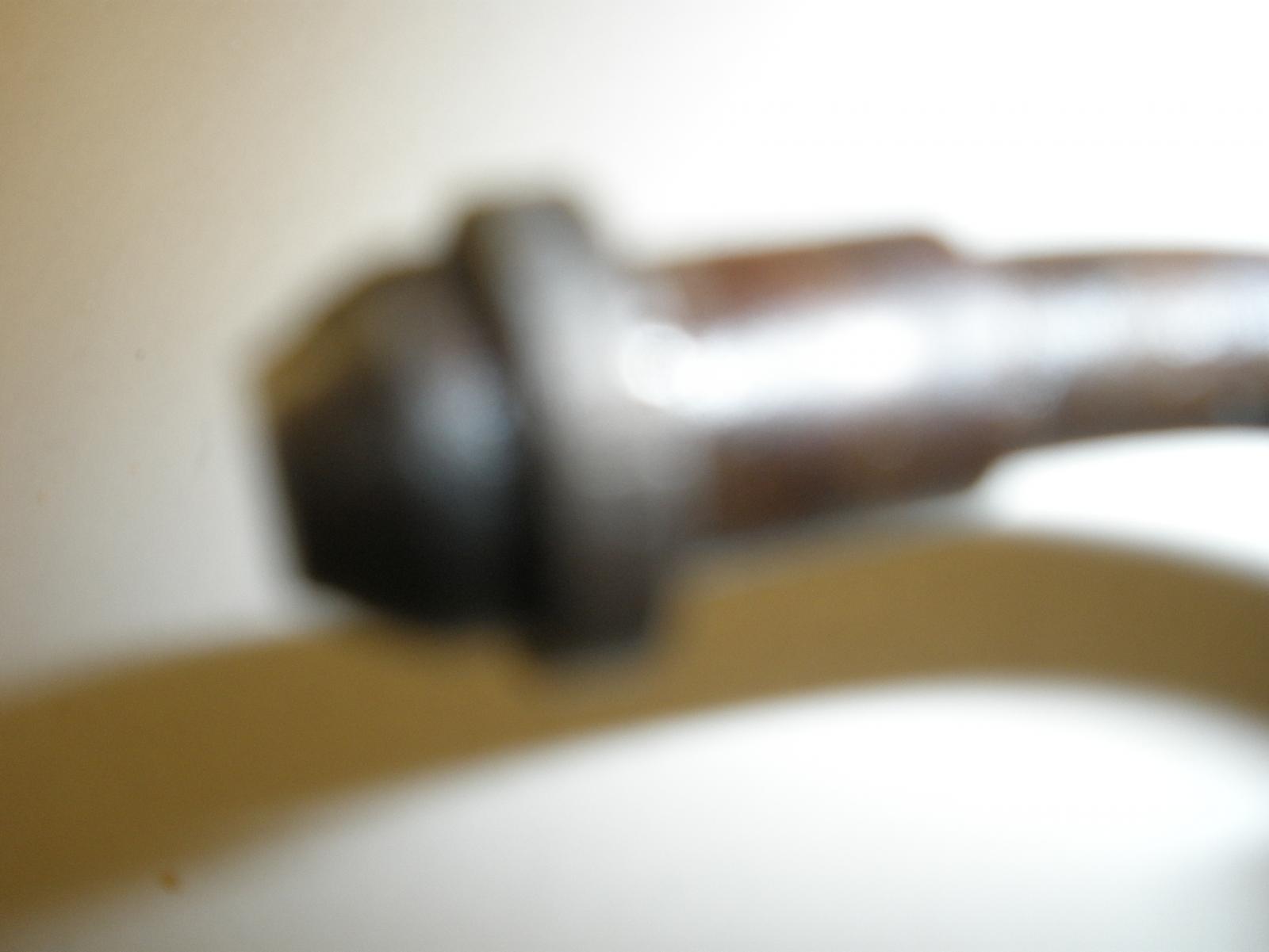

Ok, after like 50 yrs, my return line to the pump has a leak. Seems the little rubber seal is about non existent. Was talking with peole yesterday and found out it is suppose to be like a compression seal originally. Mine only has a small rubber ring at the top, which is allowing the line to wiggle and leak. Been that way since I got the truck actually, but finally starting to leak.
Is it going to be hard getting new seals for the line? Might call Cross truck Monday to see if they list them. Is there anyplace else that might carry that stuff readily? Would a dealer carry this?

O-rings not big enough to take up the needed space. These apparently looked like a "T" shape, and mine only has the top of the "T" left(or maybe just a straight piece like Ron mentioned?). The remaining portion that seals against the tube itself is long gone(thus the 1/4" tube is loose in the fitting and leaks). I'll check around tomorrow, I slipped a brass ferral on the end of the tube and snugged it down just barely(enough to keep it from working loose-but not so tight as to crush the ferral). It kept it from leaking for the trip to Milan, Michigan this weekend. But, I want to fix it properly. My guess is it needs to be a soft seal, as with the vibration I'm sure it would crack the line or fitting in short order.
Larry
So I called R/R Mack in Akron. Tell them what I need, he says, "yup, should have some, how many do you need?"> I tell him two, and he puts them in will call. I stop over on way home and get them. Little plastic sandwich bag with two little round tapered seals. The guy drops it on the counters and waves me away(as he picks up a phone call). He was busy and didn't want to mess with charging me the .05/each ?? I thanked him graciously and walked out.
I pulled the line apart again(still dry) and removed my brass ferrel and then poked the original rubber "seal" out of the brass nut. I then slipped the nut on the line and then the new o-ring. I tightened it down and started it up. Dry, perfect. The line is still kinda "loose" feeling, but no where like it was. I was expecting a bit larger seal, but if this works for now? What the hell, it didn't cost me anthing LOL!!! I threw the extra one in the sidebox of the bunk for a later date.

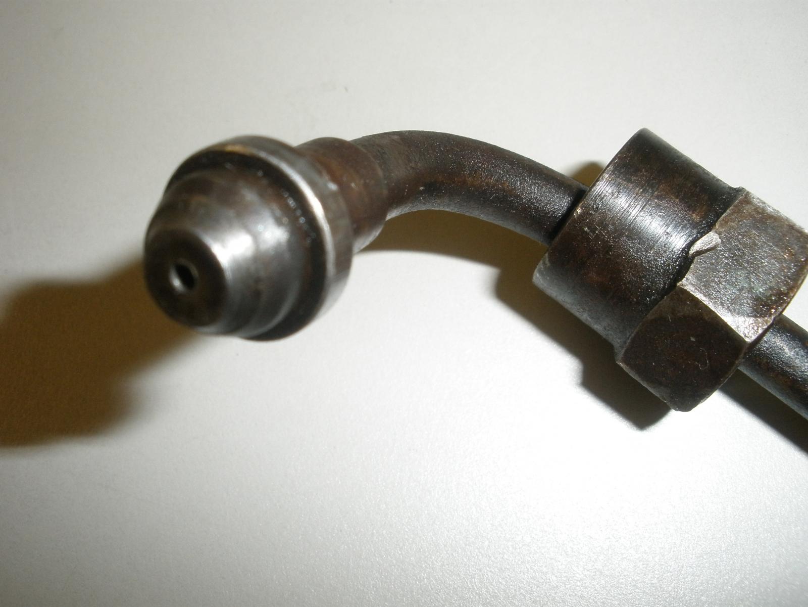

I called the pump shop today and they told me to bring a line over tomorrow. I'll do this while on lunch break. The parts man and I already figured the rubber grommets should standup to any diesel fuels. This is going to get interesting ( It always does ). I have a strong feeling nobody has them, so they will probably have to be made or windup at an industrial rubber company and see if they can play with the idea. The question is......how long is this going to take? We'll see. I hope not all summer.
mike :whistling:
These fuel lines are a press fit and need no rubber anything. If you get a burr under them, they will leak,and they become useless. The return single line from the injectors is different. If it leaks you can put an o-ring inplace or whatever fits because this line has no pressure on it. The pump shop said they can get new lines that are straight lines only. But, you have to bend them yourself. ( Don't throw away old lines )They did say that all six lines are equal lengths.
Note: These numbers are for the END 673 American Bosch
