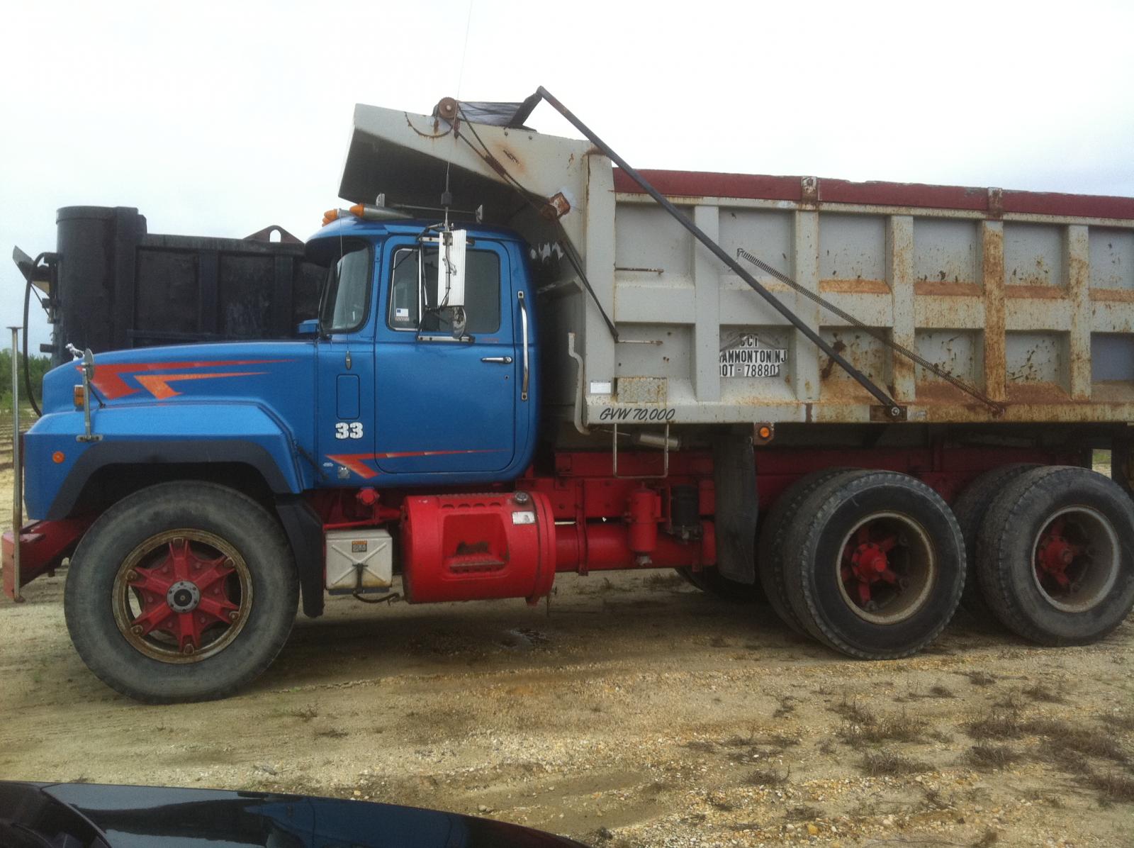

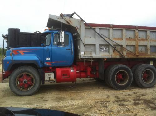

Reel, FA Marchello years ago bought a bunch of those RD's. They were nicknamed flexible flyers. He had F.A.M on the doors. They had 300's, 8LL's , 50 rears, 20 fronts but they had some sort of single frames in them. They were really light but twisted too much hence the nickname. Beams doesn't really look like one of them but that is a lighter spec. I know Frank Marchello hated them but at that point he was getting out of dump trucking and was concentrating on his Allied fuel company.

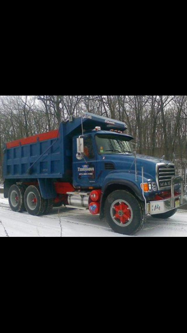

i think they are asking $80k for that blue granite I know that the only person that drives that truck is the owner it is very well cared for
Yes 80k it's a real nice truck but won't be good for NY after 2015 with the new grandfather over weight permit laws coming into effect I would buy it if I could
By 2015 any truck with a type 2 permit that is 2006 or newer must have a steerable/trackable third axle. A type 2 permit is a grandfather downstate permit which makes the truck able to carry between 76,000-80,000 depending on tires front axle etc. they will be able to keep the type one permit which will probably give it somewhere around 67,000. If the truck is older then 2006 then ur grandfathered in and in the clear for now like me lol
