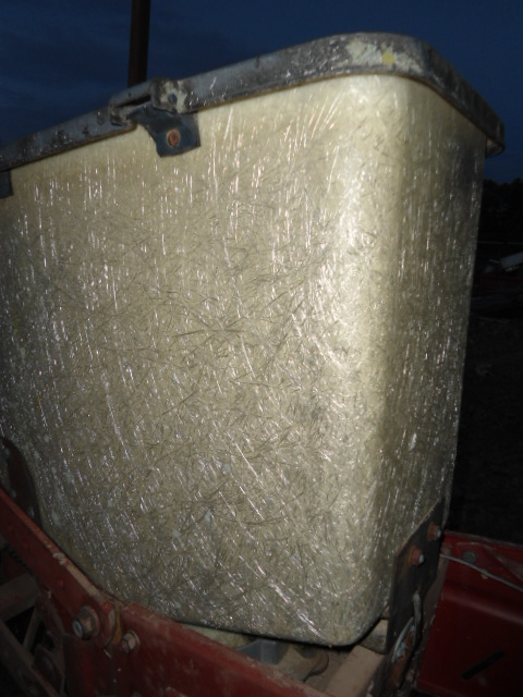

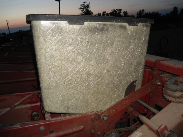

I finished planting corn today. The planter boxes are made of some type of lightweight fiberglass. They are getting older and have lost their outer hard covering. I think it was some sort of coating/paint. It has not peeled or flaked off, it is more like it just has faded away from sun exposure/age.
post-6658-0-11941600-1336876363_thumb.jp
My sons are the head seed sack toters around here and I want to smooth these up so they have an easier job. If you rub up against them the way they are, for the rest of the day you have the "itchies".
What can I paint or coat these with?

what about putting another layer of the resin over it (just leave the fiber glass out)? I dont know if it will work but the theory seems sound.
You can do that but it will be cracking out and peeling in about a year. You are looking to encapsulate the exposed glass fibers.
There are a couple of options here:
Truck bed liner available at parts stores and commonly referred to as "Herculiner" but this is another temporary repair although it will last a couple of years.
Sprayed on truck bed liner which will be permanent but is expensive. The aforementioned liner is not very flexible once applied and most seep hoppers do flex in operation when full. "RhinoLiner", "Line-X", "Ultimate Liner", "SpeedLiner", etc. are of a polyurethane nature and do flex somewhat.
An industrial two part polyurethane based enamel available at a paint vendor.
The reason the fiberglass resin will not work is the lack of application thickness. Anything less than 1/8" applied film thickness will not withstand the flexing these items endure. Another thing most don't understand is that fiberglass resin will not bond to itself without abrasion. Even then, adhesion is marginal.
Originally the seed hoppers had a polyvinylcloride, (PVC) coating with a UV stabilizer sprayed onto them when new. Age has taken it's toll as these things are seldom kept out of sunlight when not being used. It breaks down the coating revealing the understructure as seen in the photo. Sweaty skin is a magnet for exposed glass fibers; hence the "itchies".
A couple gallons of house paint would work also but won't hold up too long.

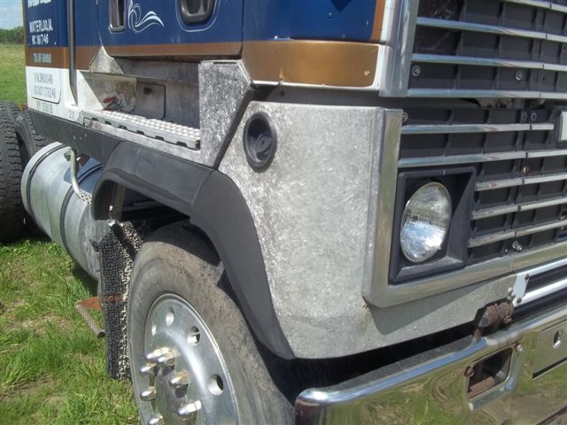

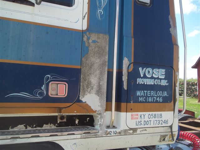

I posted pics of this MH awhile back,looks like I'm getting it now.It's doing the same thing in spots.The guy that I'm getting it from sanded a small spot with his DA and it smoothed up nice,but I didn't know if that was the right way to prep it before painting.post-61-0-19184900-1336920705_thumb.jpgpost-61-0-65014200-1336920764_thumb.jpg

Gel coat is what you need about $50 for a gallon. Gel coat can be applied with a standard paint gun with primer nozzle (70-80 thousandths) at 40-50 psi or Preval sprayer. Make sure that the catalyzed gelcoat does not set up inside the sprayer. The sprayer needs to be cleaned with acetone before the gel coat gels. The gel time is typically 17 to 20 minutes. Gel coat can be also applied with a brush or a roller.
My father in-law owns a marina/repair and I have help in the past while visting. Not real hard to put on.
Robert
"I reject your reality and substitute my own."
Worked part time at a boat shop for about 15 years where we did a lot of fiberglass repair. You could gel coat them, but it's pretty hard to get a decent finish on something that big without the proper gear. Gel coat is applied to the mold before the glass is laid up, so the wet glass bonds to the gel coat, not the other way around.
One thought I had was to check into the "heat shrink" product that sign makers use to "wrap" a vehicle. It should be sun durable and would encapsulate the glass fibers.
Have you looked on-line for suggestions? A while back one of the TV shows about boating, ShipShape TV, featured a re-build of an older Sea Bird boat where the host used a roll on product to replace the gel coat. I cannot remember the product, but I'm sure a shop that specializes in fiberglass supplies could steer you in the right direction. You might even ask at West Marine if there is a store near you.
