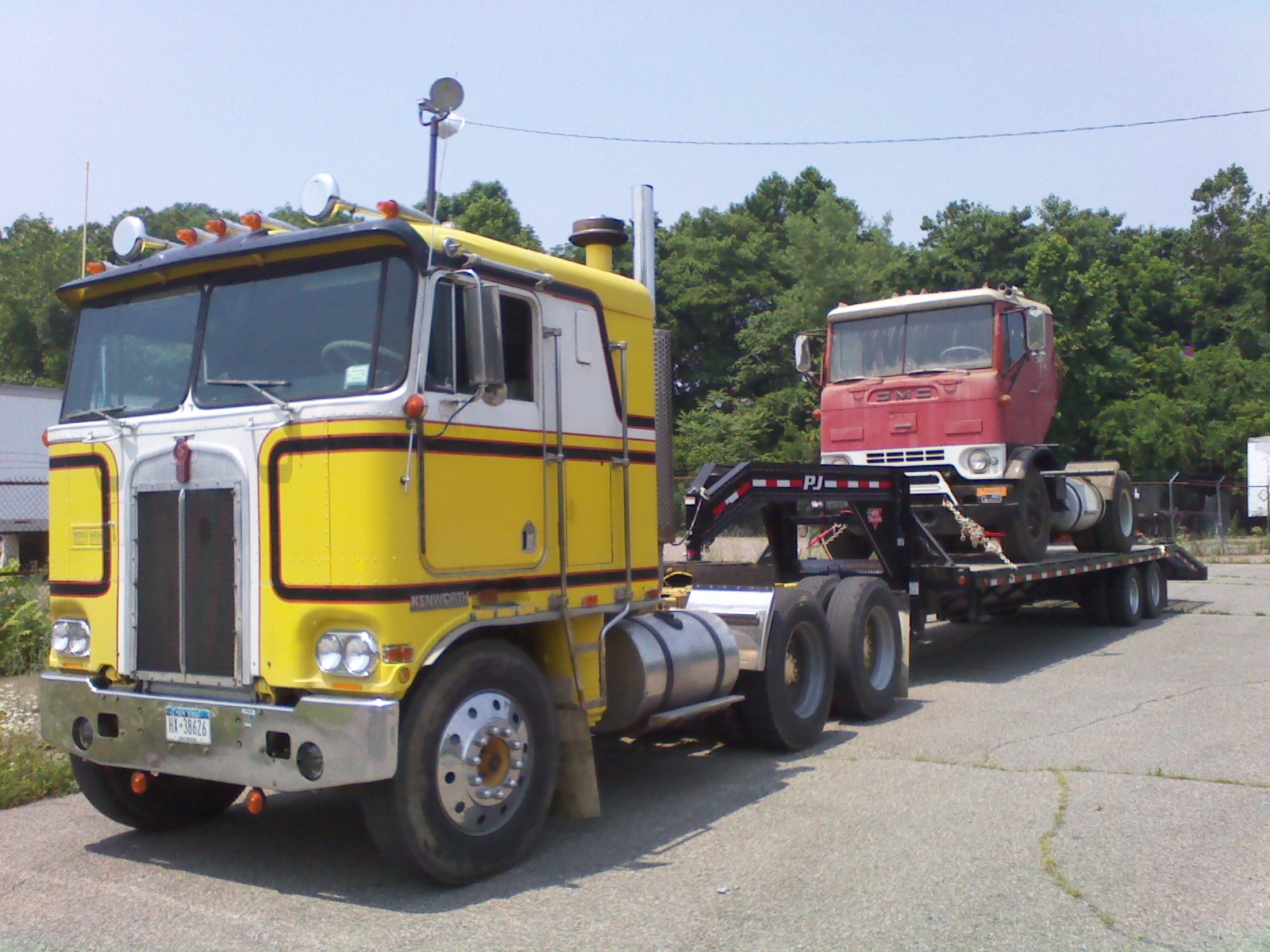

"Hunting" is common with cold 6-71's.
It is a fairly easy adjustment to control that "roll". Many just don't do it until there is problems with the overhead injection system. It is very common but not in a maintained unit.

Injectors? Not all cylinders working? I can tell its a detroit because you can here it from 10 miles away, and it sounds like it kind of "hunts" in the beggining. (I can also tell because there is always something wrong with them) :banana::clock_logo:

That is a proper running Detroit. Great engine that turns oil and fuel into noise, smoke and oil stains....oh and horse power, almost for that. They liked to hunt like that when cold or when they needed adjustment, hunted at idle.

You know, now that I've watched it a couple of times, I think it was missig a little bit. Sounded like a 6-71 missing on one cylinder (5-71) Glad it runs better now.

It was misfiring on a cylinder. I thought others knew that. It was being overfueled to the point it could not burn the mixture with the supplied air. If the emergency shutoff door was tripped closed, and the engine continued to run, there is something wrong with the door sealing cause that shouldn't happen. Detroit two strokers may smoke, but that was excessive.
