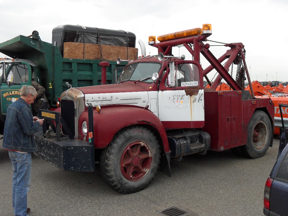

This was in a parade in Staten Island. It is a N.Y / N.J Transite Authority Tunnel Wrecker. Couldn't get near enough to find any info on these other than it's a Century wrecker body and it's on a 96 or 98 inch wheel base. Anybody know about these? Paul

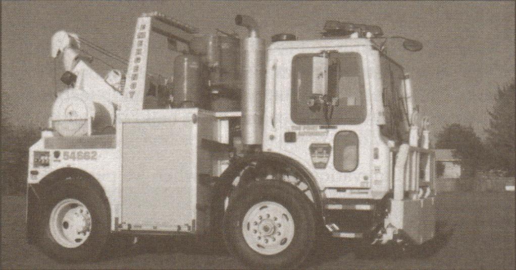

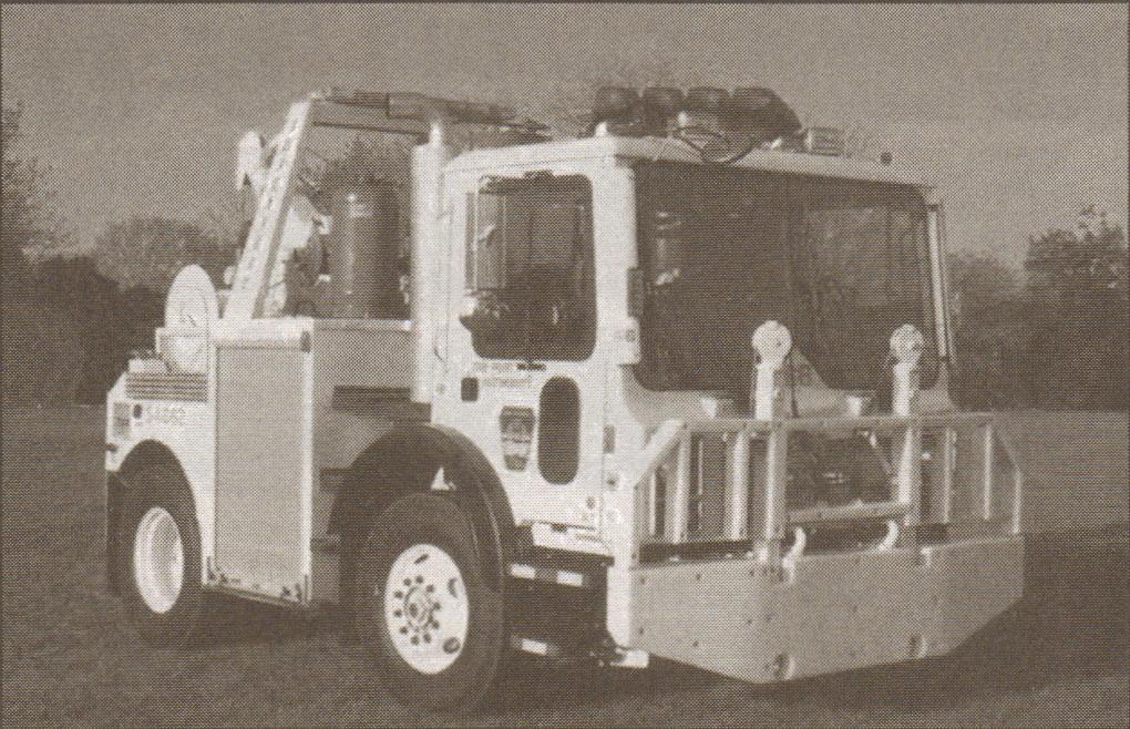

Weld built body company (wyandanch L.I.N.Y) has built a lot of these for the PATH (post authority NJ/NY) made compact so they can be operated in really confined spaces tunnels,bridges,one way streets etc. the ones weld built makes are called "tunnel sentrys' and can be ordered with many options,standard equipment consists of a 98" wheelbase, 40,000lb retractable boom,80,000lb tow rating. in the 70's 3 of the first ones built went to the baltimore harbor tunnel authority,at a cost of $133,000 each! NY/NJ were so impresssed they ordered 20! these were all mack powered,with an allison automatic trans.for ease of operation/mobility really unique trucks! made to be able to turn around in a single 11'wide lane if neeeded,the white one like in your pictures are driven by specially trained police/firemen....the yellow and red ones are civillian drivers.....hope that sheds a little light on the subject!..........Mark WWW.weldbuilt.com for more info

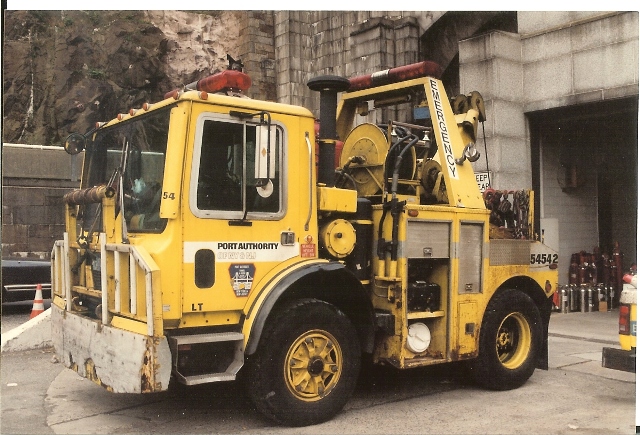

Firefighting capabilities were varied, most of these units had a nitrogen charge-powered 150 pound dry chemcial system which was either monoammonium phosphate (ABC powder) or Potassium Bicarbinate (Purple-K.) Some trucks had small water tanks (100 gallons) powered by compressed air from the on-board system. The dry chemical units were more effective though, as they could store a larger "punch" of agent on board the small vehicle rather than an equal amount of water which would have needed a bigger space.
A previous poster also mentioned having an on-board breathing system which is also true. Car/Truck fires in the tunnels got rather nasty, so the driver did have the option of donning a SCOTT mask, and hooking into the on-board system, and then hooking into a self-contained unit when he got off the truck (to hook up chains, etc.)
Here is a pic of one I took at the Holland Tunnel, I want to say 15 years ago or more.

Is that a winch cable set up on the front push bumper?
