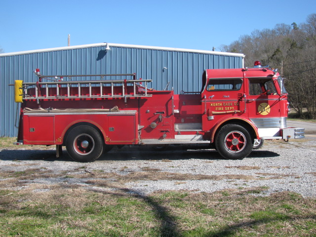

I bought a retired Mack C series with the EN707 Thermodyne gasoline powered engine (5 speed manual tranny). It had not been run in a couple of years other than very short distances. When I was ready to put it in the shop and have Mack give it an inspection and full tune-up, however, it was running very rough, wouldn't power up hills, and backfired and smoked alot.
Mack cleaned it up, cleaned the carb, replaced all the plugs, points, distributor, etc and sent me on my way several thousand dollars poorer. Til I hit the first incline and it lost power, backfired, and smoked.
Now they talk about a carb rebuild but they dont do it and suggested I talk to the local deisel shop - they are interested in doing it and can get the kit, but are suggesting it is a timing issue and that that should be addressed first after speaking to a New York collector who has worked on these. Question - I am assuming this is going to be a major repair as the engine is tucked forward against the cab - hours = $$$ and I am waiting for an estimate. I have no idea how far to go with these repairs. Is a rebuild a better idea? (I've read not). Is a replacement engine a possibility or would that cost be way too high?
I'm stuck as I'm not a mechanic, and the boys at the fire hall while good intentioned, had no idea the engine developed such bad performance while in storage when I offered to buy it and make it roadworthy again.
Would especially appreciate if anyone has any references I might be able to follow for others who have done this or who have access to parts. Will be needing a replacement windshield, need to find a pair of electric booster reels (originals were stripped off and used to create two brush units - a 4x4 and one atop a mini-tanker), and would love to find a full set of original aluminum marker lights as these have been replaced one at a time by cheap looking plastic ones from the local truckstop.

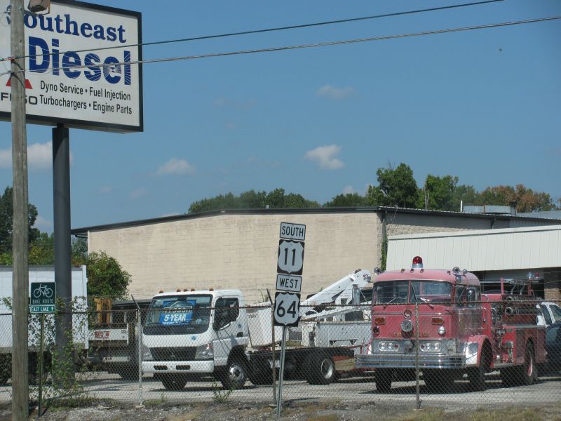

I posted a request last month seeking someone who may know someone here in the SE (I'm in Chattanooga) who has knowlege and experience, and access to parts to help with the old Mack, but have had no replies - this is the letter I got from SE Diesel outlining the problems - they did full tests and found the engine in ok shape in regards to the carb, plugs, and timing, but found issue with compression in cylinder #6. They say they can do the repair using machined parts, but that any inexact fittings could lead to catostrophic failure of the engine and they would rather not do the repair unless the factory parts can be located. They have searched for months now, phone calls, emails, and linking to other shops but have had no luck. The Mack still sits, paint fading, on their lot. Many suggest an engine swap, but I cant afford or rationalize a $10,000 fix to a $4000 rig.
From SE Diesel : Hello Bruce,
The valves are not seating in the head.
Problem could be valve, valve insert, or
piston burnt in valve, or a number of other
possible problems that caused the valve not to seat.
By the valve not seating the engine cannot fire due to loss
of compression.
We have called our Suppliers and have not found the parts needed.
No valves, valve inserts or head gasket.
We put the valve cover back on engine and have pulled out of the shop.
There is the possibility of removing the head and after measuring the valves
and inserts if they are needed we can match them to get something that will work.
But that will still leave us with the possibility f not getting a head set.
If you have any availability for the head gasket set, head gasket,
valves, valve guides, valve inserts, valve keepers and other components
needed to remove head, rebuild and install head.

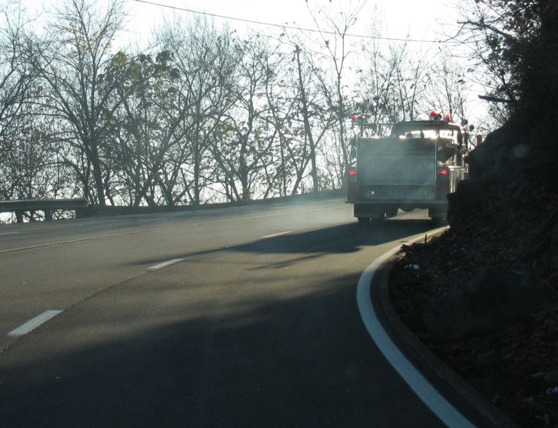

Generally a bad valve or one that does not full seat will show up as a miss at idle or a roughness. Looking at the photo of your smoke, Grey color is generaly excessive fuel or an incomplete burn. Has anyone checked to see if the choke is full opening when warm? Is the choke pull off working? The Carb float could have one of 2 problems. A miss adjusted float (too high) or a bad float needle will cause that color smoke by dumping fuel. Another thing to check is the ignition coil out put. The do break down over time and it may not be suppling the needed output under load. The will cause a miss fire because needed voltage at the plug(s) is not trhere. Also the vacuum advance could be not working as suggested. Paul

As to the smoke, the pic can be deceiving, it is blue, not gray (just the strong sunrise coming over the ridge).

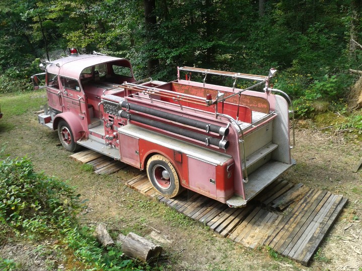

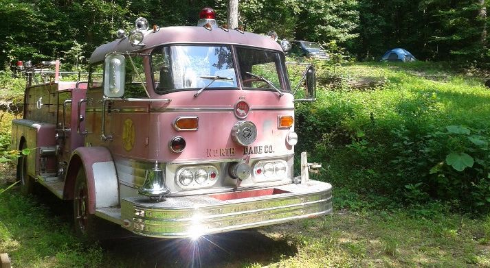

  • It's been a while so I am again visiting a couple of websites to update info on the Mack which basically is unchanged. While I moved it to Wildwood to my property two years ago (a Trenton, GA tow company allowed me to park it at their yard for a year), and made of point of at least firing the old girl up and idling the engine for a half hour or so per week, it one day inexplicably failed to start and I never got it running again. Has new batteries but given my forest location, this could be an electrical wire or fuel line chewed thru by hungry rodents (who have feasted as well on my minivan and pickup truck!). Anyway, no change in my financial status or ability to knuckle down and tow it off to SE Deisel to perform the engine work or ability to find a local mechanic. I finally posted the rig as for sale on SPAAMFAA last fall and made a similar announcement on my facebook page (hookerhosecompany) as well as FB pages for SPAAMFAA, Mack and C Model fans. Have had no takers at $3500 so have now decided its time to try and part it out. I am not a garage guy so am limited in my access to tools for parts, and limited in my knowlege of how to dismantle parts from the engine or pump. Anyone interested in mechanical parts would need to travel to the Mack and treat it as a 'you pull it" agreement. I have interested parties for emblems which I have been unable to remove do to the weld method used and difficult access. Also have people interested in the bumper, hand rail on the front of the hose bed, window glass, steering wheel... The Hookerhosecompany FB page has a photo folder of Mack Parts to show the condition of items such as the pitted chrome hand rails and gear rack, the air horns, lights, diamondplate, pump panel, mirrors, windshield, seats, etc. I also have the accessory items such as hoses, adapters, nozzles, extinguishers, vintage SCBA, aluminum ladder, wooden 10' pick pole, hard sleeve suction hoses and the strainer. https://www.facebook.com/media/set/?set=a.678332655518449.1073741825.382116005140117&type=3

bruceb:
That outcome is certainly a shame; it's a beautiful truck but you have to do what you have to do. I operated a 1959 Mack "C" model ladder truck back in the day
so I have an affinity for all "C" models. Our ladder truck also ended up in the big Mack graveyard years ago. You gave it a shot, plus all the money and
aggravation, so good luck with parting it out.
