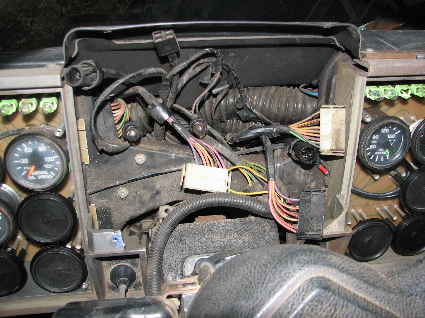

  1. I am not aware of any 30 pin connectors behind the left head light. The dash connectors definitely have the ground circuit on the pins. You get erratic lights or indications when the ground is completed through another connector. Do your MHs have the connectors behind the tach and speedo like the picture of mine above?

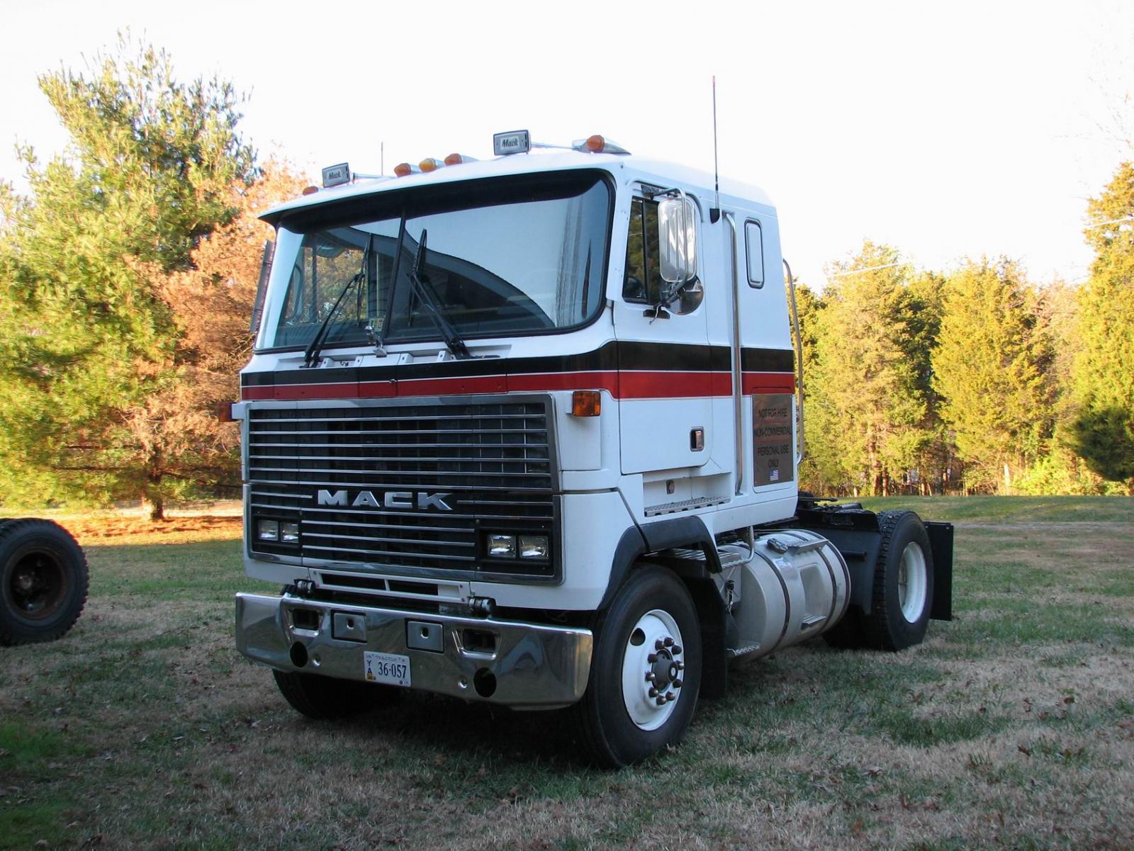

  3. I was hoping you would come back and see my post before you spent too much time elsewhere. The last 4 digits of my VIN is 4881, what is yours? Are your indicators working ok now?
  4. My 1989 MH was doing the same strange things as yours when I drove it home after sitting for about 10 years. Take the center section of the dash out-where the tach and speedo are located. Buy some contact cleaner and clean the male and female connectors and your problem will probably be solved-mine was. I think I used Q Tips in some hard to reach areas on the connectors. My toughest problem was getting the cables off the tach and speedo. You will not have much room to pull them out but the cables will come off the back of them.

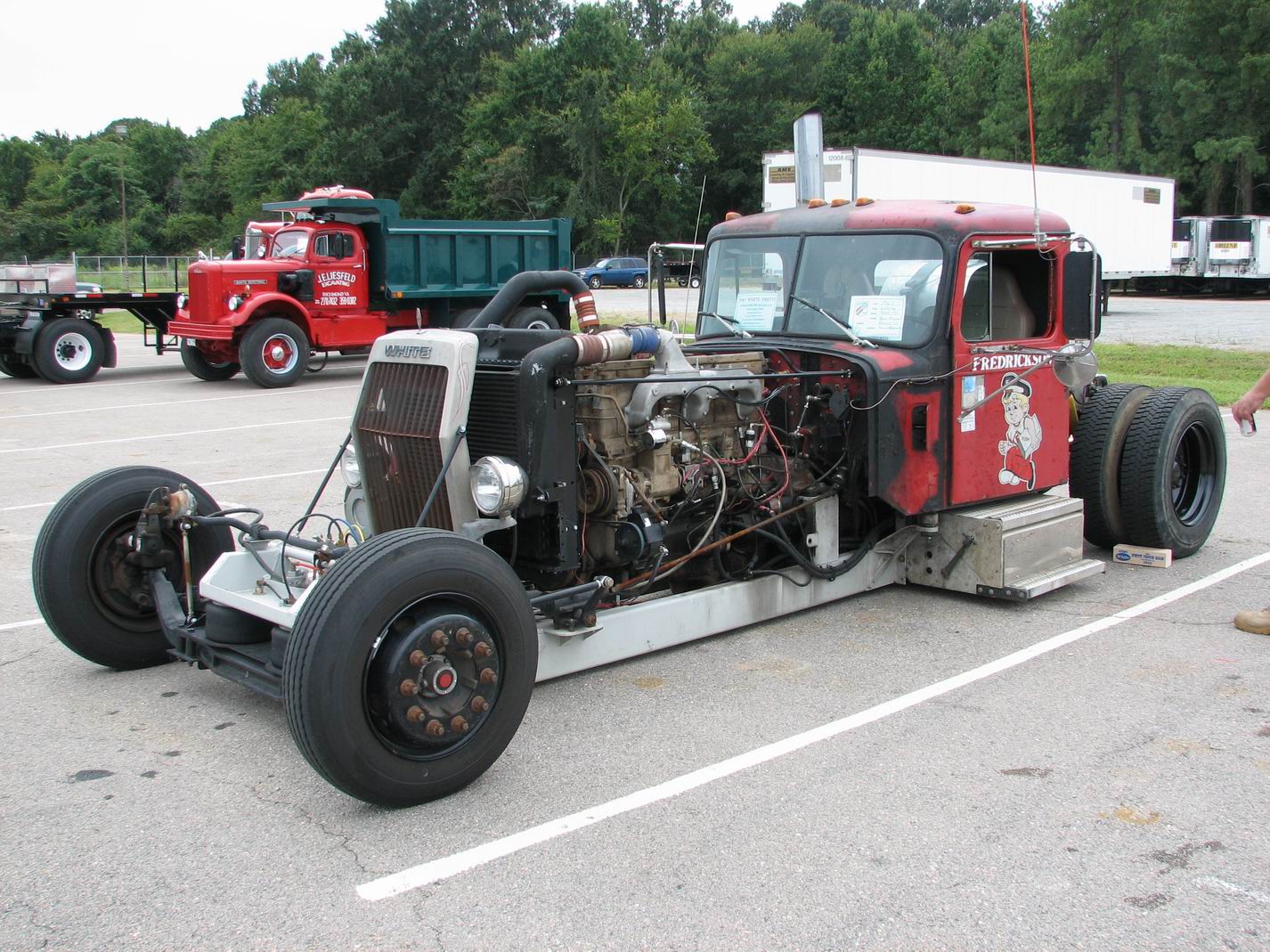

  9. This one from NC was at the White Bash in Richmond last fall. He had to put samller tires on it to slow it down but he said it cruised good at 80 MPH. That is a White farm tractor grill. I forget what cab he used but I think it was a 4000. The air bags are down in this picture but it did not have much clearance when they were up.

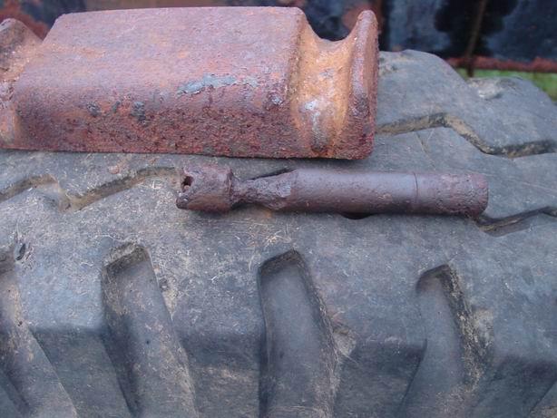

  12. I have removed the springs on my 1954WC22 White and my rear pin was the same as yours. I think on mine that pin normally had no weight on it-only when the overload springs came down on it. It also was hidden by a rubber bushing. I found the rubber bushings at 2 different spring shops. EDIT: I rechecked my springs and it had no weight on the pin because the truck has no weight on it. I don't think it has an overlaod on it???
