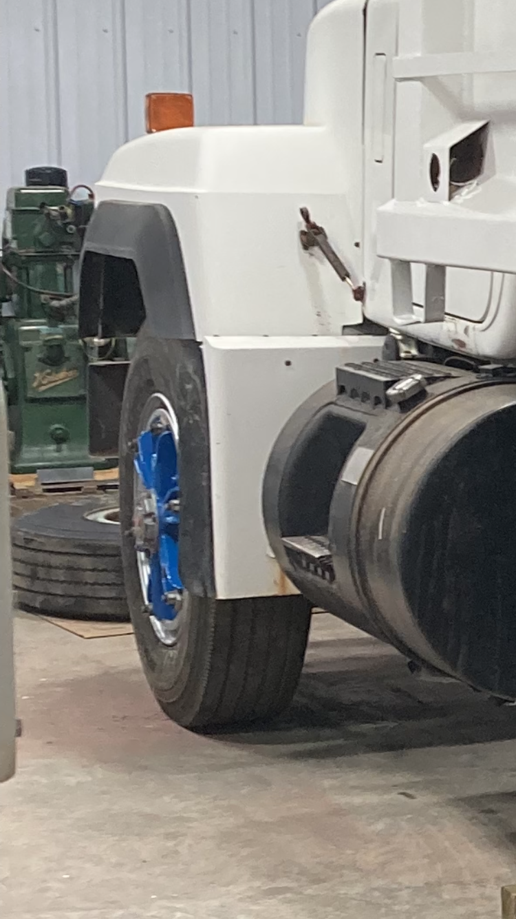

5th wheel sits too high need help
67RModel replied to T_Redjoey's topic in Modern Mack Truck General Discussion
Looks like you should purchase some new tires too. Those two at the 5&6 position look pretty thin. -

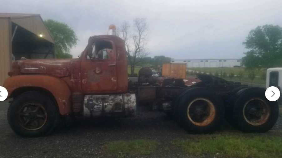

just for you geoff weeks
67RModel replied to mowerman's topic in Antique and Classic Mack Trucks General Discussion
From the picture it looks like the wheel seal is leaking pretty bad. -
