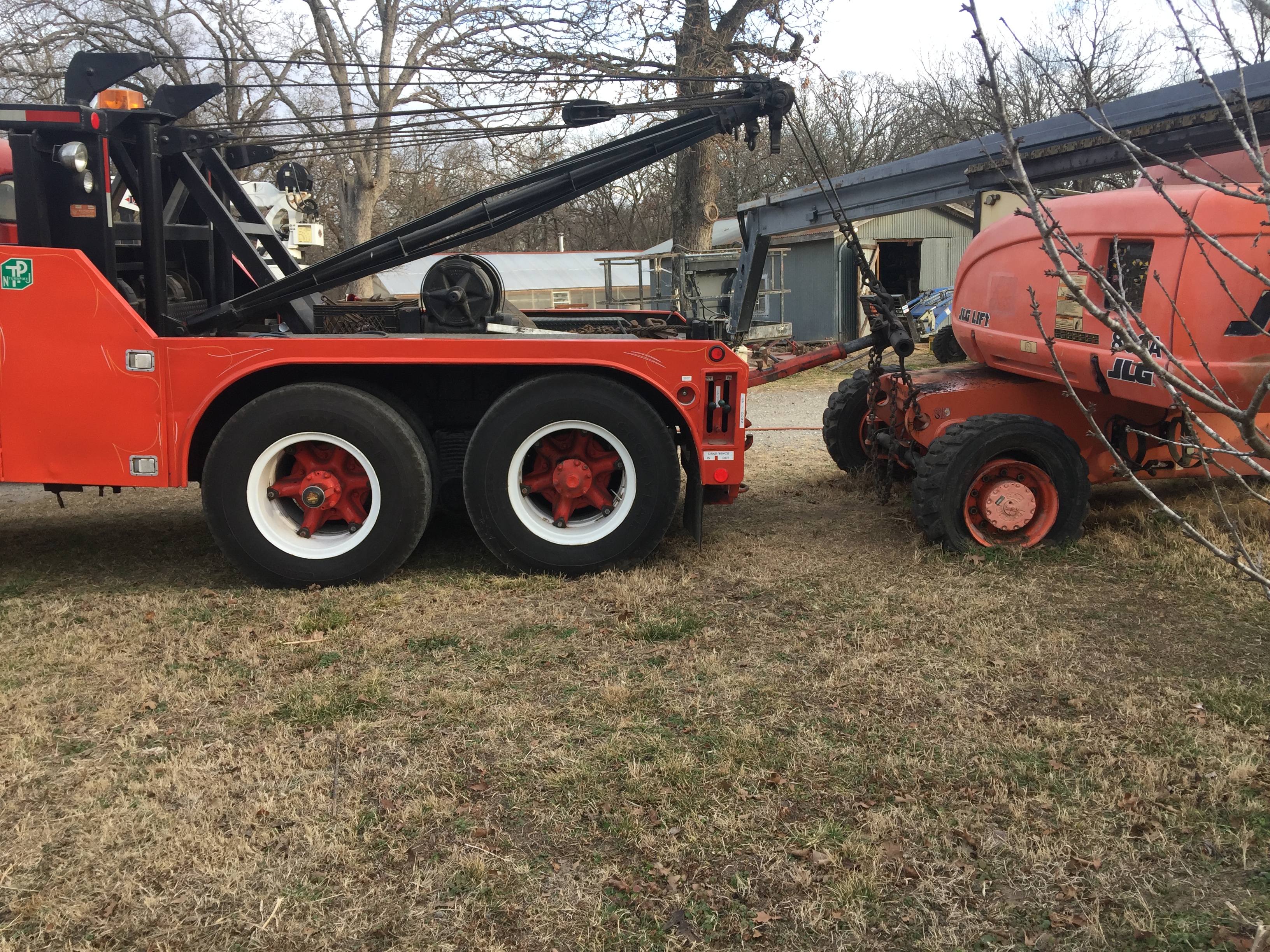

You folks know the truck- It's picking a boom lift to change out some tires.--------------------Tocci Truck Shop
