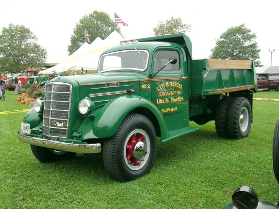

  9. Here's another picture of an "E", maybe an "EH". This truck started out much worse than the one you have. Check your email Dave
