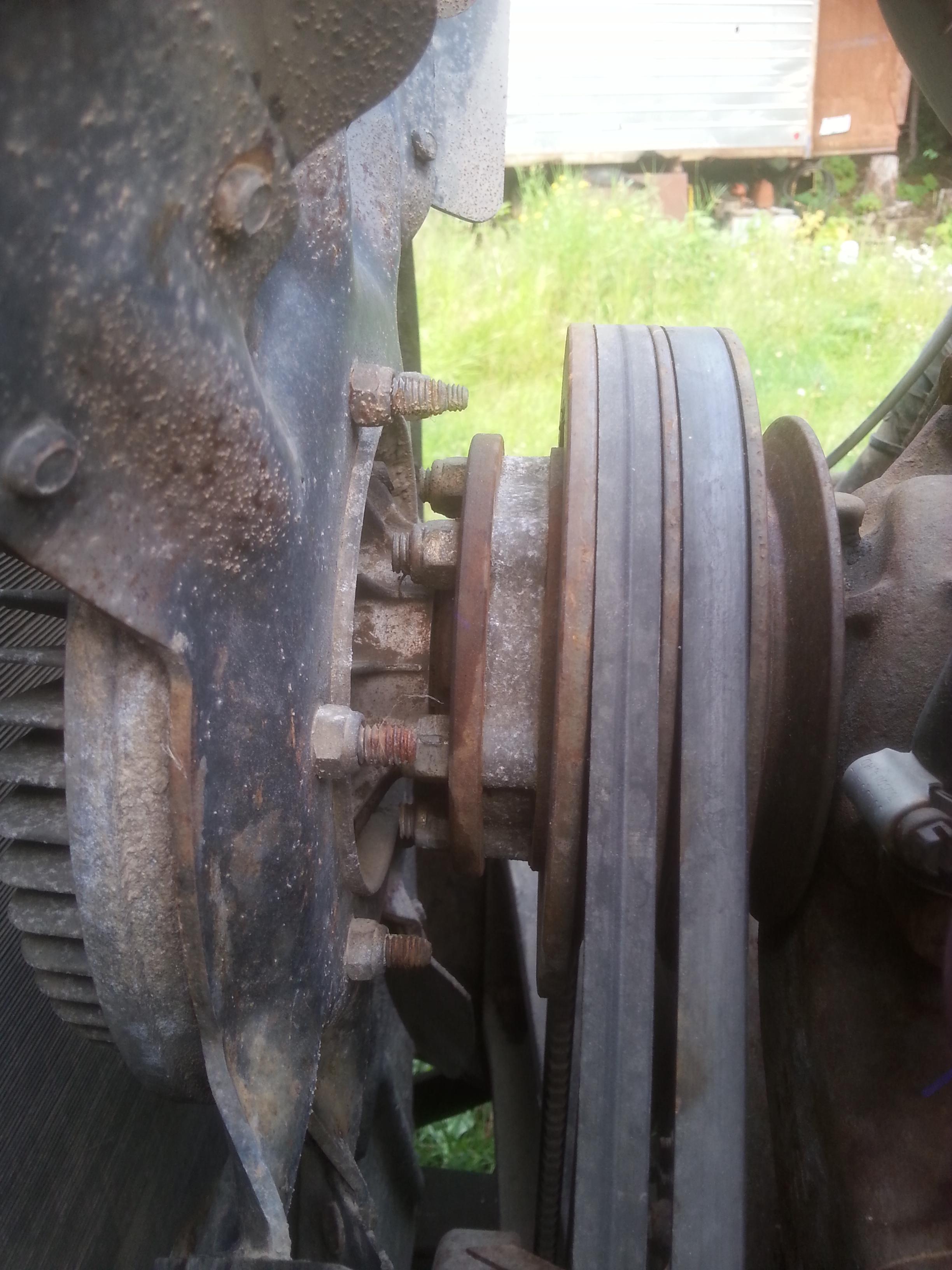

  17. Is this the style we're talking about? JoeH, if so....how does one adjust it?
