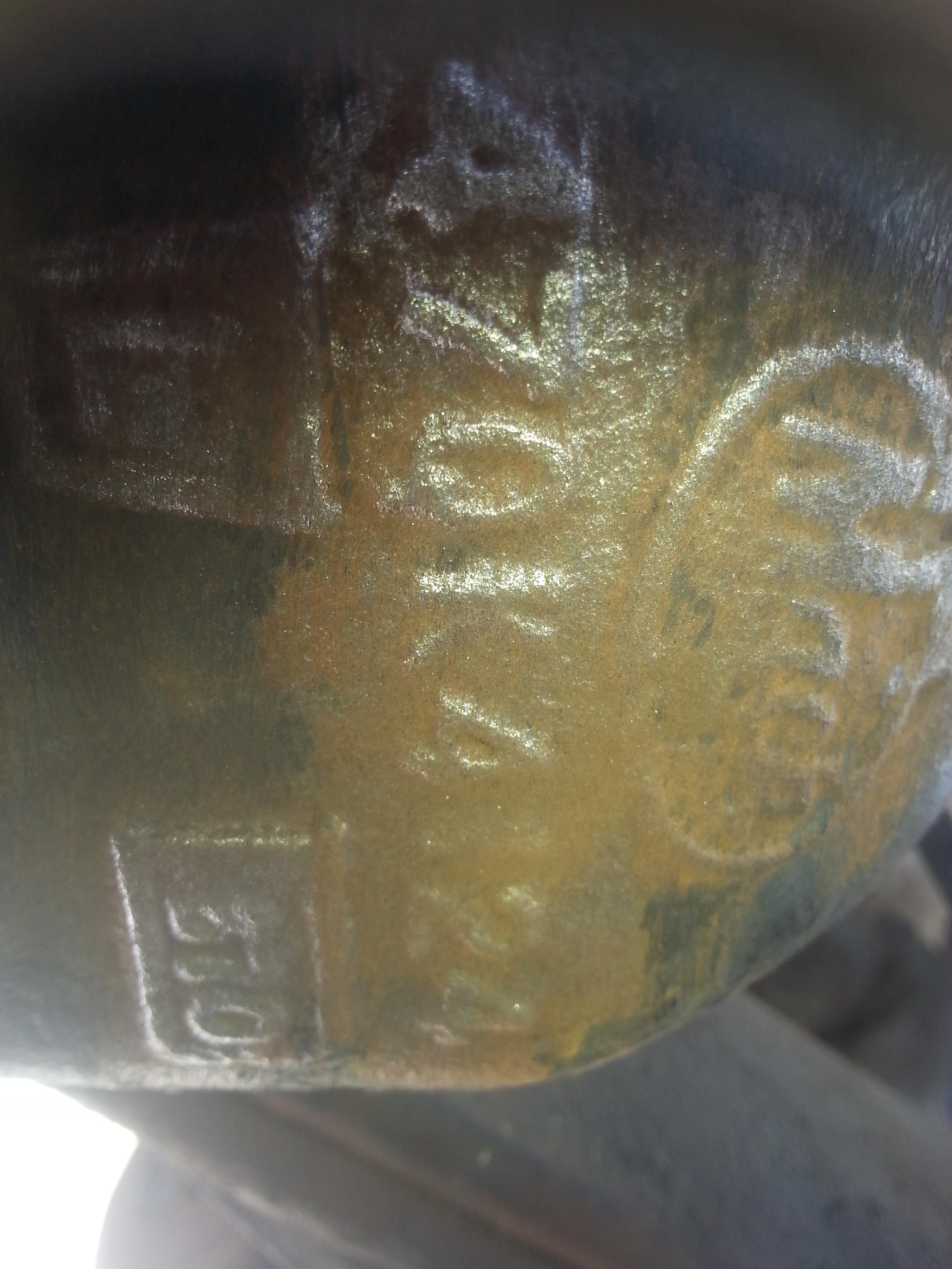

  1. Or even better yet, does anyone have a part #?

  5. Ah, I was trying to capture that part number. Anyways, I found pins and bushings at Pacific Spring, here in BC canada. They are on their way.
