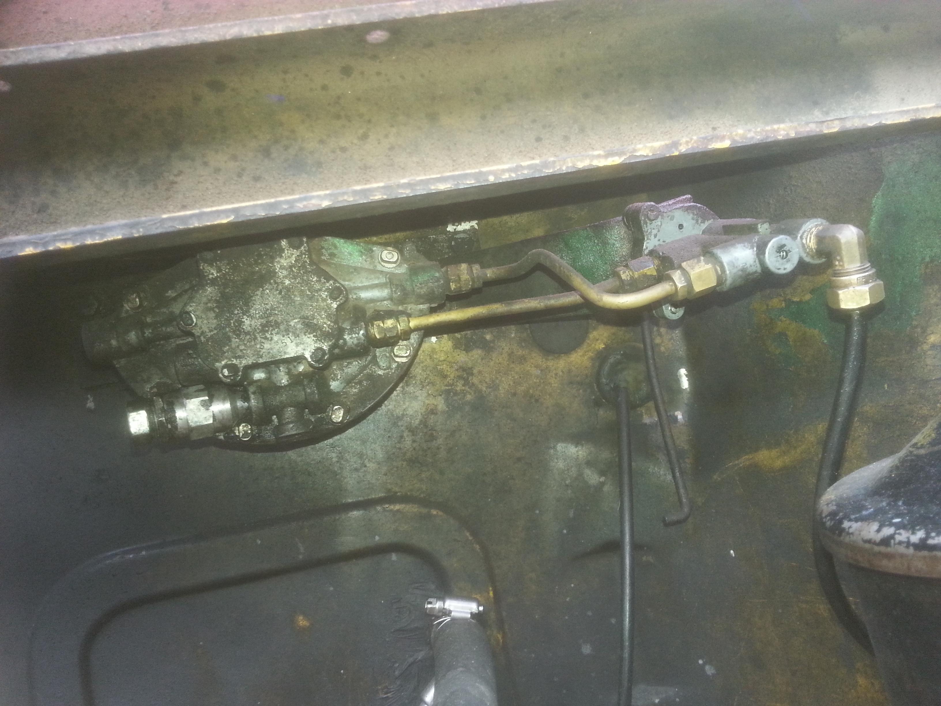

  13. Old topic, but a common issue. I just had an Ambac pump rebuilt solely due to worn gov springs/surging at low rpm/low throttle input. A rack "buffer" kit was installed in conjunction with whatever else they did to the governor. Solved the surging problem completely. I have 3 others with the same problem, and will eventually get all 3 of them done also when funds permit. Should be good for another 40-50 years now.
