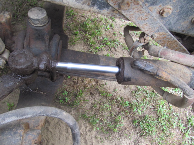

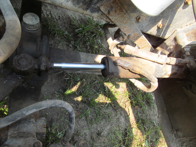

  10. What is the proper terminology for this steering ram? Its on the passenger side of my RS600l. There is play in both ends, the end that resembles a tie rod end has no grease fitting and is wore right out. It threads onto the ram and hopefully its available separately. There is also play in the other end where the cylinder attaches to the frame.
