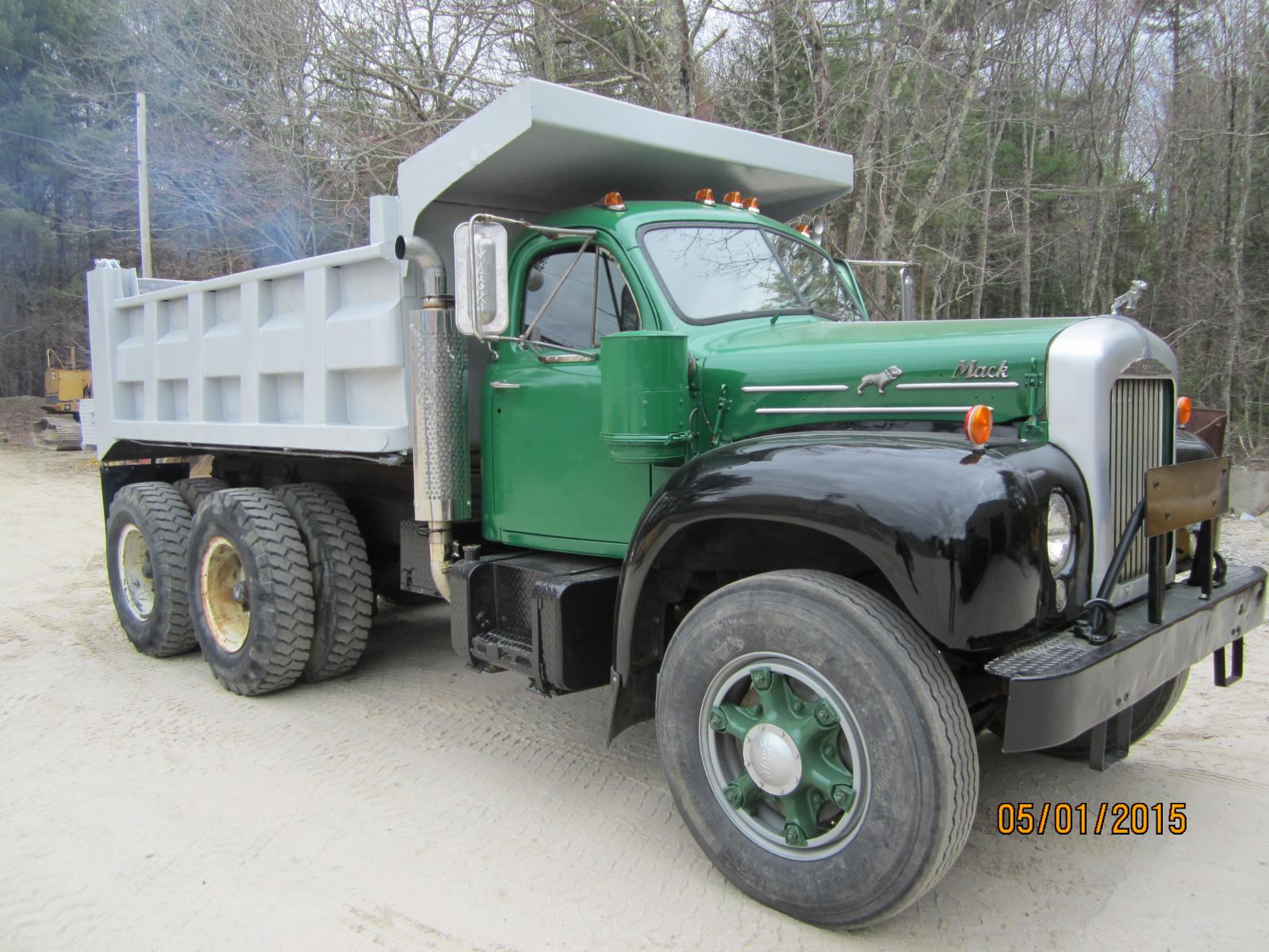

  5. Again, many thanks to DBLEW for selling 'Mater to me and my family. I've thoroughly enjoyed this project...and am glad it's almost over.
  6. Always was a fan of the R model. Nice truck. You did a good job with it.
  7. I present to you the ballistic missile submari...err...'Mater. https://www.youtube.com/watch?v=IlSa2ErtExI&feature=youtu.be There were 133 days between the first photo on day one until today.

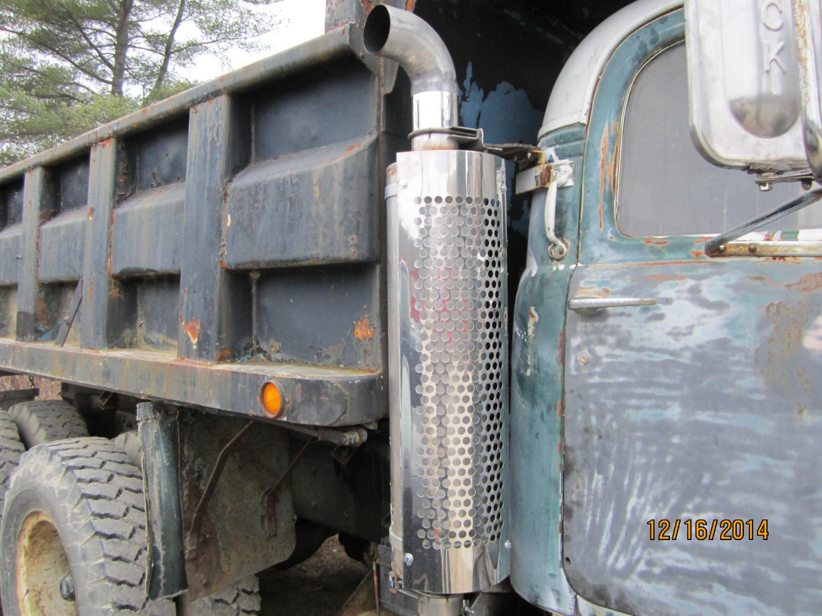

  8. Ask and ye shall receive. Here are some pics, one of the body before sandblasting, one after sandblasting, and a few after paint.
  9. OK gents, I just got in 30 minutes ago, and after a looooong day of moving the body, setting it up, sandblasting, moving it and setting it up inside to paint, welding some patches in, fixing a few more things, it's now finished. Painted. Sorry, no pics. I forgot to snap a couple when I was done. Perhaps I can post a few tomorrow. BTW, we might put the body back on the truck tomorrow, too.
  10. Did more work on the dump body today. Torched a few things off it, did more welding and grinding. Plan is to sandblast and paint tomorrow.
  11. Started work on the dump body today. The chute door was caked solid with asphalt, but now it's all free and working properly. I did a bunch of grinding and welding on it, too. It certainly looks better, but I've got another morning's worth of torching, pounding, and welding left to do before sandblasting it. If all goes well, I'd like to get it painted this week.
  12. I tallied up all the hours put into 'Mater so far: Me: 400 My uncle: 100 My dad: 40
