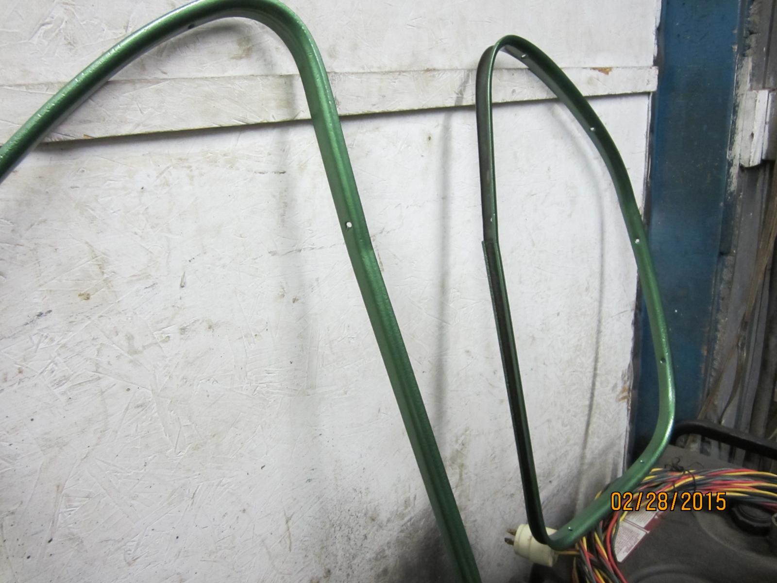

  1. NAPA has a green metallic paint that is virtually a perfect match for the Mack interior paint. I just applied it to my door rings today.

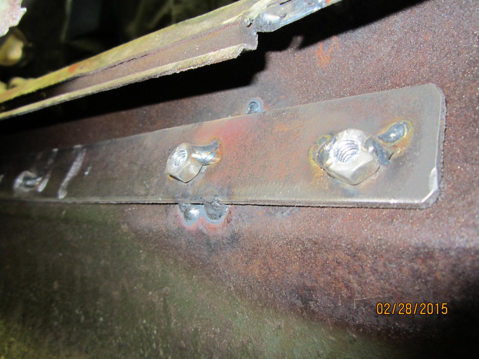

  2. Today's progress: 1. Picked up both the exterior and interior green at NAPA. Exterior green is now slightly too dark, while the interior metallic green they mixed up in a spray can is dead nuts perfect. It's literally a perfect match, and in a rattle can to boot! 2. Lightly sanded the door/window rings and painted them with the rattle can interior paint. To say I'm happy with it is an understatement. It's so good, I'll be sanding/stripping down the rest of the door interiors and spraying them, too. 3. I also took pics of the side mirror mounting hardware/flat stock I made for inside the door. You can see the welded nuts that the stainless steel bolts will screw into, fastening the mirror brackets to the doors. Looking ahead, now that I have the interior green that matches the original, I'll be doing the rest of the door interiors this week. We'll also be starting on prepping the cab for paint, too.

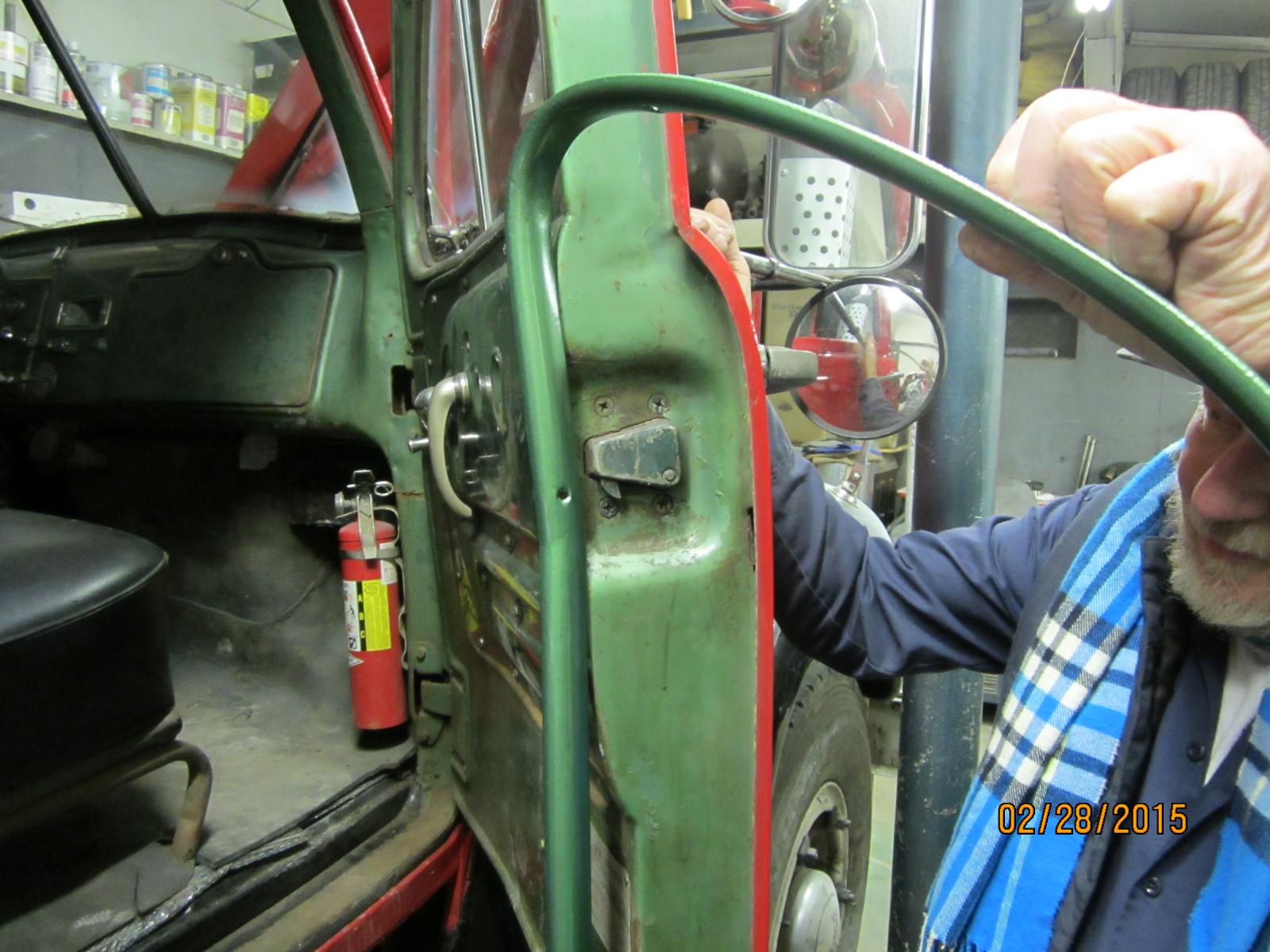

  3. That's my uncle's '58 B65LT. I'm working in his garage more than my own because of the snow and cold (my garage is heated with wood only, his has a furnace). You can see a thread about the B65 in the introduction forum.

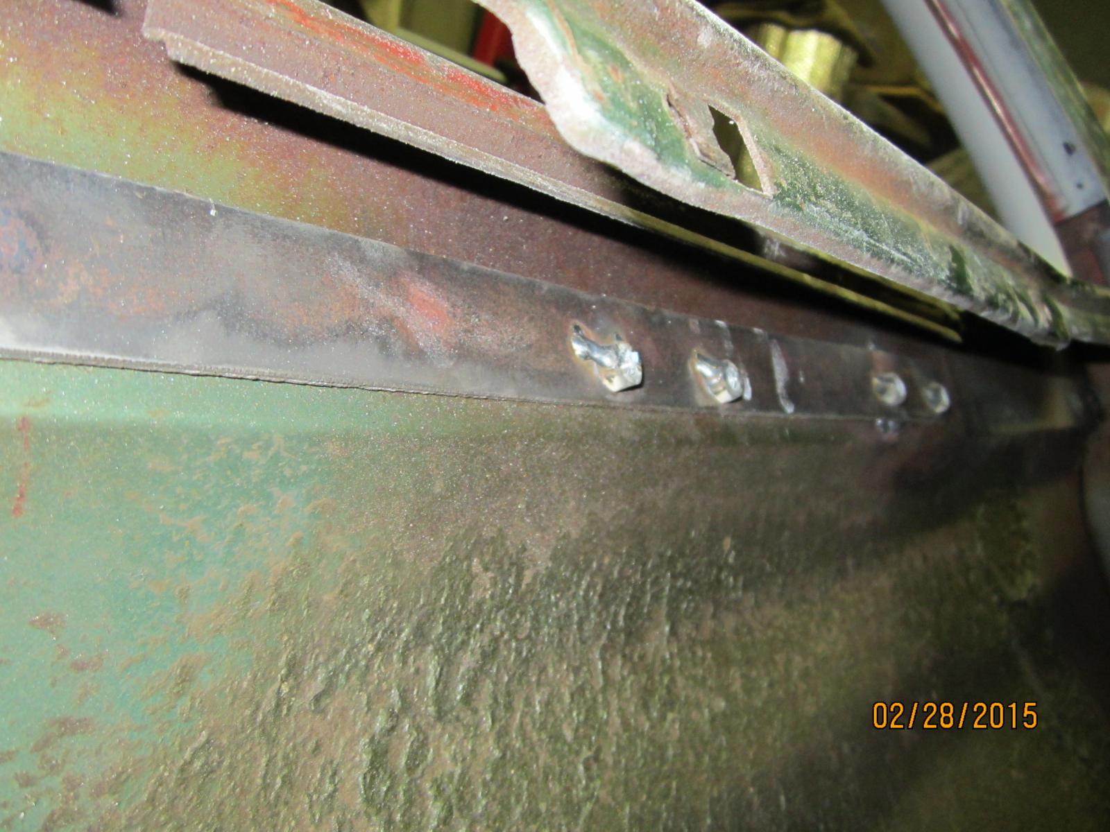

  5. OK, finally have an update for y'all. Today we finished all the fixing, welding, and filling on the doors, then we primed them. Except for a light sanding and one more coat of primer, they are ready for paint. I also picked up the new windshields and door glass yesterday, so they are ready to be installed, too. Next week we will be tackling the cab, fixing any holes (very few) and then we'll be ready to paint that as well. I stopped by NAPA this week to try and get a slightly darker green for the cab and hood, and also am having them mix up a rattle can for the metallic green interior for touch-up work on the doors and what not. Lastly, these doors were pretty rough in areas, especially where the mirrors were attached. There were holes everywhere, and plenty of dents and rot. We fixed all that, and I made a new way to bolt the mirror brackets on the door by taking a piece of flat stock about 16" long and 1 1/4" wide, and welded nuts to it where the bolts would go through the door. We welded the bar to the door via the extra holes that were there and now I've got a permanent, strong method to bolt the mirrors onto the door. Didn't take pics of it, will have to do so next week and post them here.

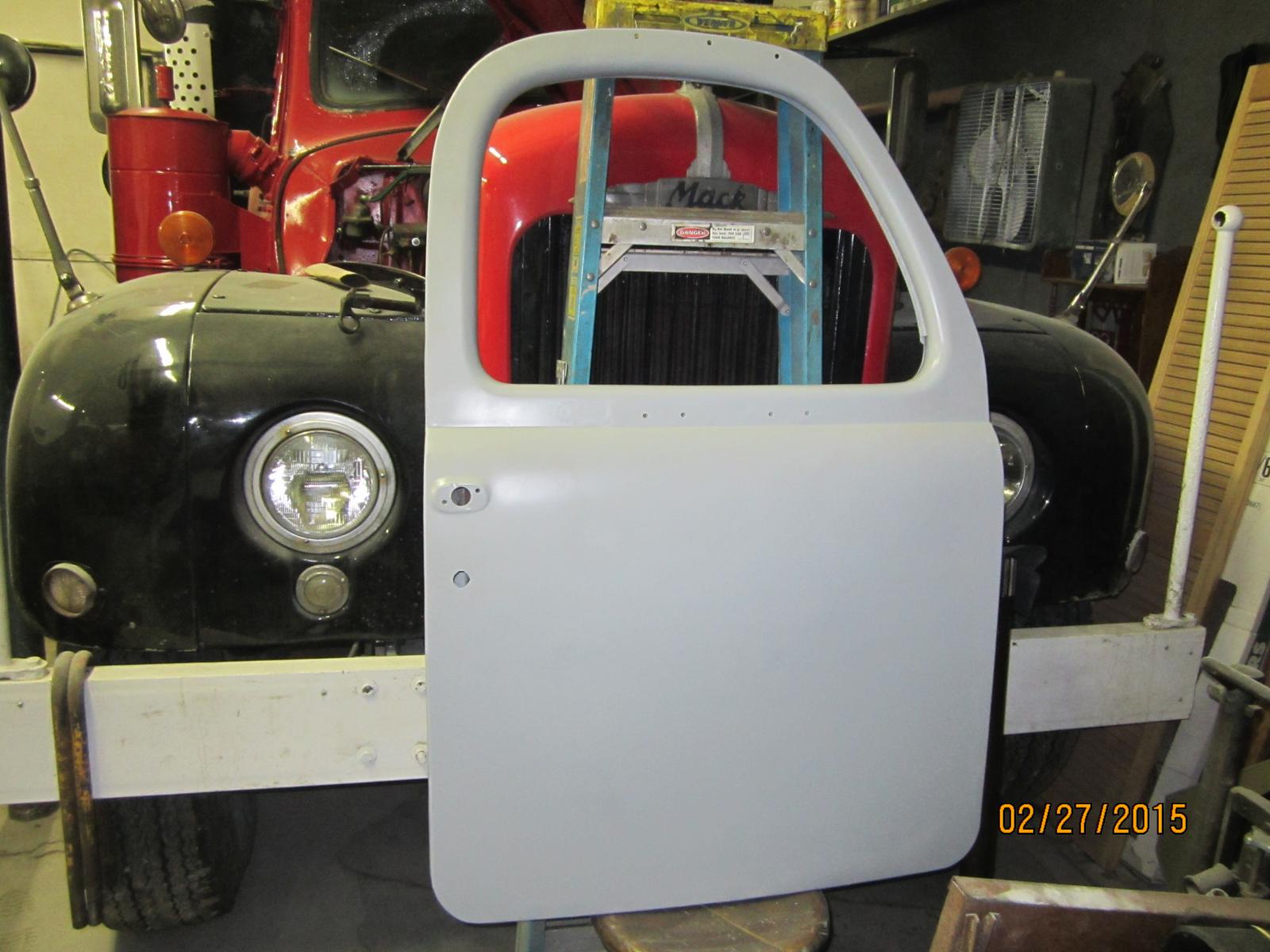

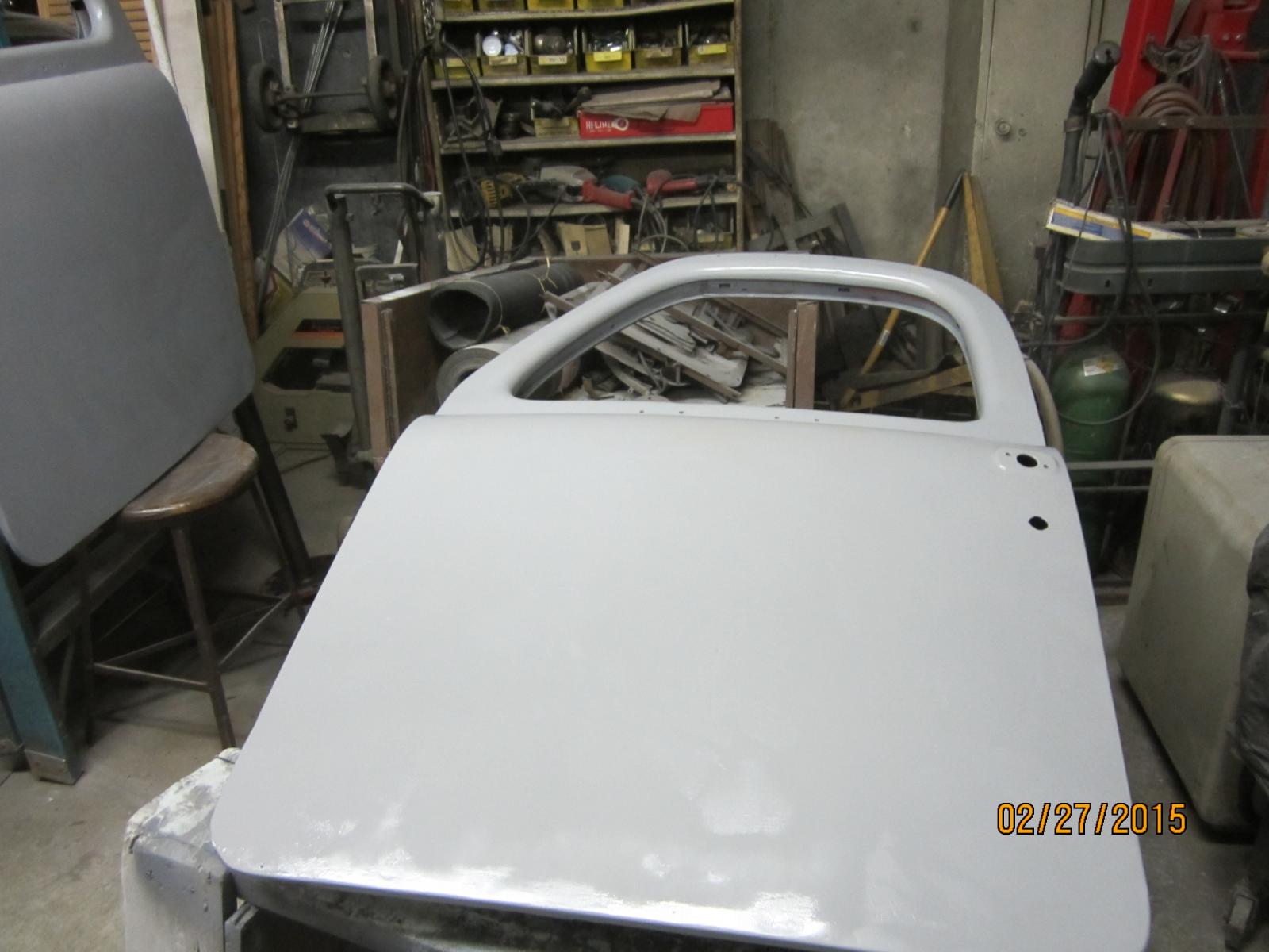

  6. OK, that's my bad. I got the transmission screwed up. It's a 10 speed. ETA: here's another one http://www.commercialtrucktrader.com/listing/1979-MACK-RL685LS-113597880 And a third one, but the body is a big grain body, so it wouldn't work very well with hauling earthen material. http://www.commercialtrucktrader.com/listing/1989-MACK-R-688-113049448 And finally there's this 1998 DM690S that looks in pretty good shape, but is more than I'd like to spend ($40k) http://www.commercialtrucktrader.com/listing/1998-MACK-DM690S-113938717

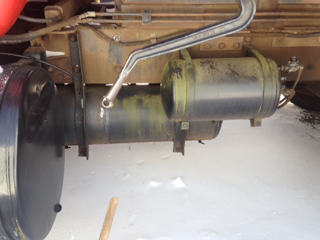

  19. My only experience with a 300 is with a tractor, not in a tri-axle (DM), how is the 300 in a dump truck application and how is the 10spd for such an application? Decent options? Good pairing? I don't know the mileage, but it's a '71. Any help is appreciated.
