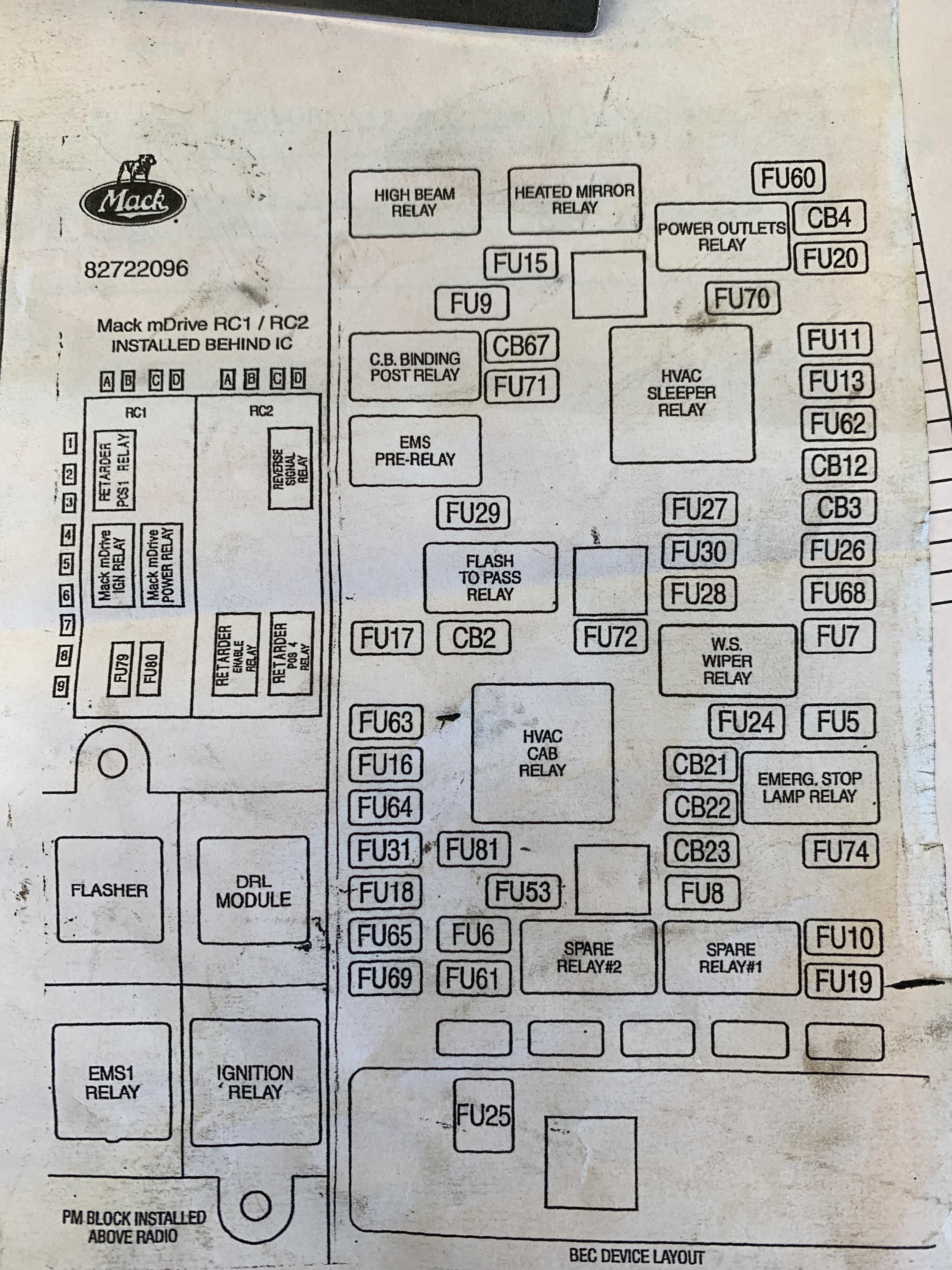

Power comes through firewall on the second connector down , pic C. This is the back of the fuse box . Then it comes through a 16 pin connector up by the foot valve/wiper motor.
