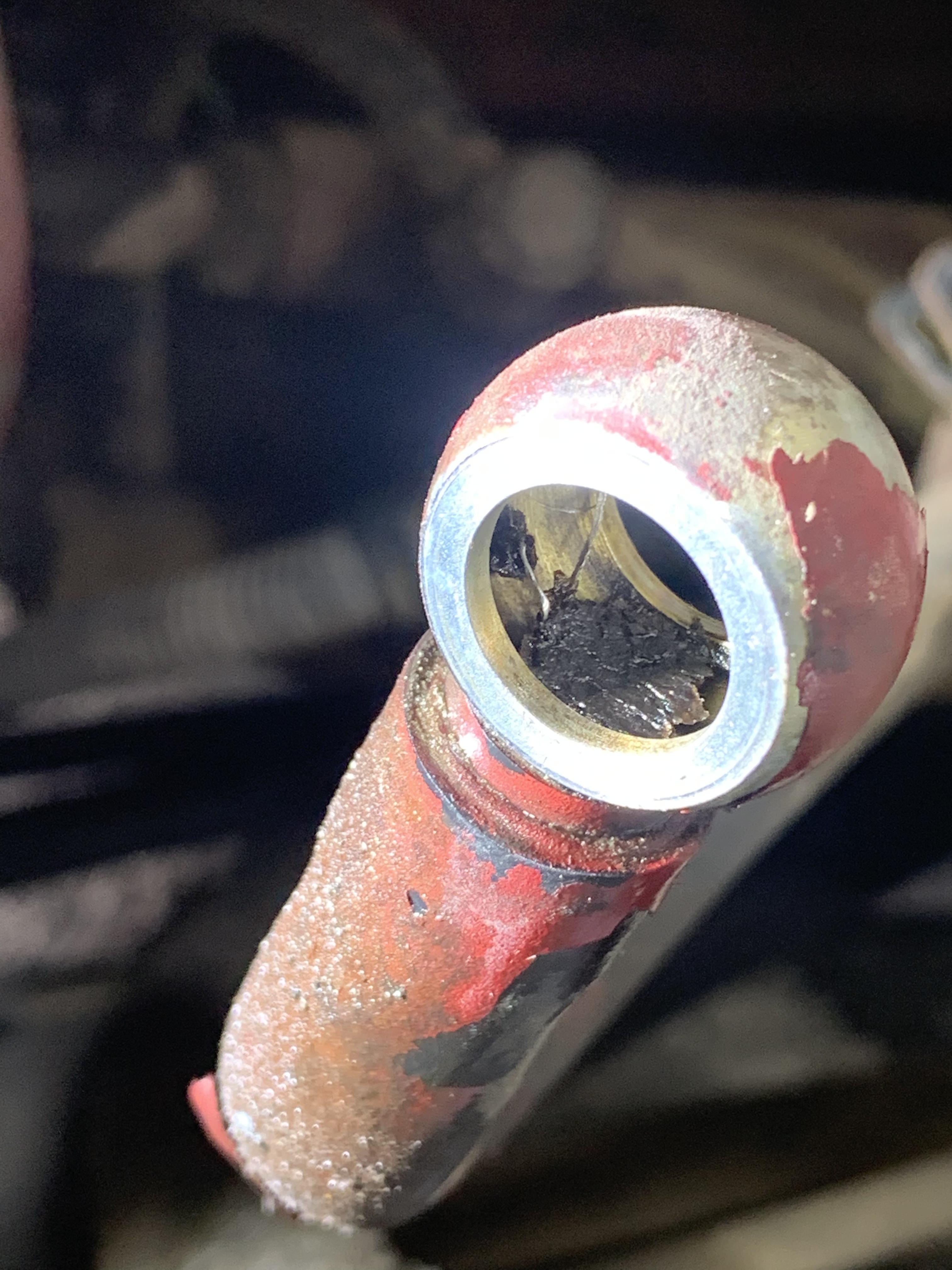

Screen clogged in the lower radiator Y pipe where it goes into the oil cooler. This restricts coolant to EGR cooler and it cracks . Then boost pressure is blown into cooling system when under high boost loads .
