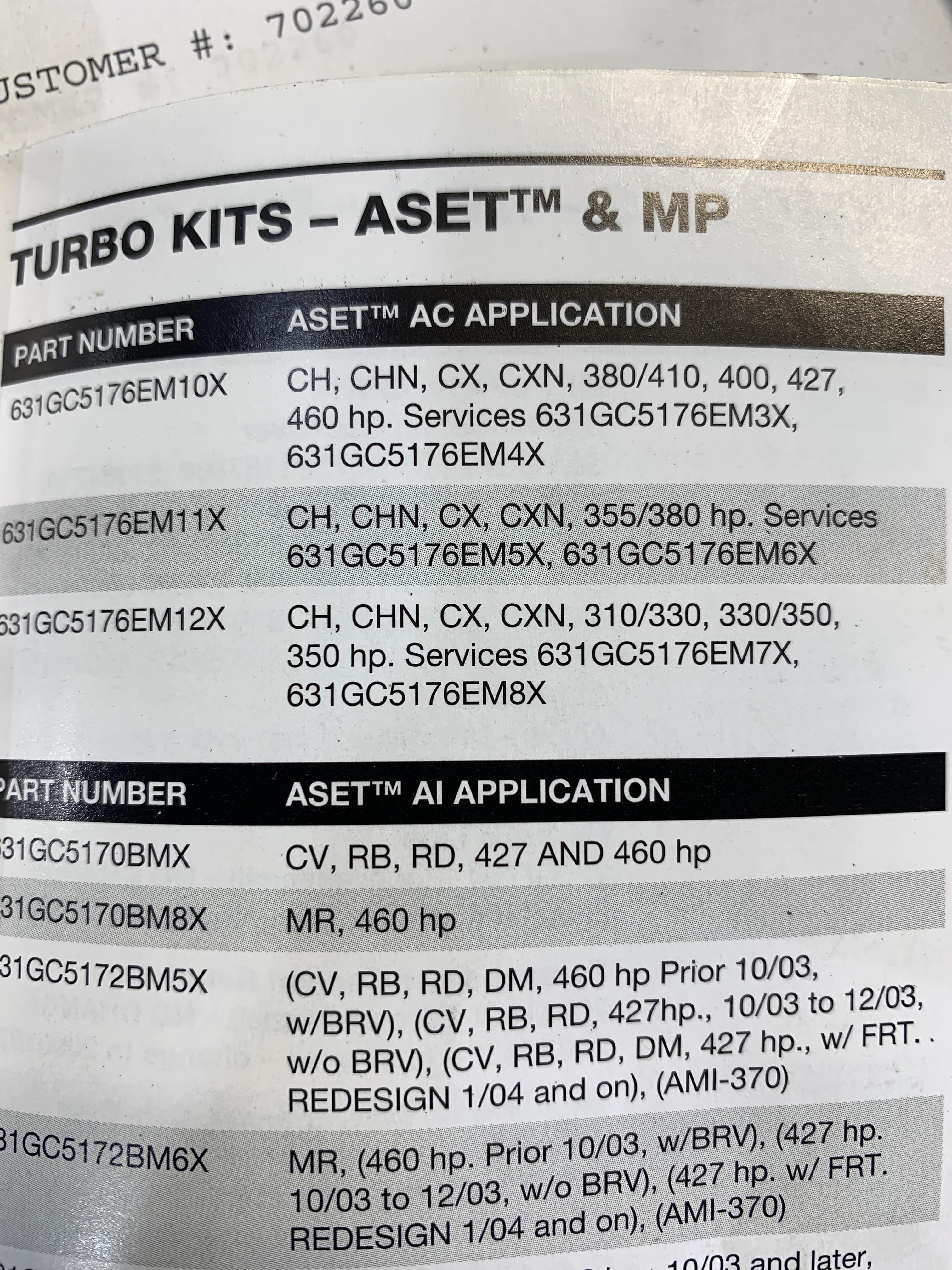

Does your 470 CCRS have a wastegated turbo? Over here in the states our 2001.5 to 2003.5 CCRS 460 had a wastegated turbo and was a royal pain to get it to run right . We detuned several to 427 and replaced the wastegate turbo with a standard 427 turbo and no issues. With the 460 CCRS program over here, the engine ecm looks at the boost pressure sensor readings at different engine load, throttle pedal and other sensor readings and there is a narrow band of what the boost pressure readings would be. If the boost is not in the correct range then the engine pulls the fuel back and usually sets a fault code. When all was correct they ran great , if not then it was about like having. 300 or 350 hp.
