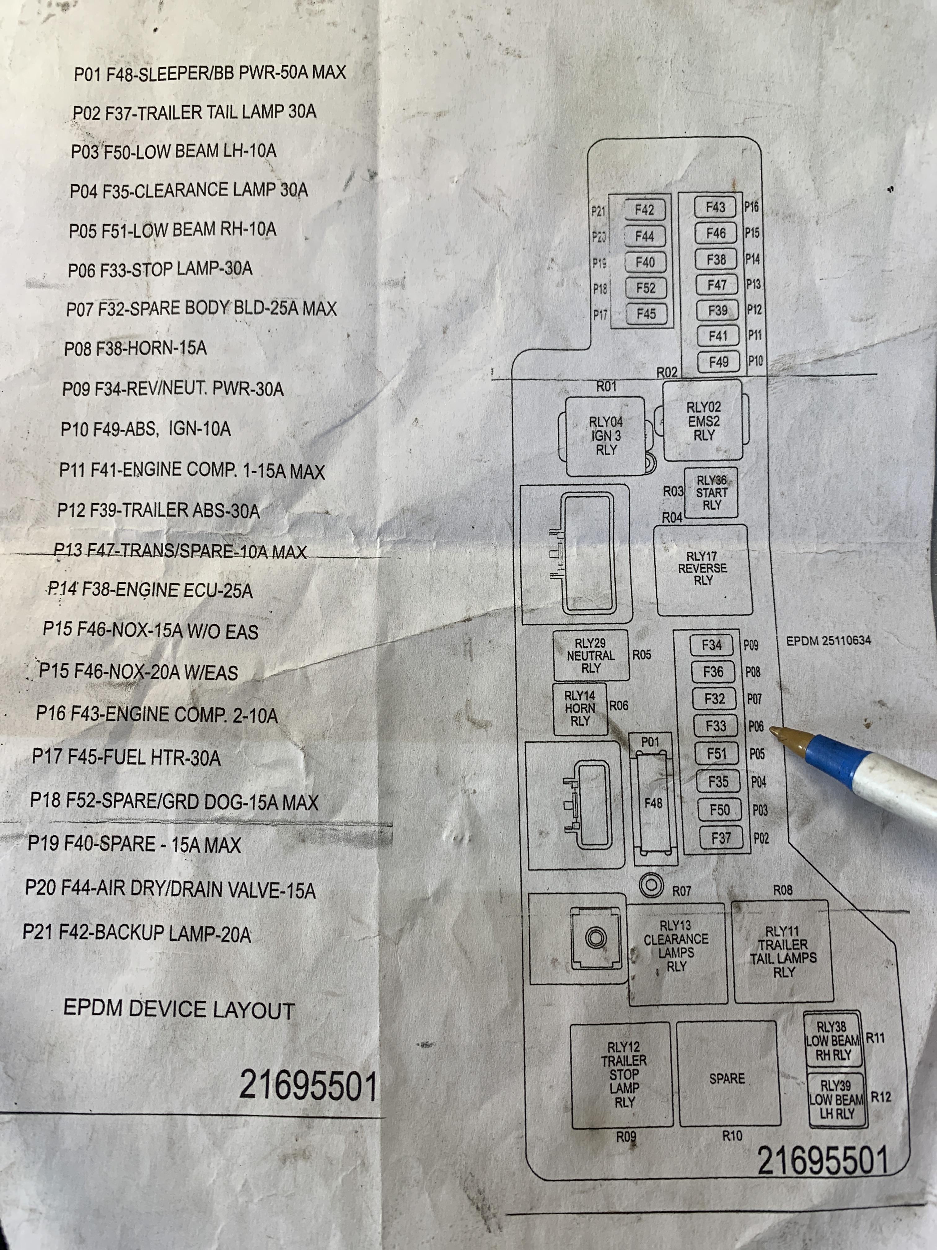

  16. In the PI,AN and GR’s (Pinnacle , Athem and new stlye Granite ) they now have the light control module LCM that controls all the lights. In the fuse box on top of the dash , check all fuses labeled LCM There could be as many as 7. These trucks now have 2 separate hood harnesses one for the right side and one fir the left. I have see a few passengers side Athem harnesses rubbing and shorting just behind the connector at the hood on the chassis side of the connector.
