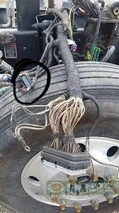

  21. There is a 12 wire connector/harness that plugs into the chassis harness under cab . This is the manual transmission harness. It’s for the speedo sensor, reverse light switch , transmission temp sensor and PTO.
