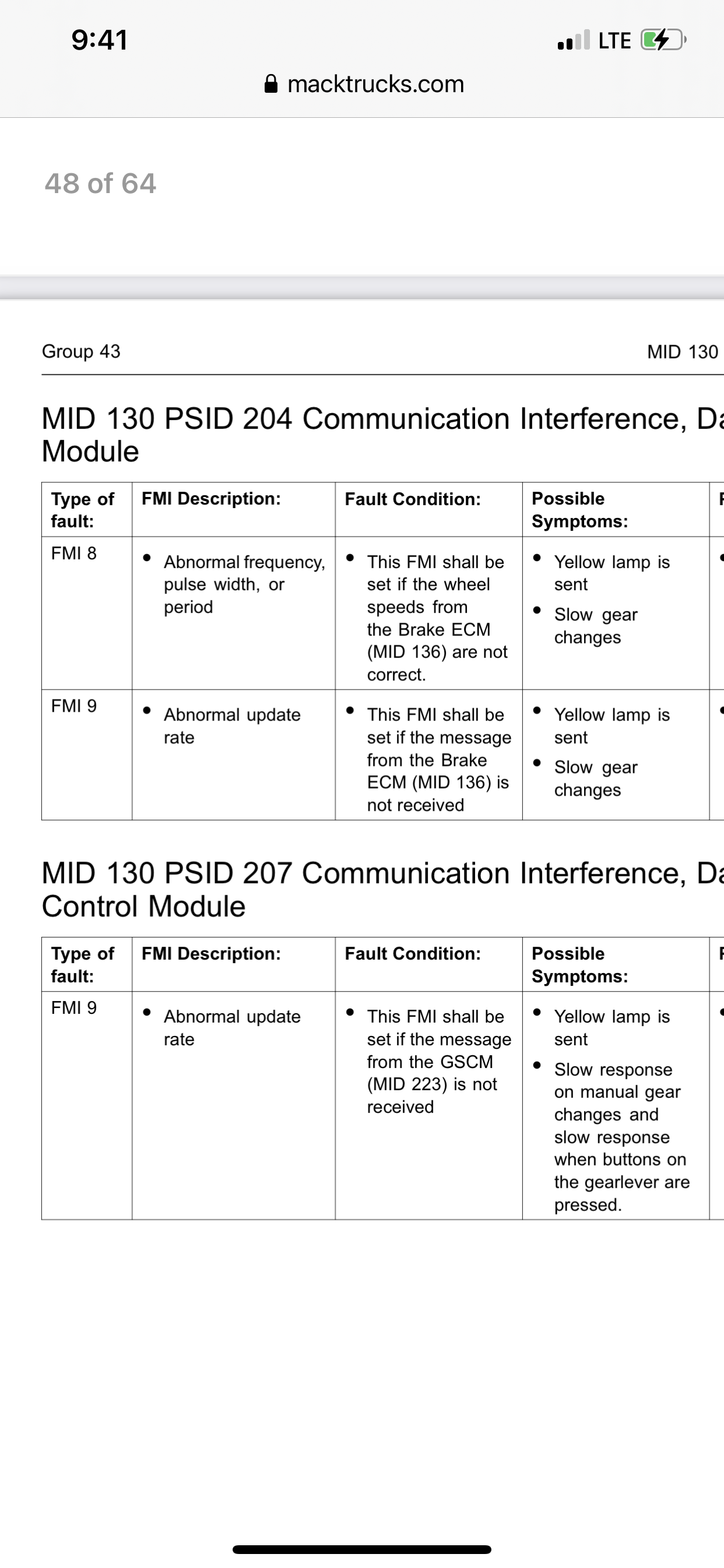

  1. Mack issued many bulletins on the fuel filter changes. I can only screenshot them due to the new format. So I can’t really get all of it in the picture.
