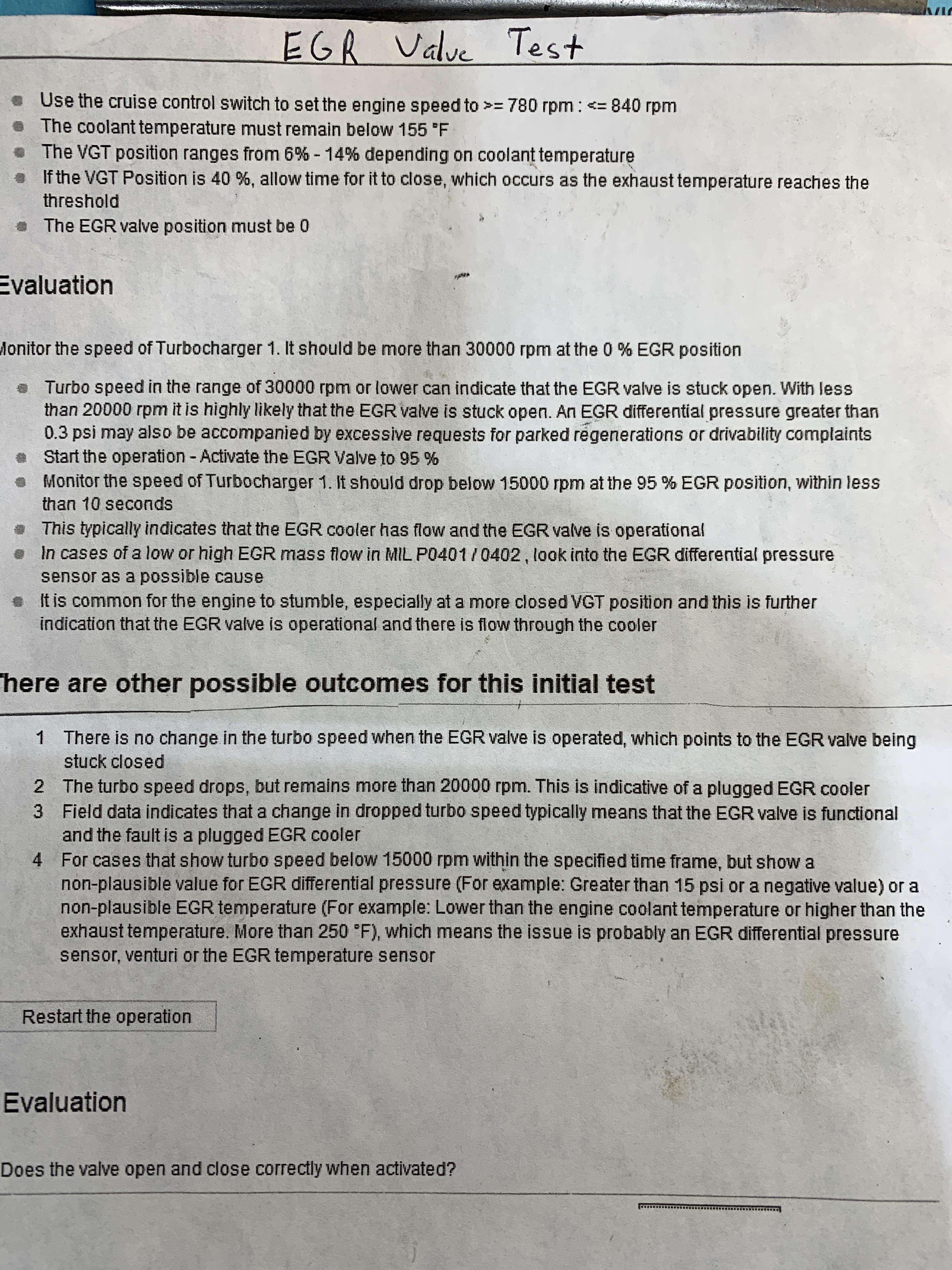

  3. I just went down this same road with a 2012 Volvo D13 last week. Started with EGR flow codes. Updated to the newest EGR differential sensor and venturie pipe. It’s a kit that comes with everything you need. After doing this the EGR codes went away but the failed EGR diff sensor caused EGR valve to stay open more than it should and caused over sooting of the DPF filter. So I started a regen and couldn’t get the center T2 DPF temp over 750. Borrowed a flow tester and 7th injector had really low flow . Started at 2 LPM ( liter per minute) flow , cleaned and re-tested and had 3 LPM . Spec is 4-8 LPM at 30psi . So replace the 7th injector ( no fun on the big ones, a super thin 7/8” wrench is a must) . Started a regen and temps slowly and I mean super slowly got to 880 after about 25 minutes. The DPF differential pressure was around .8psi and slowly dropping to about .5 psi at end of regen. Usually the regen temps shoot up pretty quickly on the T2 when the fuel starts dosing. To make it right I finally had to pull the filter and have it cleaned and went ahead and had the top part ( catalyst) cleaned too. After that the temps rose quickly and my DPF differential pressure only got to .3 psi at it’s highest.
