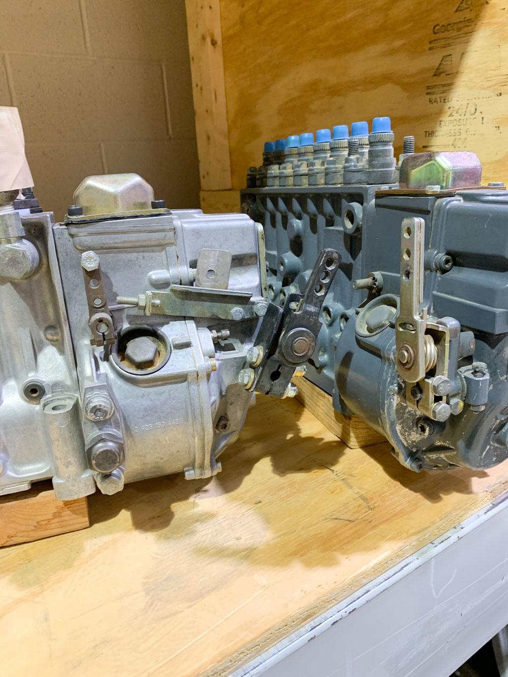

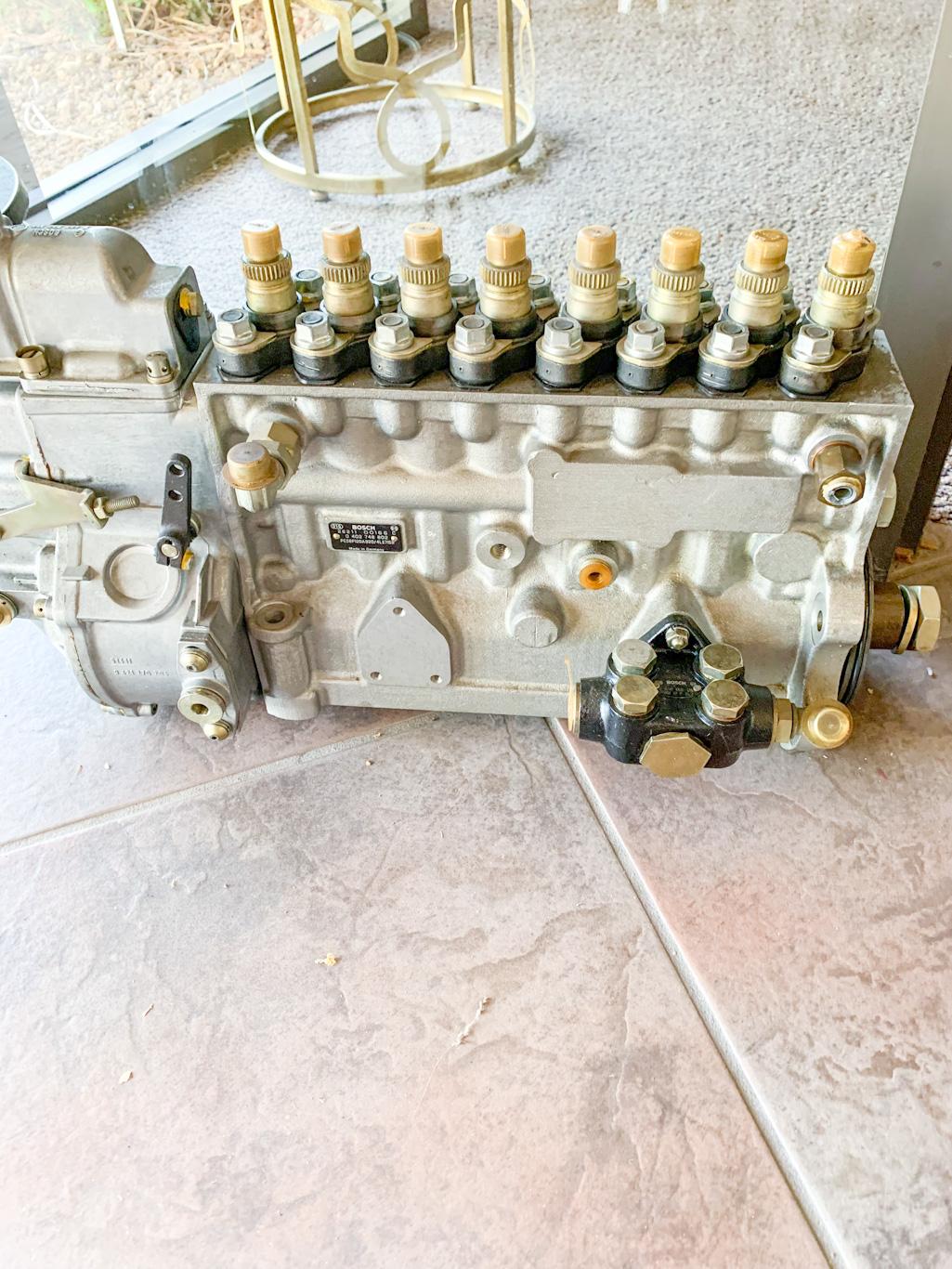

  4. Think this is what you are looking for on the V-pumps used before 1991. Actual AMBAC tags on the pumps. The pump number should start with 8VBB1100 for the V-pumps.

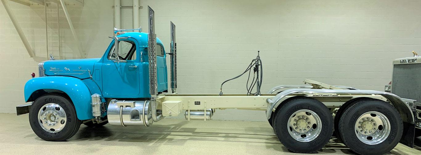

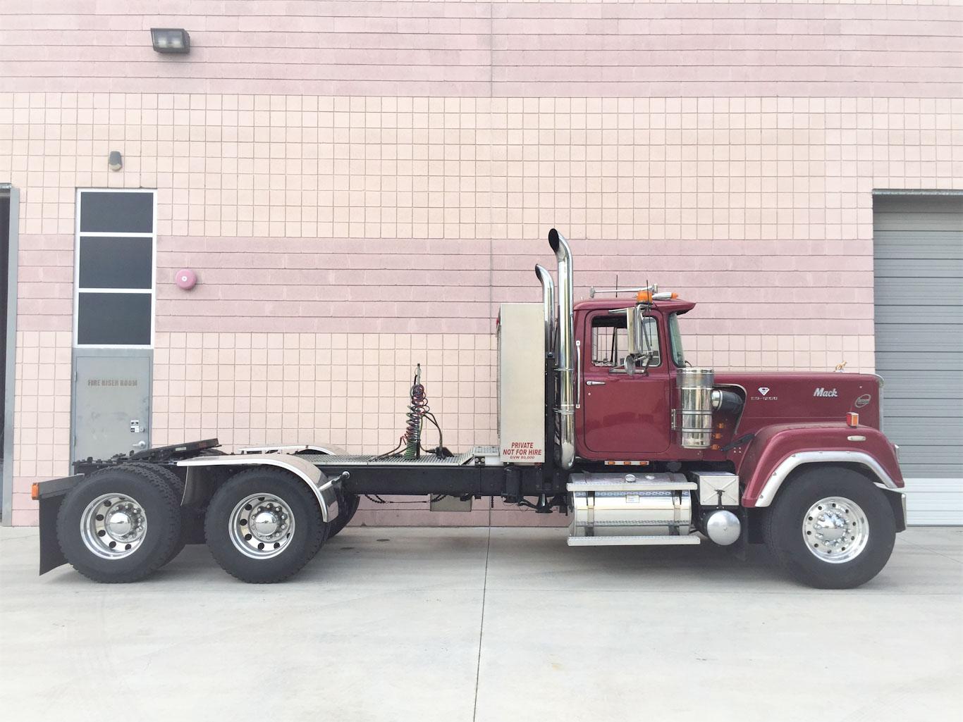

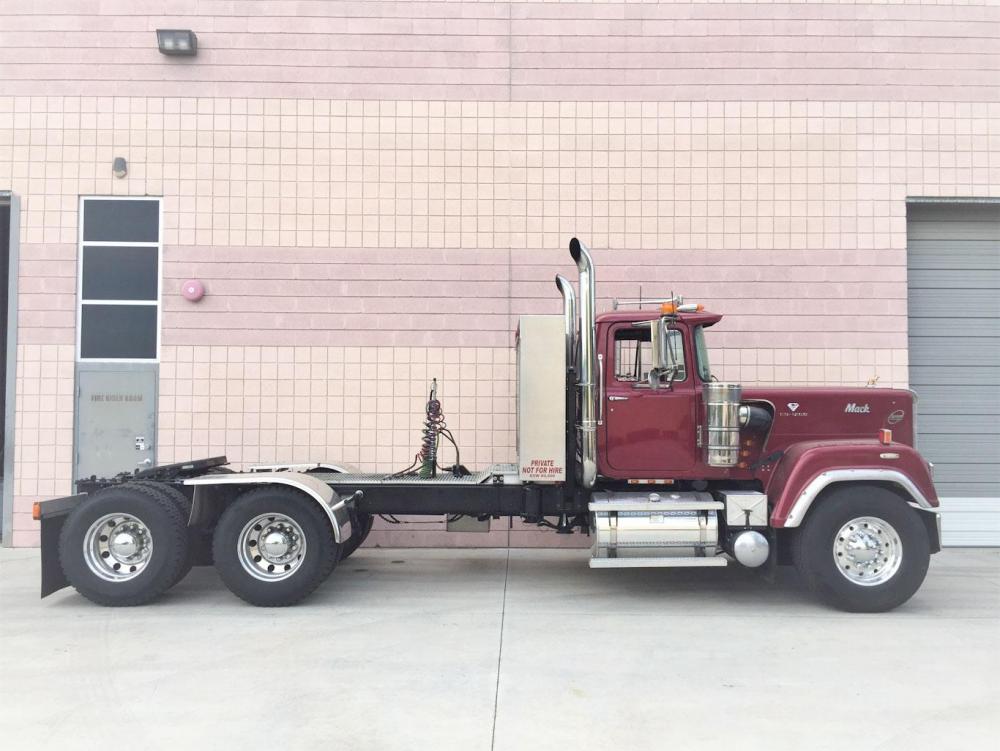

  5. Nice and Clean! Is it the same Osborne form Wyoming? If so how is it getting in and out of Aussie land these COVID days? The cab looks a little strange by the cowling. Is there a different cab on the Superliner? Almost Certain it is a V8 with heavy rears.

  7. I would say that Smalls1184 will not reply as he has not been on the forum for a year and a half. My Superliner is spliced and a Great job. It was spliced to 245" with Rockwell Lockers on Neway airride for sled pulling. The cut-off was left long to add to the wheelbase. The slice is about 4 feet long and goes as far forward as where the stock frame bellies. The stock rails were RW613 9 inch profile 1/4 thick and what was added is like 10 1/2 profile 5/16 thick. Cut-off rails were slid over the old rails, cross members at each end of the splice, though bolted and ends welded inside and out in 4 places. You really have to look to see the splice to the rear. The front is in back of the fuel tanks so you can not see it. This way you don't have to drilling for everything except the 16 bolts that go though the crossmembers. Keeping everything in tact. The angle iron rails for the horns is mounted between the two crossmembers. It worked out well. Yes there are 6 Nathan Air Chimes and sound Great! The end result.

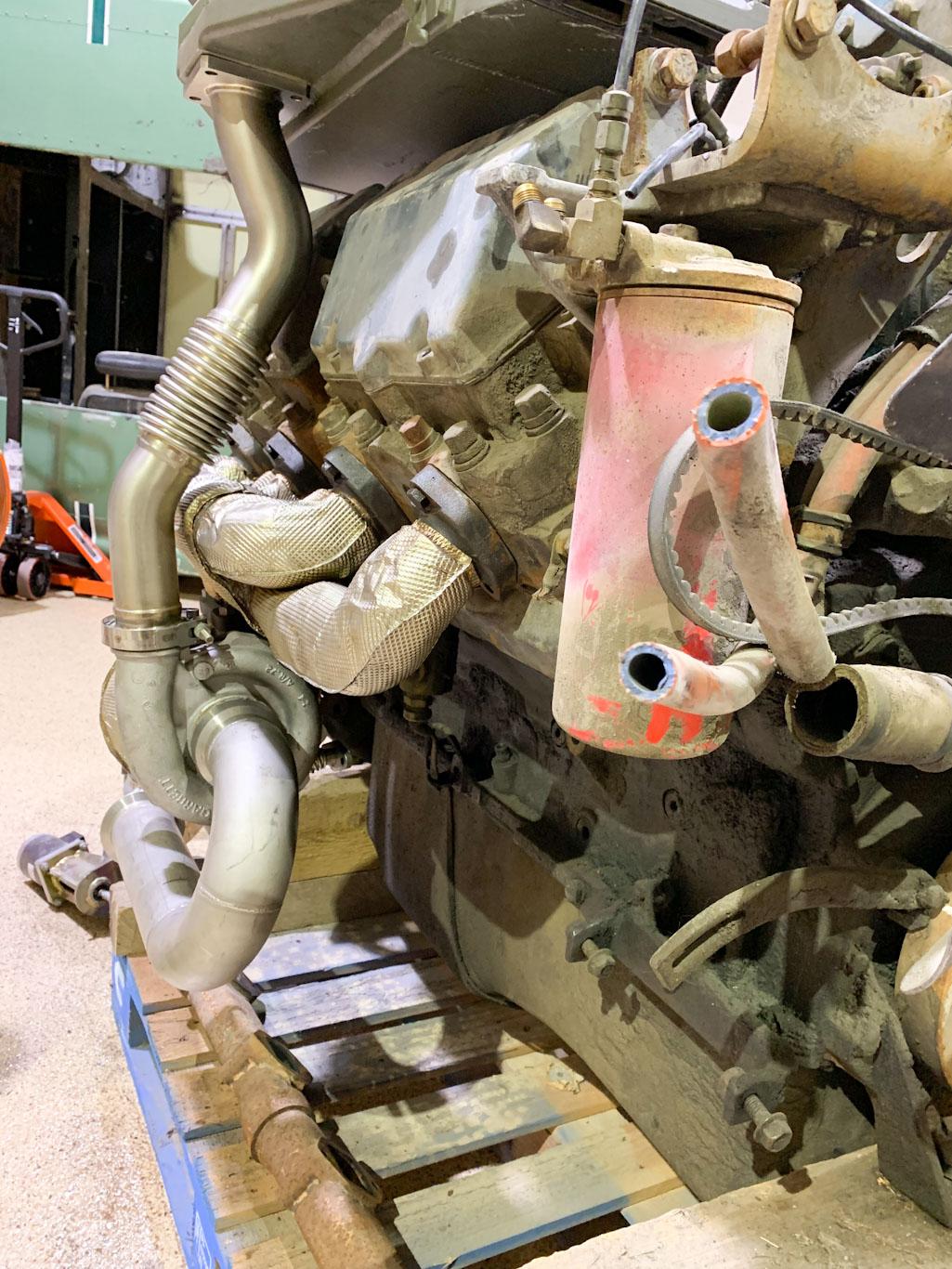

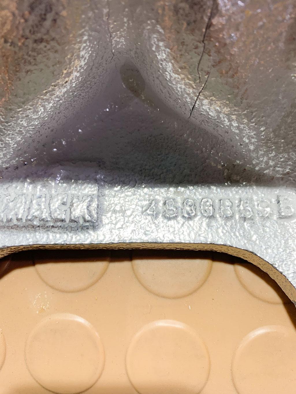

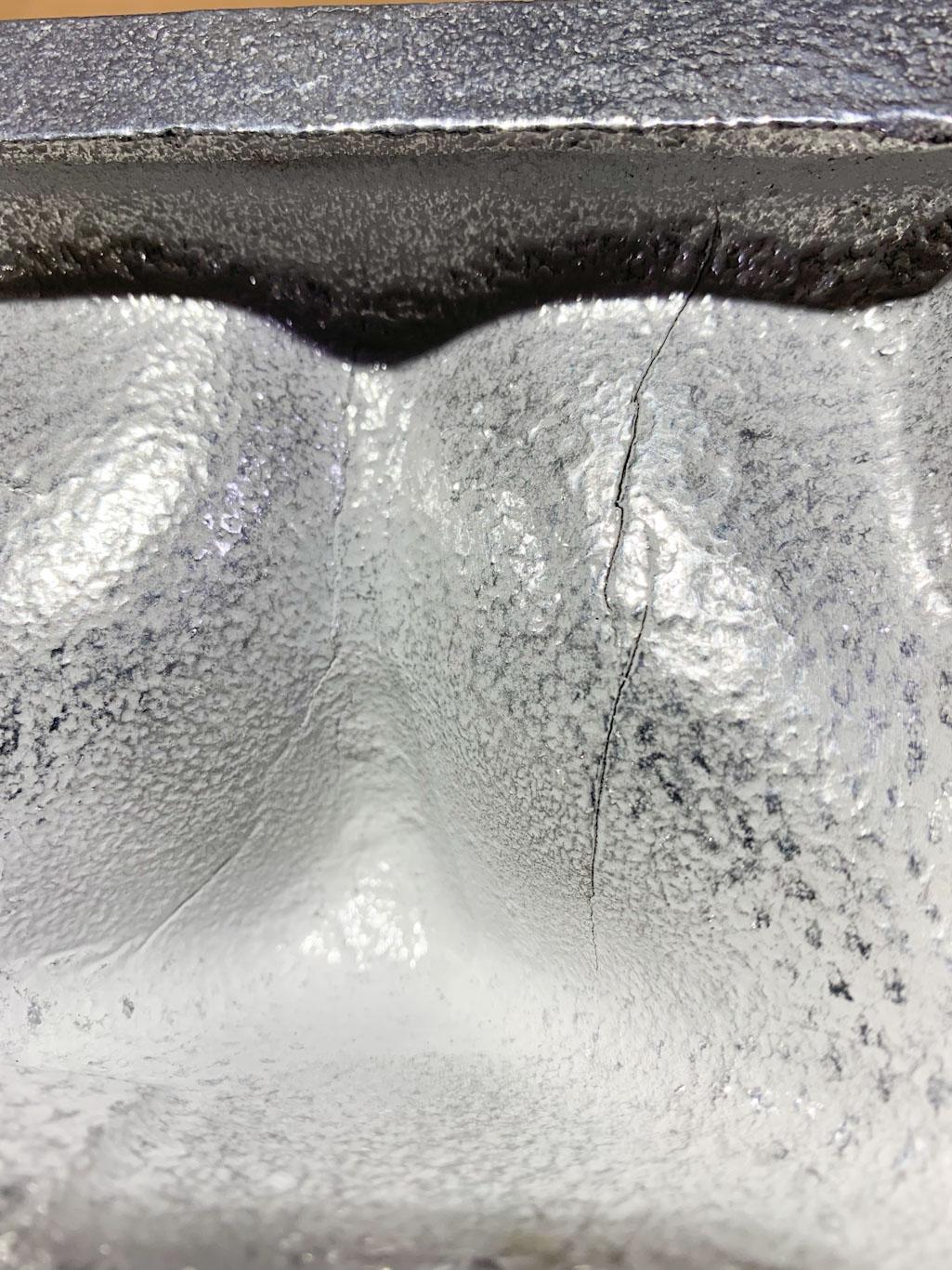

  18. Well I thought I had one good spare set of manifolds/turbo mount. I was getting the part number off the spare casting for Vlad and.... HO...CRACK... Did not notice them them before sandblasting & Ceramic Coating. Not one but two that go all the way though to the inside surfaces. Crappy Cracks... well have to start looking for a spare now along with Vlad. This was the liquid to air intercooler on the Superliner. It was connected to the air to air intercooler on one side and to the engine on the other. It worked good for about 45 seconds then the water was almost boiling using a 20 gallon tank. 2 water inlets and outlets 1.25" Diameter. Flowed 60 gallons a minute. Intercooler tank that was in the chain locker behind the cab. It is a 20 Gallon tank with the pumps inside. The set-up is off the truck now. Just no need for it on a road truck with just 45 seconds of usefulness before boiling the water. Truck pulling or Drag racing it would be Great. A lesson learned. The tank engine will have four liquid to air intercoolers and a 100 gallon fuel tank converted to by the water reservoir.

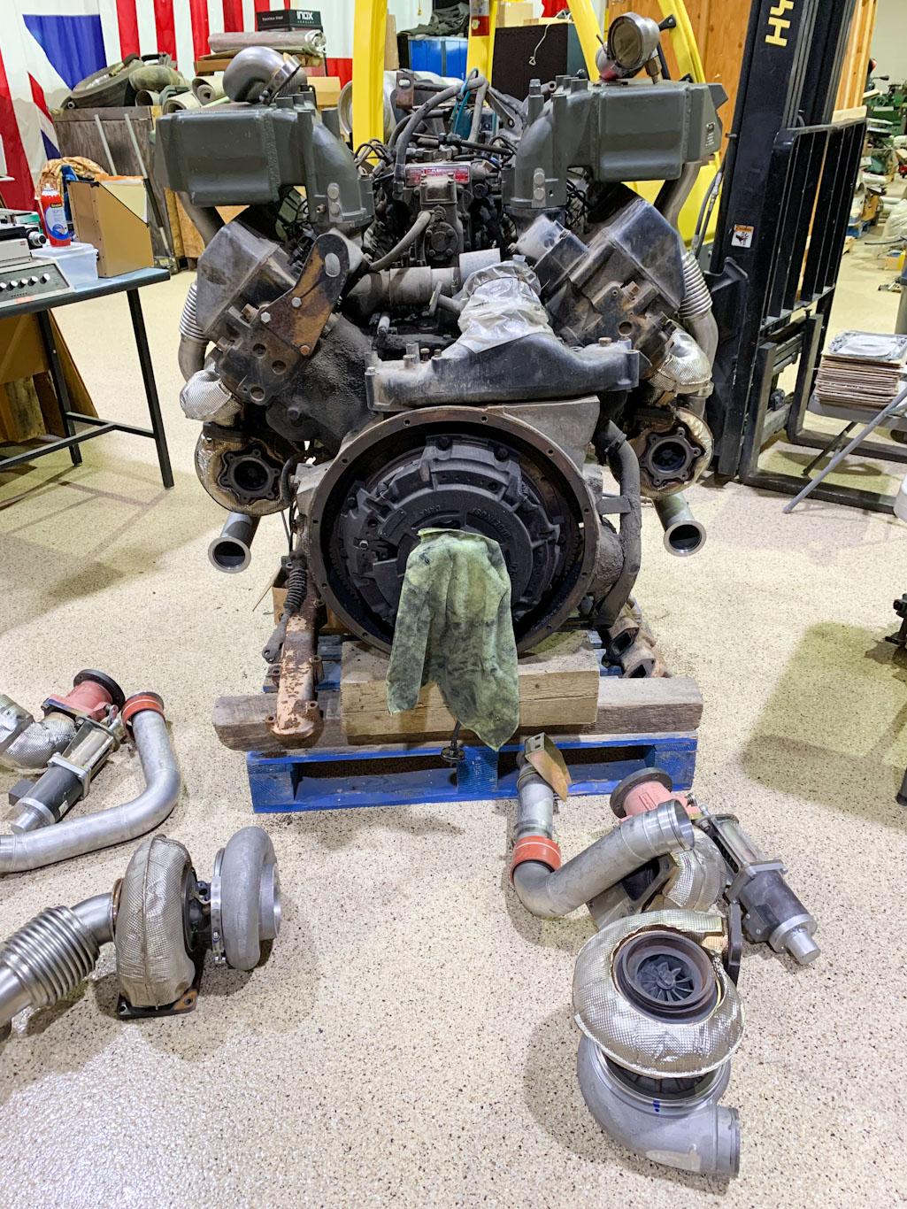

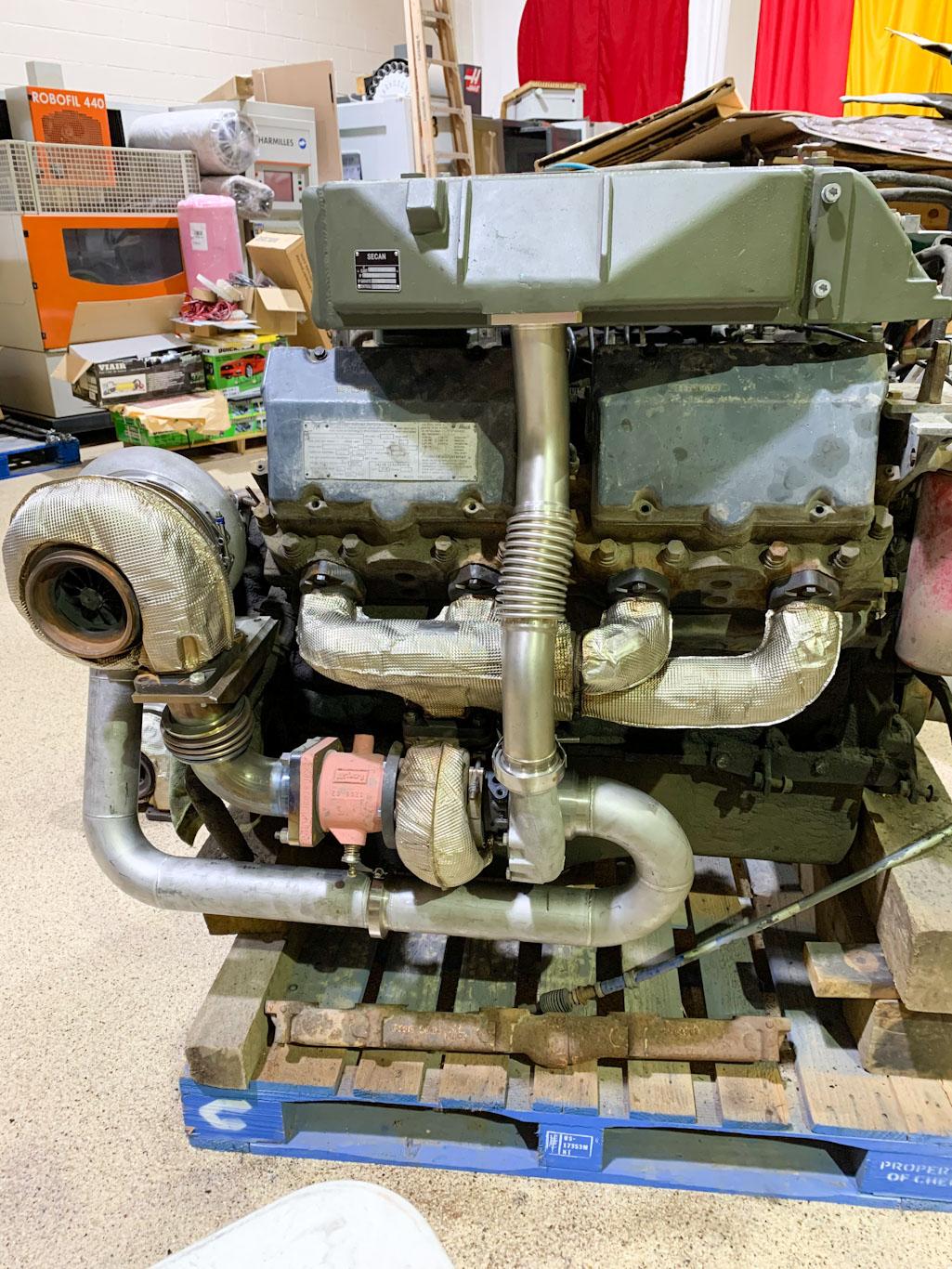

  19. The boost will be there. The Turbo technology since these engines were built has come light years ahead. The Garrett turbos on the E9's normally had boost in the low 20psi and narrow RPM range. Todays turbos will make 65-70psi and a broad RPM range. The Single Turbo on the Superliner made 60psi and spooled up at 1800-3500rpm's then just starts to fall off up to 4000rpm with the old Holeset. Now with a new Borg Warner SE500-91 it is 65-70psi, gauge needle bounces a lot. 1200-4000rpm range. Think I now need liquid filled pressure gauge? Look close on the hood to see the Superman E9-1200. That is NO Joke and the power is to the ground. The flywheel HP is 1500 from the Mack engineers specs/recipe that it was built to. Pump was done at Antrim Diesel years ago. This is with air to air into a water to air intercooler. To the right that is a 91mm Holset T5 that is long gone, number 8 cylinder dropped and ate a valve seat in Cleveland, went though the turbo, and kept on rolling into Phoenix 2000 mile later on 7 cylinders still passing just about anything on the road. Of course there was a "little" extra smoke form the stacks. Heard about it a few times on the CB, I just said give me five mile and you will never known I was there. The boost that I will be OK with is 120psi for the Tank engine project. The engine will spin at least 1000rpm over the 2500/2600rpm military governor so stock turbos may not get it done before running out of air. The truck this is going in is a MH Ultraliner for a few reasons. The engine will be moved back about 2 feet to where the frame narrows. Engine will still be under the cab. The reason is the turbos will hang down on the outside of the frame rails and not interfere with the front tires or steering. I will have to angle out the turbos to get the clearance with some custom wedges between heads and manifolds. No frame alterations except making it a single axel from the Canadian spread tandem it is now.

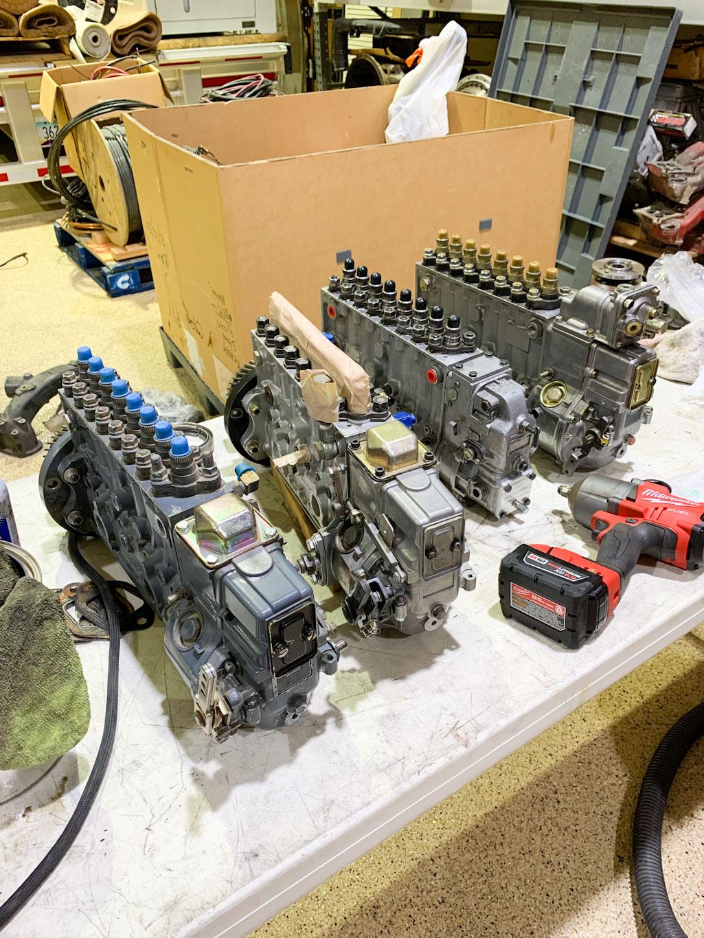

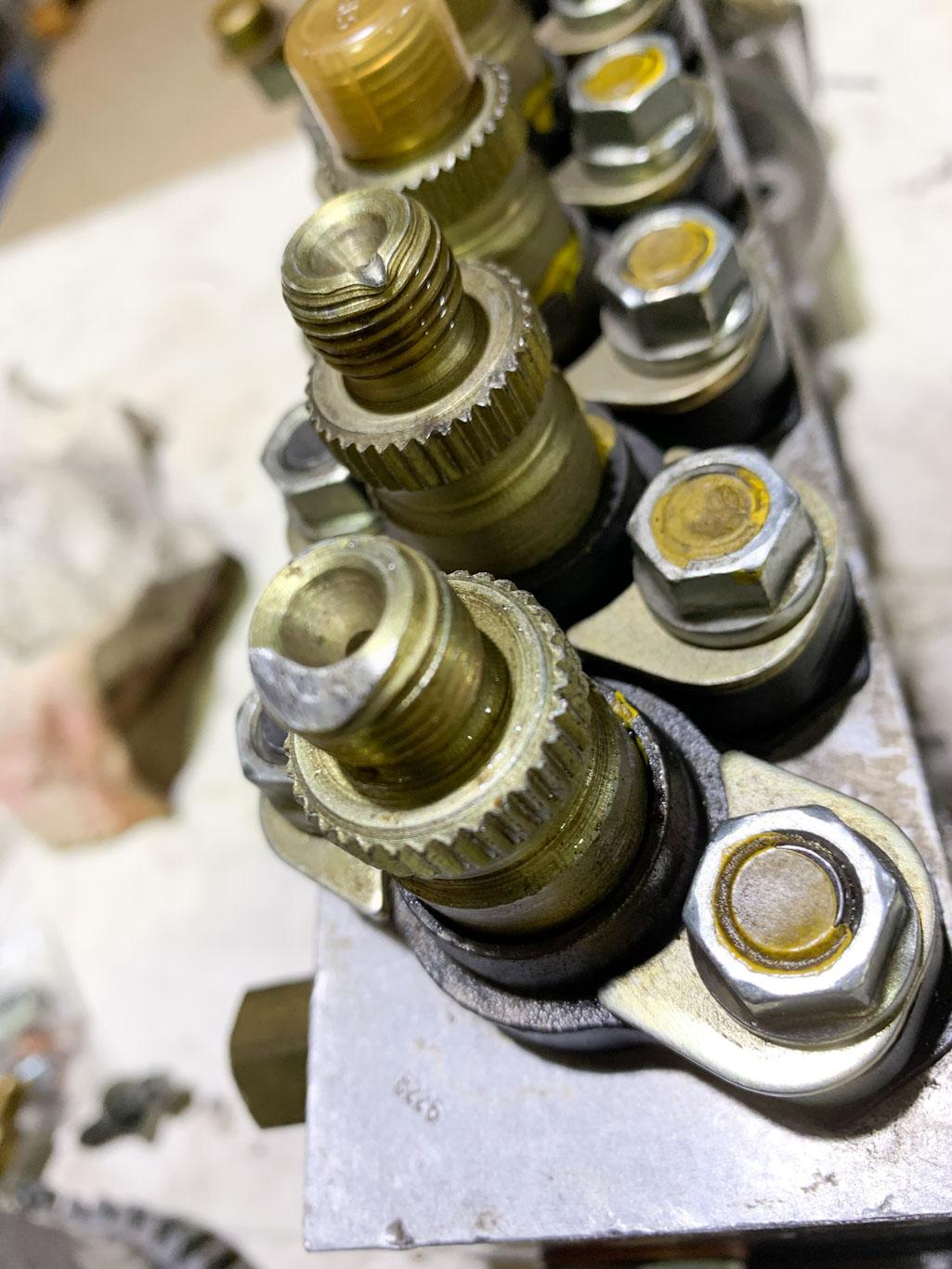

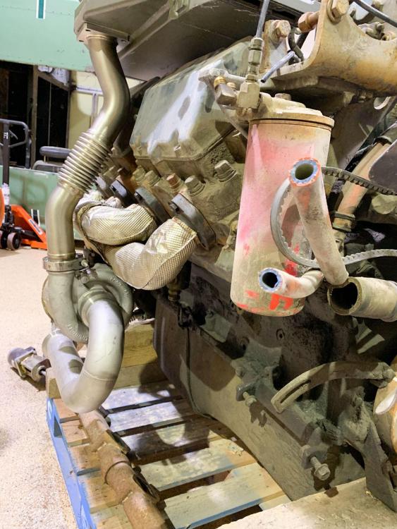

  20. The 3 pumps are ready to go to the pump shop this week along with 3 sets of injectors to get cleaned and pop-off pressures set. One stock set is getting military nozzles, one set already had them. They were in the tank turbo mockup engine and the V-Pump was turned up to Max. The third set is for competition only and duel feed units capable of 2500hp plus. These should be fine but just want the spray patters checked. They will be used in this Quad Turbo engine along with the 14mm pump. The damaged P-pump valve holders will be replaces with Bosch parts. Aftermarket ones are about $30 each but I am not thrilled on them. I do have the Socket to remove them as well but it is off to the pump shop anyway for recalibration. Vlad, If you look on the pallet the four head manifolds are laying there. Those are the only Exhaust manifolds I got with this engine the other pieces were gone. I have one complete spare set of E9 manifolds that I am saving for the other trucks that I have. Manifolds are hard to come by in good shape. Take a photo of your turbo mounting section. From your full engine photo the turbo is off to the right side a lot. Knowing that it is opposite a Mack application it may be the same part or easy to modify, it would mount on the bellhousing in the same location. It was a rare rainy day here, a prefect day to go to the shop and get a little more mocked up. Cool tank manifolds, the right side is a three piece unit. The reason is exhaust cylinder pulsation. What that means is the small turbos are split or divided housing units The way they work best is to have an even left/right exhaust pulse for the corresponding cylinders. Mack engineering did their homework, true Factory Hot Dog Stuff. The left side is a two piece unit that is split as well just not the same as the right. Not the single log manifold, as seen on the pallet, that is on all E9's in truck use. Heat shielding that I will be reusing are stainless honeycomb military spec. Right side manifold, have some work to get the large turbo to fit with the parts I have. It has to be moved back a few inches and up a few as well. The electric engine brakes is going by-by, to much exhaust restriction. Right side three piece manifold. Got the Large turbo almost in the right location for now. It is a open entry T6 mount. Actually these turbos are very close in size the the single turbo used on the E9-500.
  21. I found a NEW inline E9 pump and the topic strayed to Hot Dogging Macks and such. So this topic is about getting the most out of what you got, not just keeping the old dog barely alive. To start I Love BIG Power, it comes at a price but with these Old Macks is so EZ to Have. Not for everyday working truck modifications but for hobby trucks and occasional outings to take the old mechanical dog on a "Run". This topic will not be for all but will be useful information all the same. I finally got some space and time to pull out the Tank Quad Turbo set-up that I got some time ago. In preparation for this I was looking for inline E9 injector pumps. To start the NEW E9 Pump was damaged in shipment. Fed-Ex Said that claim was to be files by the shipper. Pump came from Italy so not hoping for a lot. It has to go to the pump shop for repairs so.... Lets get it Turned-up. Thinking 20% on fuel and 20% on the governor. This will be a Hot road engine maybe going in a MH Ultraliner that is out beside the shop, only has 118,000 original Km on the ticker. Along with that I got a pump or two that I got over the years to put on the calibration machine just to see where things are at. (2) 12mm, 13mm & 14mm shown. Power start with the pump and you got to know where things are at to begin with. Now the Tank Engine set-up. Mocking this up today on more than likely the engine that will be rebuilt to handle the power output that this set-up will deliver with a 14mm pump and a little "Secret" stuff. No shifting required with this set-up, as manual trans do not shift well over 2500RPM's. Trans is the bullet proof cable shifted, no electronics, Allison HT750CR Automatic. There were only a very few E9's with Automatics orders only by the US Military and I believe they were HT740 Allison's. Lets talk, Hot Rod Stuff, From the other post 300bar injector pop-off is higher than Mack spec but it works better for fuel atomization it is 50bar higher than Mack spec. About every 25bar the engine timing needs advances 1 degree, 2 degrees for 50bar.

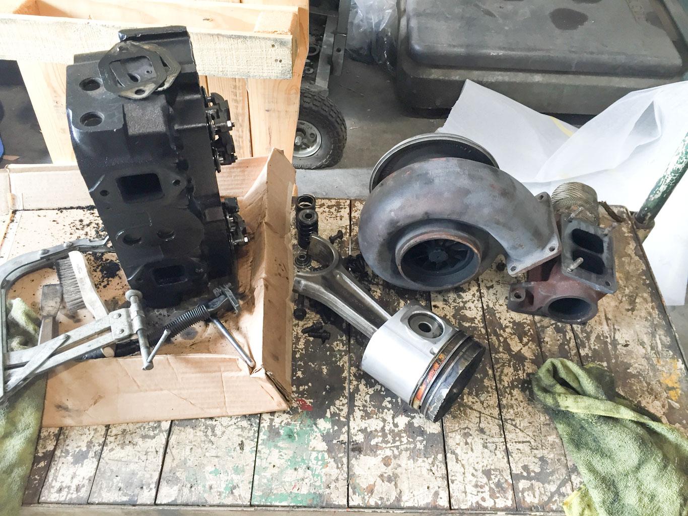

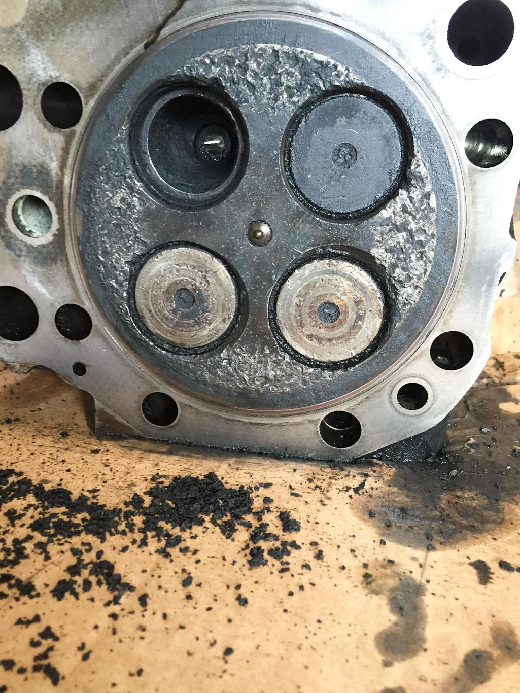

  23. If I was planning on putting a HOT E9 in a hobby truck there would be no need to get all kinds of parts, just work with mostly what I have. If all parts are reusable: Standard pistons, sleeves. Check diameters and roundness to specifications. Sleeves do crack, check to see if there is any rust scares in the sleeves. Hone the sleeves use new rings. All new bearings, gaskets and seals. "Small Head" bolts these are the better ones. Head bolts do snap on these engines. Do a valve job, check guides. Original valve springs should be fine, have them checked for seat pressure at install height. Maybe shim to increase seat pressure 20-25lbs. Valve seats come loose on E9's with added heat and not driving them properly. Never take your foot off the peddle completely after pulling a long incline. Keep some heat going on the downgrade. Turn pump up 20% on fuel and 20% on RPM's, that is 255cc on fuel, stock is 212cc for 500hp. Governor from stock 1900 to 2300RPM's. Use the stock injectors and nozzles set to 300Bar. This is good for 625 plus horse power and will run down any other truck on the road. Adding a new Borg Warner SE480, large exhaust wheel Turbo, around 1.18 A/R exhaust housing and that is it. You have to get a clutch capable of holding 3000ft/lbs of torque giving your left leg a workout. Most inline pumps ether 6 or 8cyl are 10-12mm barrels. 13mm and above sizes are not stock, in most cases, There is a 13mm, PE8P130A pump that is used on the Big Iveco Eurostar in Europe but is a base mount not a flange mount pump as on a Mack. One thing that I need to state DO NOT WORK ON ANY INJECTION PUMP, TAKE IT TO A REPUTABLE PUMP SHOP. You can not do the work without a calibration bench and machine. They will recalibrate the fuel delivery, the governor and pop off pressure for the injectors. There are very few shops that will modify a pump with larger barrels, cam, delivery valves, etc. Never use anything but factory Bosch parts for the pump. RPM's are not your friend the lower the better. I can say that a T2180 will not shift if you are over 2500RPM's, it will stay in gear until the input speed comes down.
