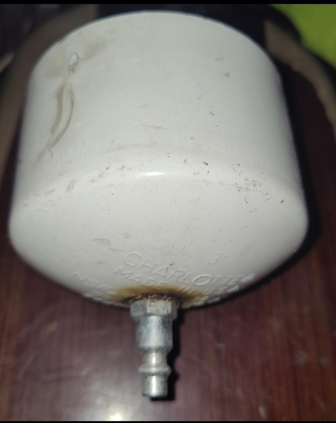

  19. Here's my set up..cap fits inside intercooler boot.put clamp back on ,not too tight , then apply shop air, don't put too much pressure as you could damage your intercooler, 20psi should suffice.let us know. Red Ps: I couldn't find my 1/4 npt tap so I just heated the fitting with a torch and made the threads that way.then put a nut in the inside for safe measure.😅
  20. It will build some pressure but engine fan will blow the bubbles off.the way I test the intercooler is by capping both sides off with plumbing pvc caps..one of the caps drilled and tapped for 1/4 inch npt fitting..then apply some pressure and soapy water.
