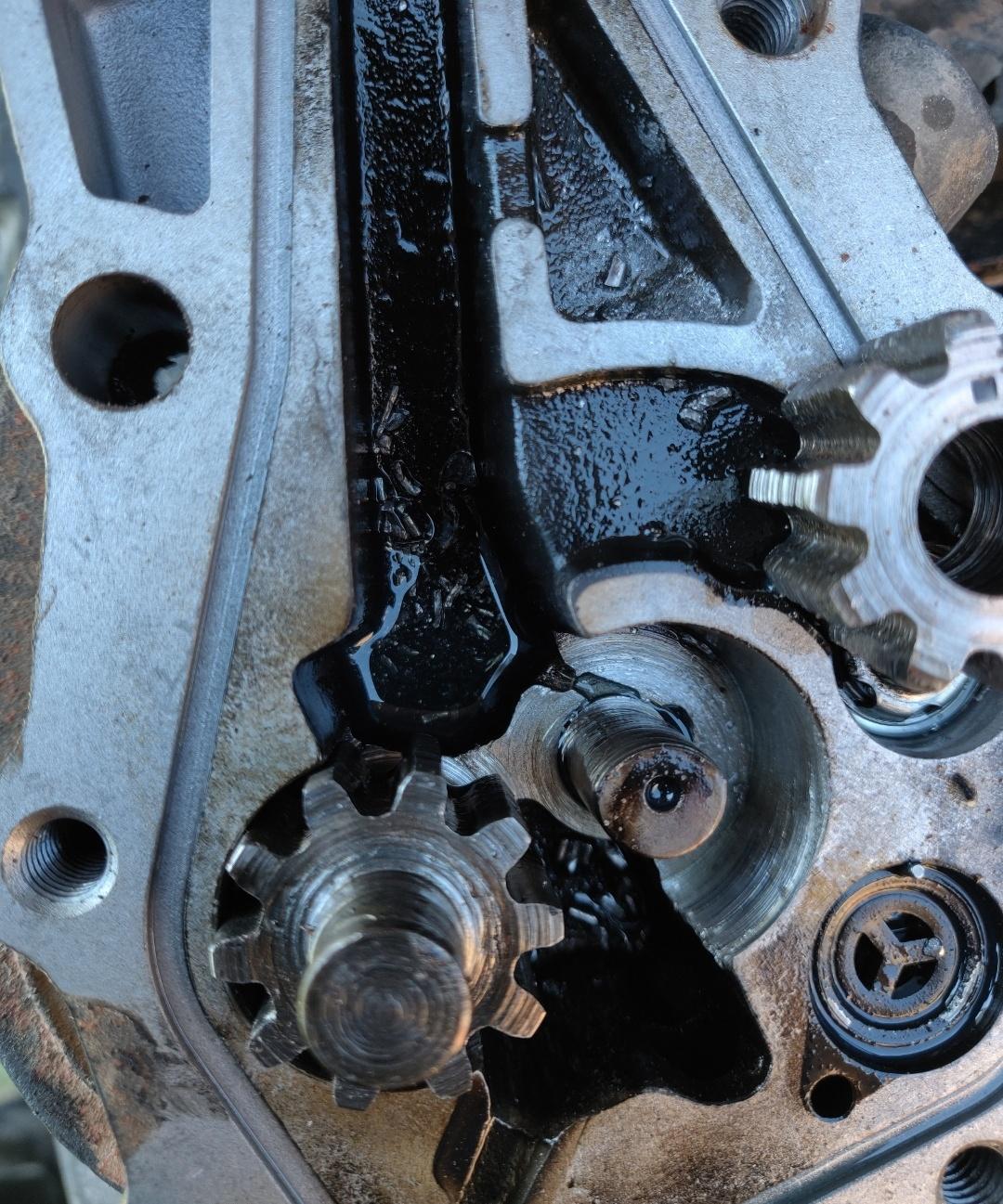

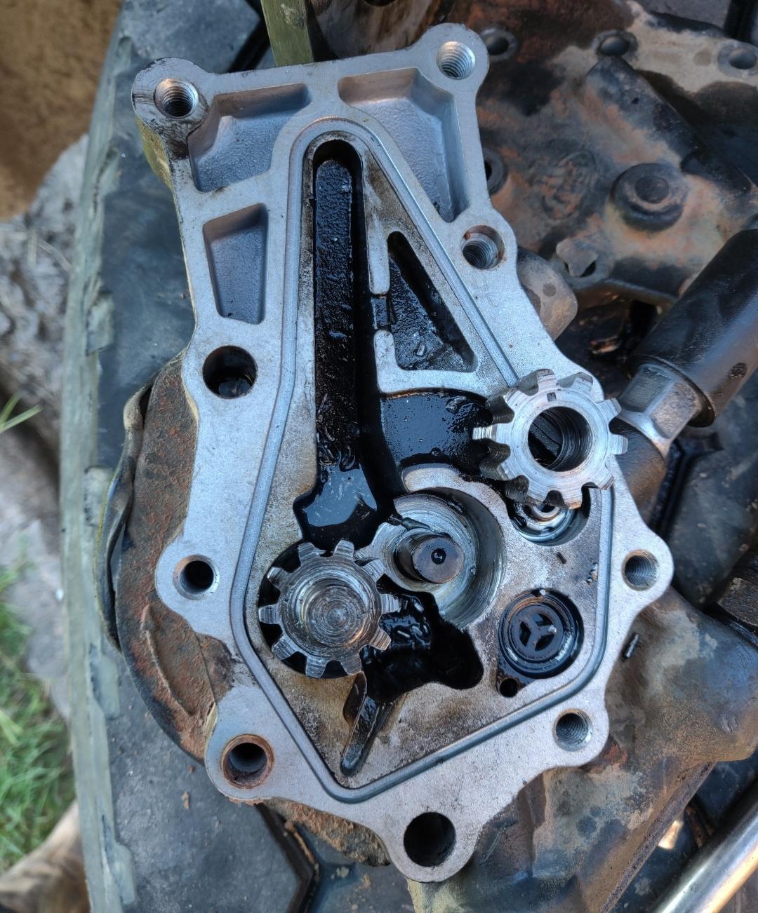

  1. Truck has developed a low to mid rpm ticking sound.seems the same on power.the air compressor is passing a good bit of oil and noise comes from that area.Im waiting for a mechanic stethoscope to kinda zero in on the source..I'm thinking air compressor but I'm also wanting to check the eups since the rollers or springs could be bad.im going to order the eup orings and see what happens.What other components do yall recommend I check? ticking sound is felt most from 800 to 1300 rpm.let me know what y'all think . Thanks Red

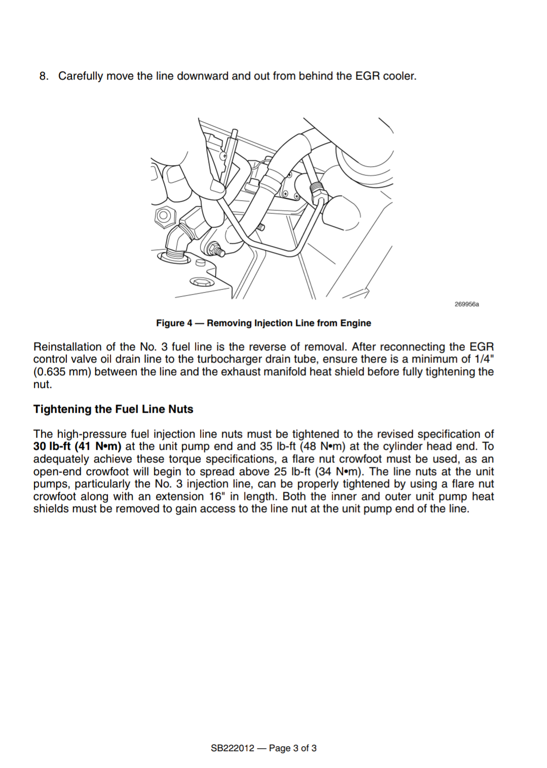

  10. Yea , when I did the manifold, I used the crows foot to take them to 30lbft .
  11. I'm replacing the injectors, I guess I misunderstood the manual.😅
