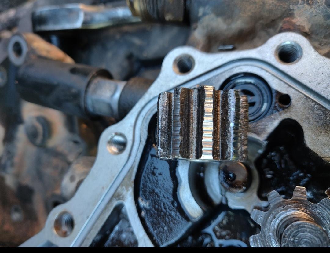

  2. Found the issue ..3 ecm pins have completely eroded off ..need a new ecm
  3. After cleaning.im getting a " no info" on the dash.could the ecm be fried?

  6. I used a caliper micrometer to measure the ring and it was about 15mm .I built up the material in the fork and then ground it down to around 14.8 mm to give it some breathing room. The fork originally had a thickness of around 10.5 mm , those extra 4.5 was the needed push to make the low range clutch engage.

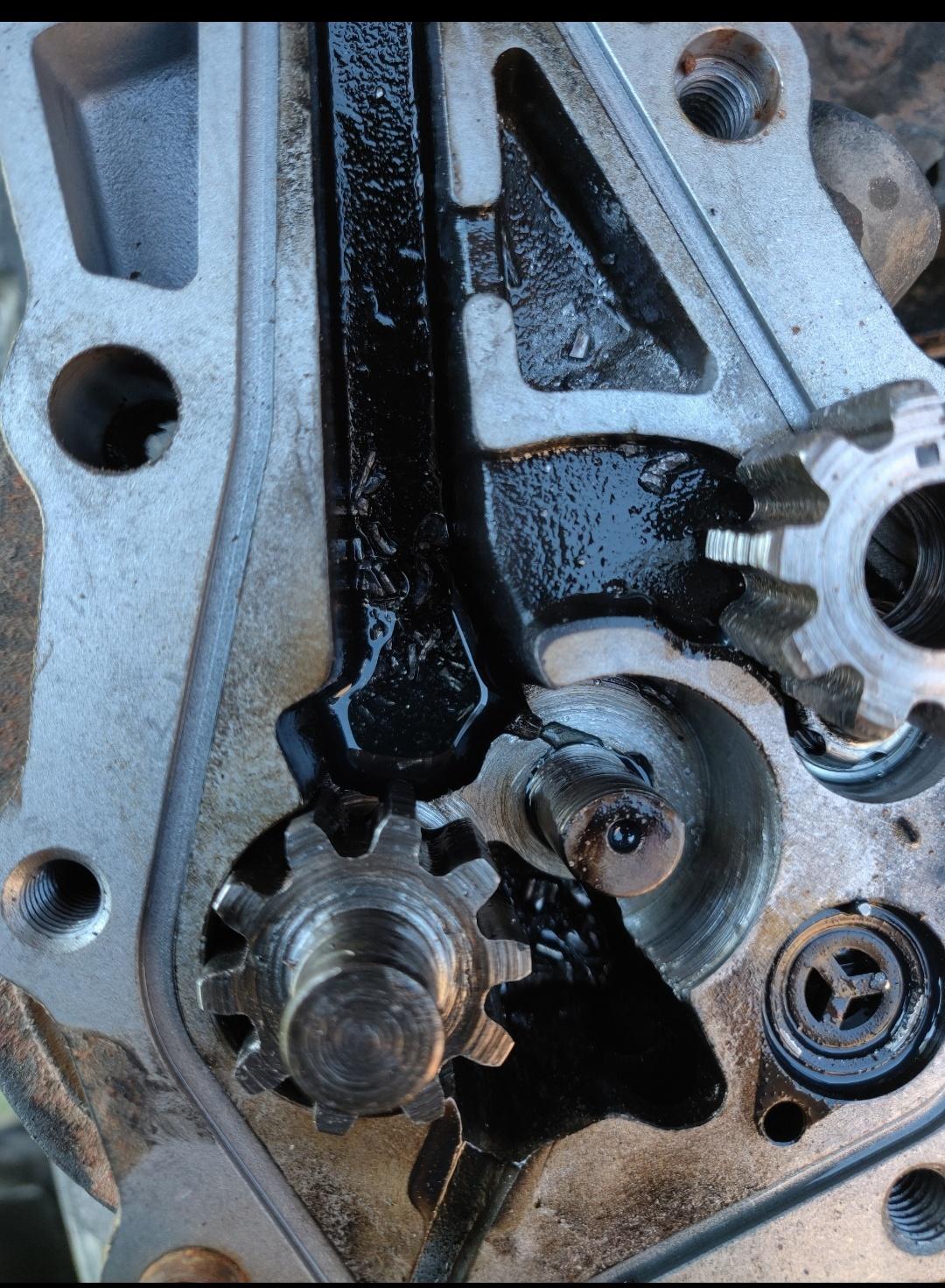

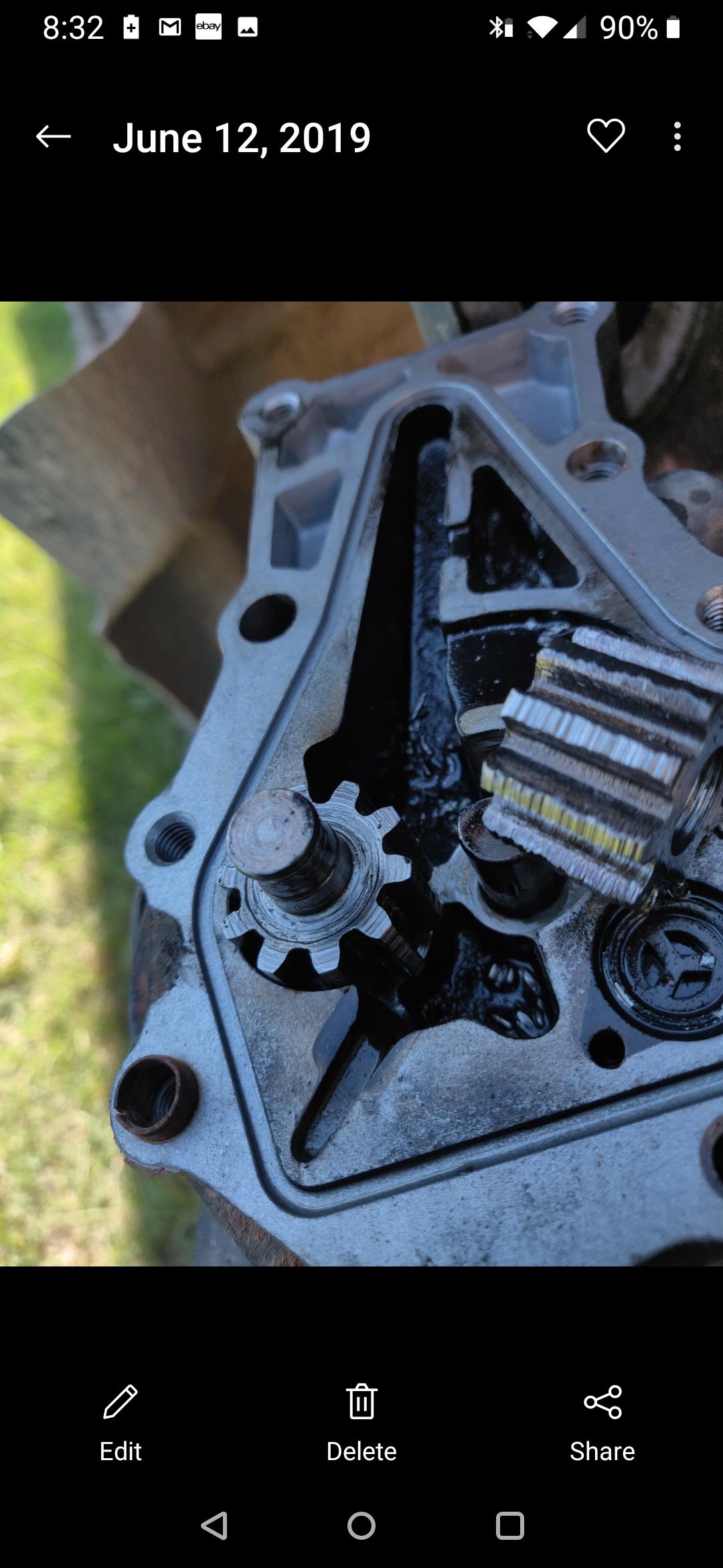

  10. Finally got back from a much needed vacation and got to work on the transmission.took the rear cover off and below are the pictures of what seems to be the culprit. Not sure what the specifications are for shift fork wear but this one seems to be very worn.please advice. Thanks Red

  15. Ok will do.worst case scenario only the back box needs to be removed correct?
