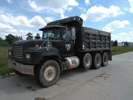

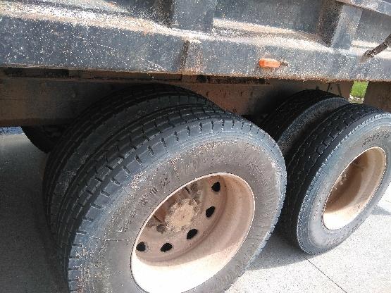

  22. I could also trade for a 18 foot dump truck body and steerable pusher axles.
  23. Selling 96 Rd. 350hp mechanical 10 speed Eaton Fuller (overdrive) 4.17 ratio on Camelback suspension 20k front axle 20k Pusher axle Cold a/c Dump body vibrator Truck works every day.selling in order to buy longer wheelbase truck that can carry more payload. 16500 or best offer. Thanks RED
