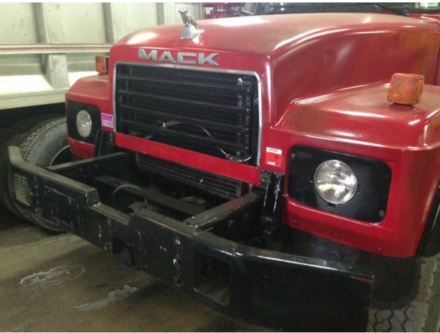

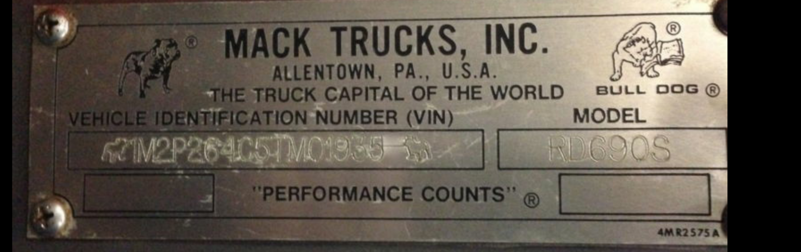

Can anyone help in getting a part number for the headlight bucket in the picture.or at least a vin i can give to mack dealer in order for them to order it.thanks Red
So i finally get around to getting these headlight buckets for the truck but my local mack dealer cant pull up the vin in the picture above..they say its missing a number ...but how can that be?
