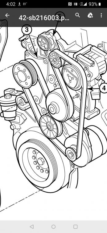

  17. Or draglink.
  18. I believe the dimensions of rim is 22.5x12.25.they come in different offset . personally wouldn't get a rim with too much offset as it would defeat purpose of a the fender and throw mud back at you.
  19. Changing over to a better flowing manifold reduces back pressure which increases engine performance and longevity.
