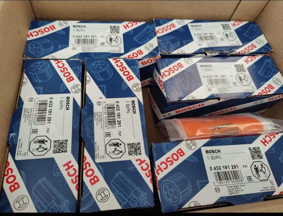

  15. First time doing these exhaust spring push rod engines...I was used to etechs and mech e7s.....how I miss my old mechanical e7, 350hp with an adjustment on the puff limiter and it would run circles around the ami..best of all..no computer
  16. No disrespect at all, I'm here to learn . I went by the mack repair manual .I lined up the valve marks at the flywheel on 1 &6 . 1 being on compression i checked the lash.then proceeded to 5 which is 120degres apart and the next on the firing order. And so on an so forth , two full revolutions to check all valves...but please advice if I missed something.like I said .I'm here to learn..also pressed the spring on the exhaust pushroad and held it pressed when checking exhaust lash...
  17. I sure do hope so...but the weird thing is that the truck is not down on power or blowing any kinda colorful smoke..next step is to run the overhead as I only checked it the other day , didn't want to start messing with it and have it affect diagnosis..like I mentioned before, valve lash was only slightly off on a couple valves..not enough to cause the ticking ,I supposed back then
  18. Joey I kinda was getting the same idea,but didnt unhook the belt, I stethoscoped the water pump and alternator and they sounded good..noise kinda sounds like a blown exhaust gasket on a small block Chevy.
  19. And this is where I bought the Bosch remans. https://www.mddistributorsstore.com/bosch/0986-445-008/reman-eup-injection-pump
  20. Machine that tested the eups here in houston sounded just like this one. https://youtu.be/elCZ3HMp8k4
  21. Local shop in houston.they are tooled to test them.I replaced the higher pressure eup.so all in all replaced two with reman Bosch .yet the ticking is still there ..not as bad but it's still there..I'll investigate a bit longer and let you all know.
  22. One of the eup was higher in in pressure.413 he said, all other ones were in the 340 to 370? could this high pressure cause a fuel knock?
  23. Guide pins look good, haven't measured them but all look good,I think the book says 2mm stick out ,can't quite remember.i had all the eup tested ..the 3 suspected to be good passed the test.two of the ones with loose springs just needed a new clip the injector shop guy said....so far , one was bad for sure.ill pick them up tomorrow morning and see what's what..I got some Bosch reman on will call at m&d distributors ready to be picked up in case I decide to just replace the 3 questionable ones..431$ a piece.
