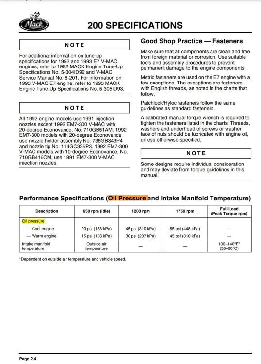

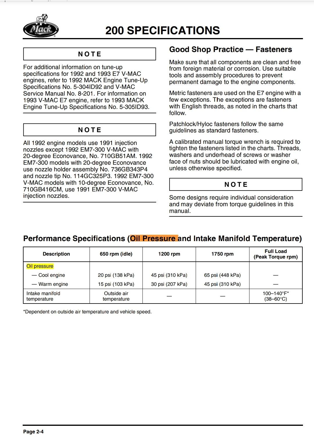

  22. Check this out and judge for yourself.
