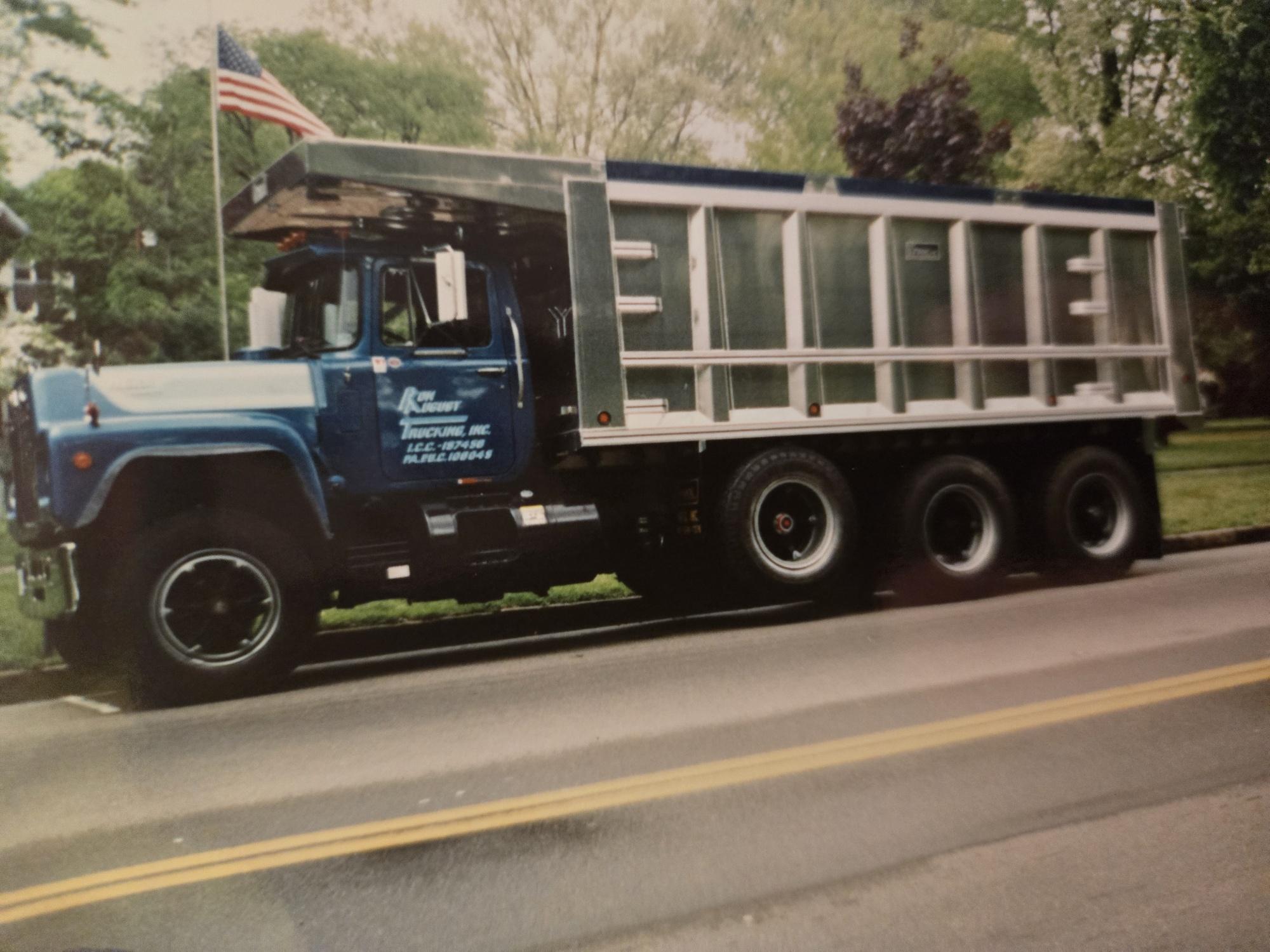

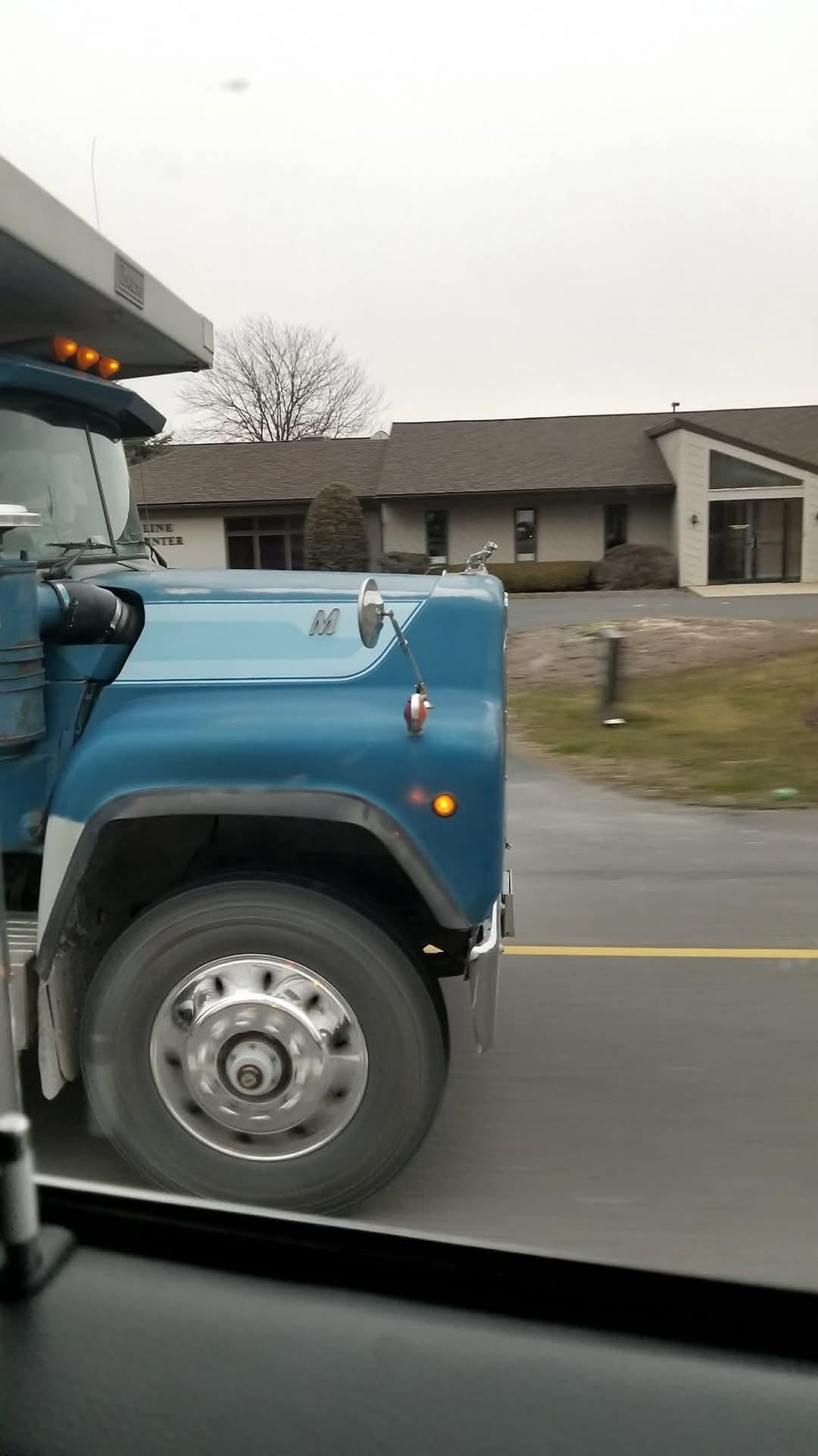

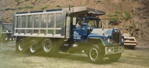

  6. Friend of mine is trying to find this R Model dump that he thinks was his Grandfathers Last seen hauling out of Alen Myers Quarry in Gap PA. He did contact someone at the quarry that told him that the man driving had past but did not what happened to truck. Any info would be appreciated. Can message me if you know any thing . 2 of these pics are from when his grandfather owned it other is one took recently in passing on road i assume near Gap
