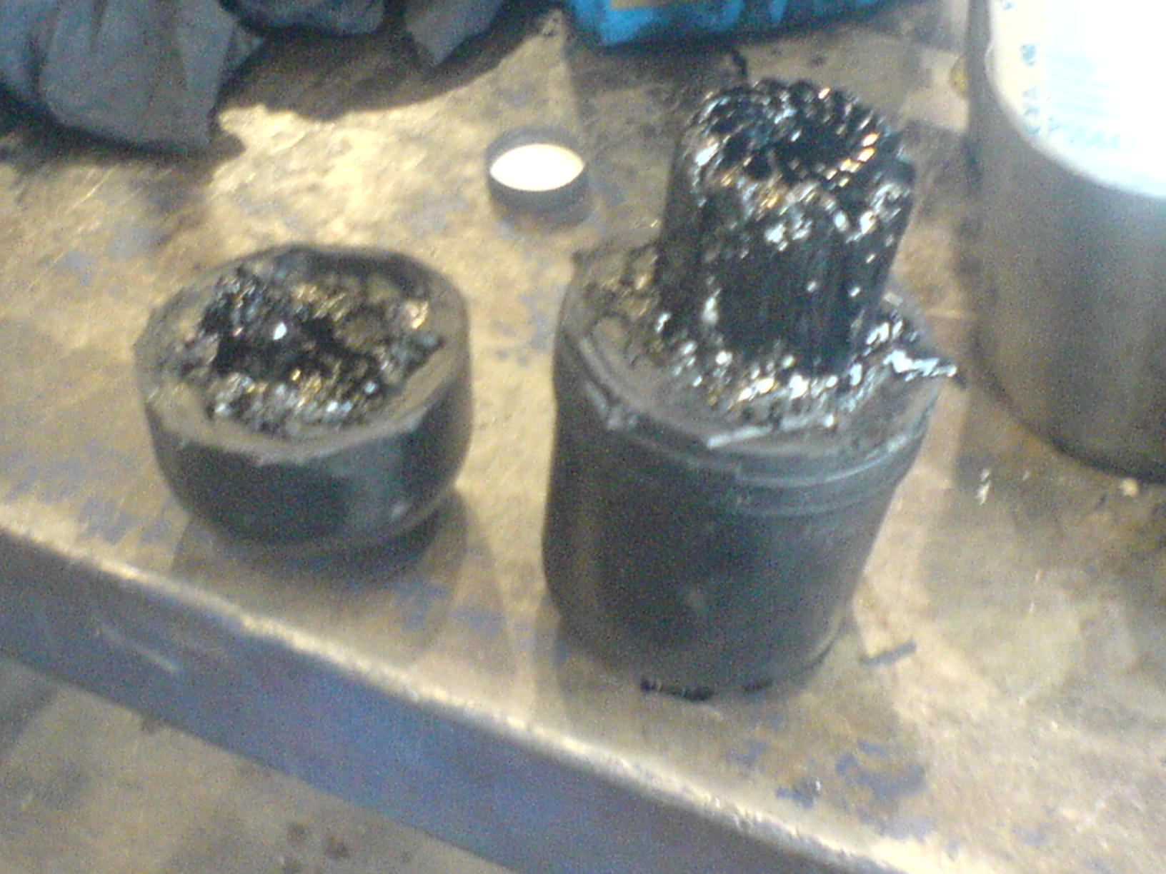

  22. Your welcome !Post your findings and fix
