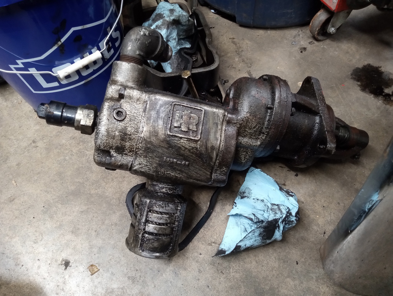

I believe the fins are sticking cause I took it off the motor and it's not spinning and when I take the air line off and hit the lever from the valve I do have a lot of air pressure from my tank. So I figured I need to rebuild it. I am 39 and don't know to much about these old b61 and especially the air starters this one is the first one I have ever seen.

Here is a breakdown of the I-R vane motor that is common. There are other mfg and other models that are obsolete. Knowing what you have is important.
If you have the older BM series you might not be able to get parts, but that doesn't mean you can't get it working if you are careful.

Yeah, plus  you can a lot of times wind up, pulling it apart and soaking the armature and veins and clean  up. The housing might be able to save us few bucks as Geoff mentioned. there’s plenty of parts out there. Good luck and have a ball with it. Bob

Mine is an IR but has no tag.  All alum housing with cast pinion drive.  Appears to be different then yours.
Mine has four bolts around perimeter that allows the end bells to be removed.  I didn't have new gaskets and friend said use "pop can cartons", so I cut them out and it works fine.
You need to get some diesel fuel or air tool oil and get the vanes loosened up.  Wash it all out and get it reassembled.  I purchased an oiler for mine as after a couple years the vanes started sticking.  Oiler takes a squirt of fuel from your return line and gets it injected into motor to lube the vanes(just like you do to an air tool).  Been about 8 yrs without a failure.
Larry, you likely have the 150BMP series I linked the draw above. That is what I have also, very robust.  I-R still lists them in their catalog, but everything is going turbine now. Motor segments are aluminum, drive nose is iron.
rear housing/cover looks slightly different then the more modern ones, but that is it. May be they updated the rear housing. Other than that it looks like a 150 of today.
