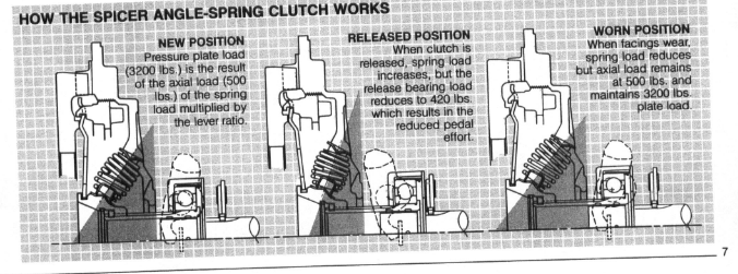

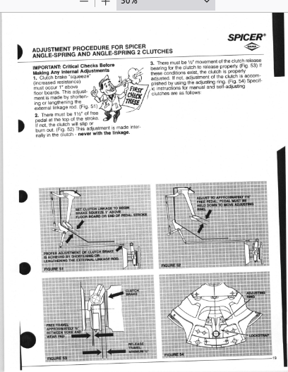

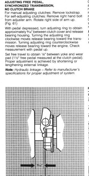

Thanks for the replys guys.On the build sheet for our Cruiseliner the clutch is described as a 14 inch twin dry plate self adjusting Spicer/Dana unit.When we got the truck there was no free play at the pedal.I removed the small plate with the 2 bolts and the small adjuster cog behind it which was stuck with dust.I then adjusted the larger adjuster wheel by tapping gently on the teeth with a screwdriver/rubber mallet untill I got 1 3/4in free play at the pedal.I found nothing that even looks like a clutch brake or parts of one in the bell houseing.Did it ever have one or was it removed by someone else?? I dont know. However my question is not clutch adjustment but trow out bearing adjustment.Iv read the trow out bearing should have a 1/2in gap between it and the pressure plate but ours is 3/4in. The clutch is working fine as it is with no grinding going into gear moving off.....maybe I should just leave well enough alone???

Interesting... I never saw the adjustment gap related to the pressure plate, only between the throwout bearing and the clutch brake....  Well... I just learned something.
You could be right Joey,I thought the article I read said bearing to pressure plate but now I'll read it again tomorrow and see.......thanks
