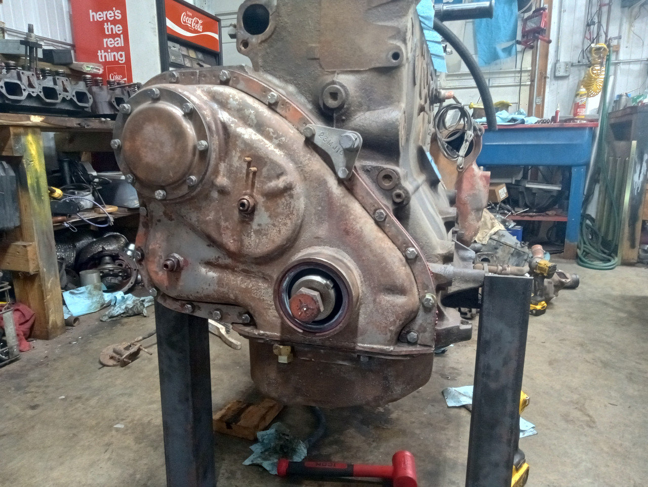

The pan is on.
Geez that was a PITA, sorta.  Lost a front big bolt, got all the rest in and the two fronts would not start.  Had to bang the pan around and they finally started.  Had to jerry rig the one bolt until I buy another but at least it is torqued down to set the RTV.

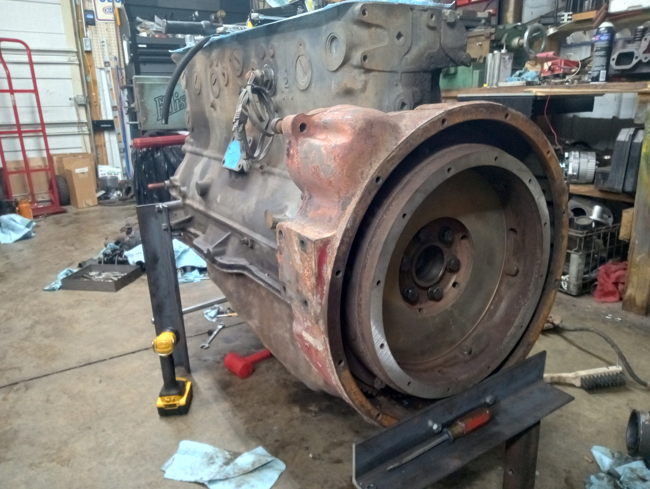

Went ahead and bolted flywheel on.
I wire wheeled the lugs and they are pretty straight yet so I won't be screwing with them.  Just will make sure new clutch plate floats good.
