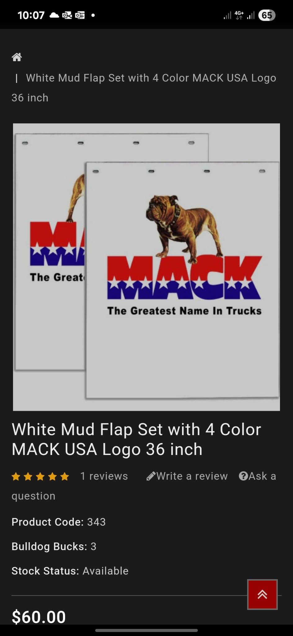

Yeah freight charges are gone mad.We were quoted 450$ to ship two Mack mudflaps from the US to here.The flaps were only 60$.....crazy stuff
I had the same ones on my 82  cruise liner I think they were brand new back then not retro.lol bob
Id say your right Bob...We want them because theyre the mudflaps on Pig Pens Cruiseliner...
