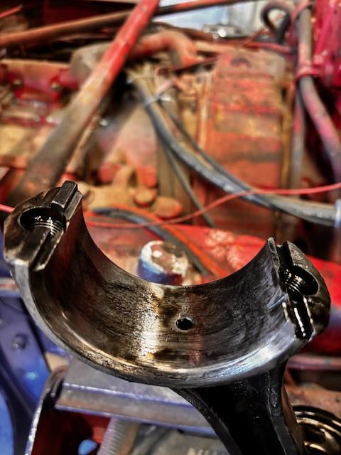

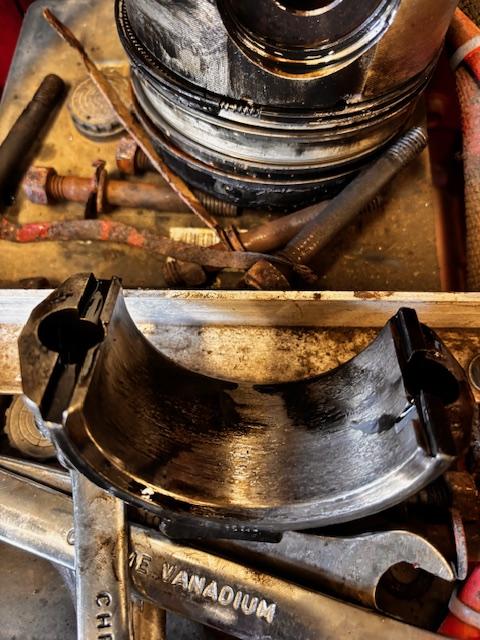

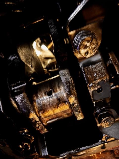

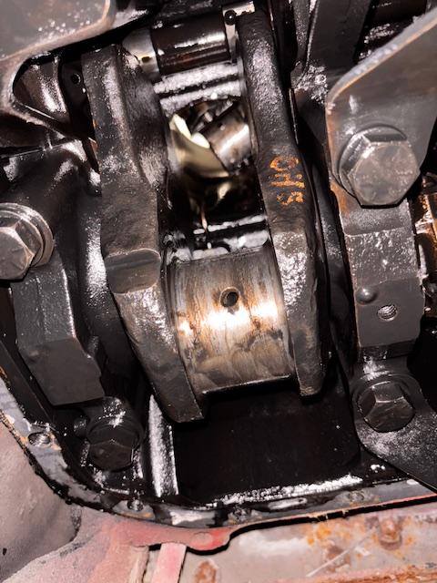

Sorry to hear bro ! Unfortunately your in the years where they may have been experimenting with two piece pistons pull the pan and up root the pistons! This first try at this didn’t work well for mack you may have a broken piston skirt !The lash you show in the second vid is normal on an engine brake engine! Let us know what you find!😡
