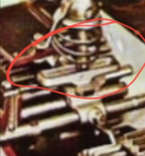

when you had the shifter out, did the slots for the shifter pawl look rounded out as well as the pawl ? It can get stuck in gear or even put it in 2 gears at once.  If there is too much wear.  Going back to what trans it is..  its a T-2090..
I didn't notice that they were, but I was taking a good look at the forks  and the clutches, and not sure if I got a good look.  My son who drives it as much as I, says he revved it pretty high coming down a hill when he downshifted, then when it was stuck, it was almost like it was jammed in the wrong gear, in other words it was in third gear, but he wanted  first gear.  The thought of a worn shifter paw crossed my mind. That wouldn't be hard to change out. Can't get the cover off with transmission in the truck, unless I cut some of the floor out.  Thanks for the model on the trans. Looked it up, and yup, that's the one.

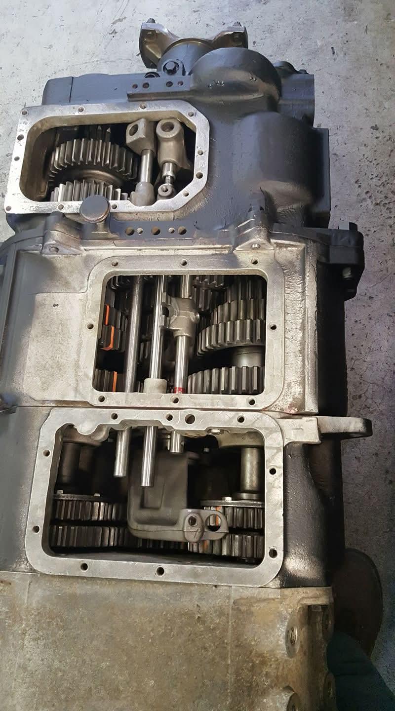

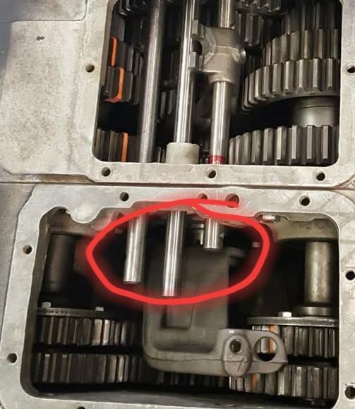

It sounds like a rod all selector fork is loose on a rod
On any other brand of box, we're the stick enters the top of the box becomes worn and when you race the gear change the stick comes out of the selector rod dog and leaves the transmission stuck in gear
But more detail is needed
