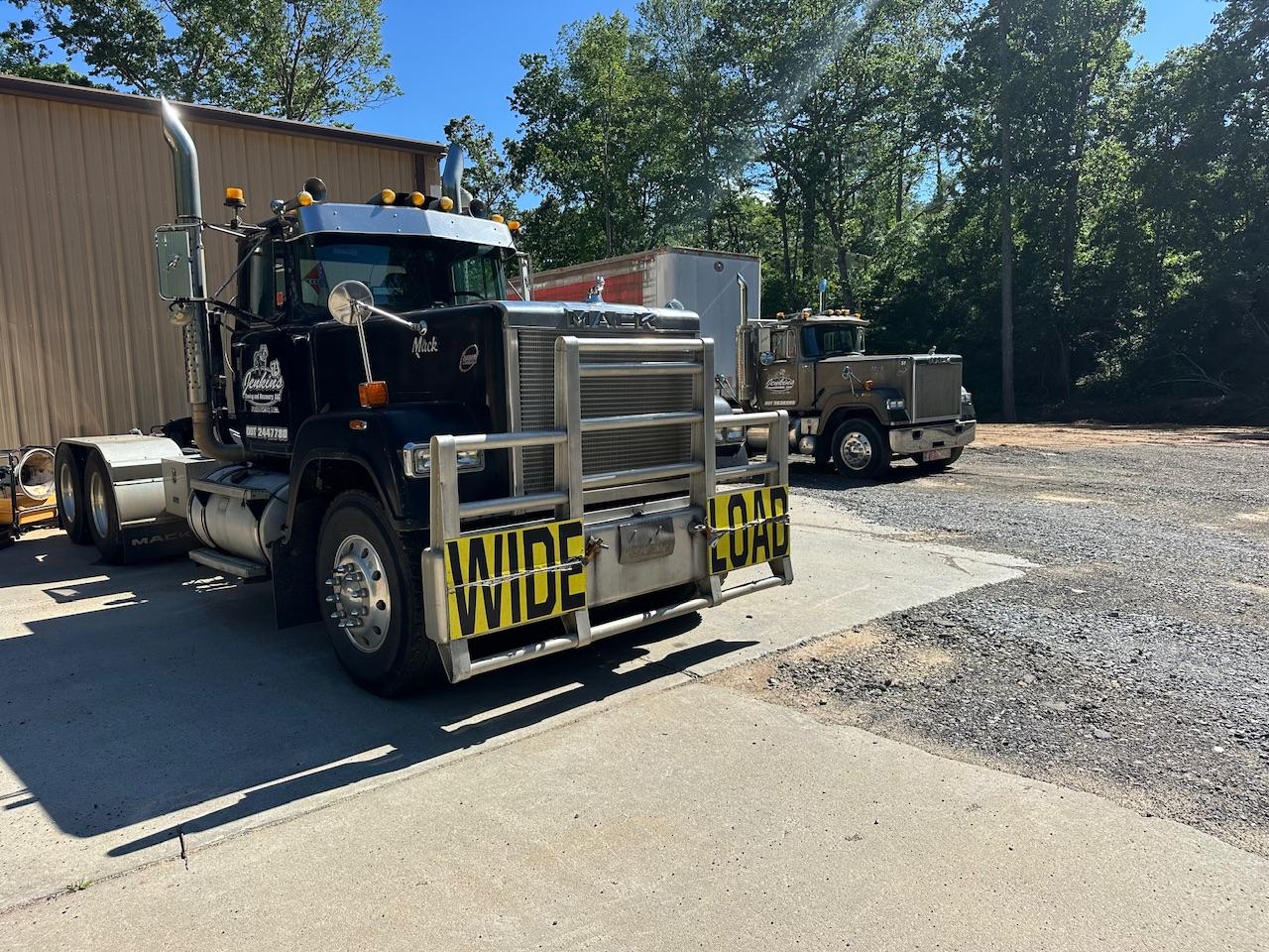

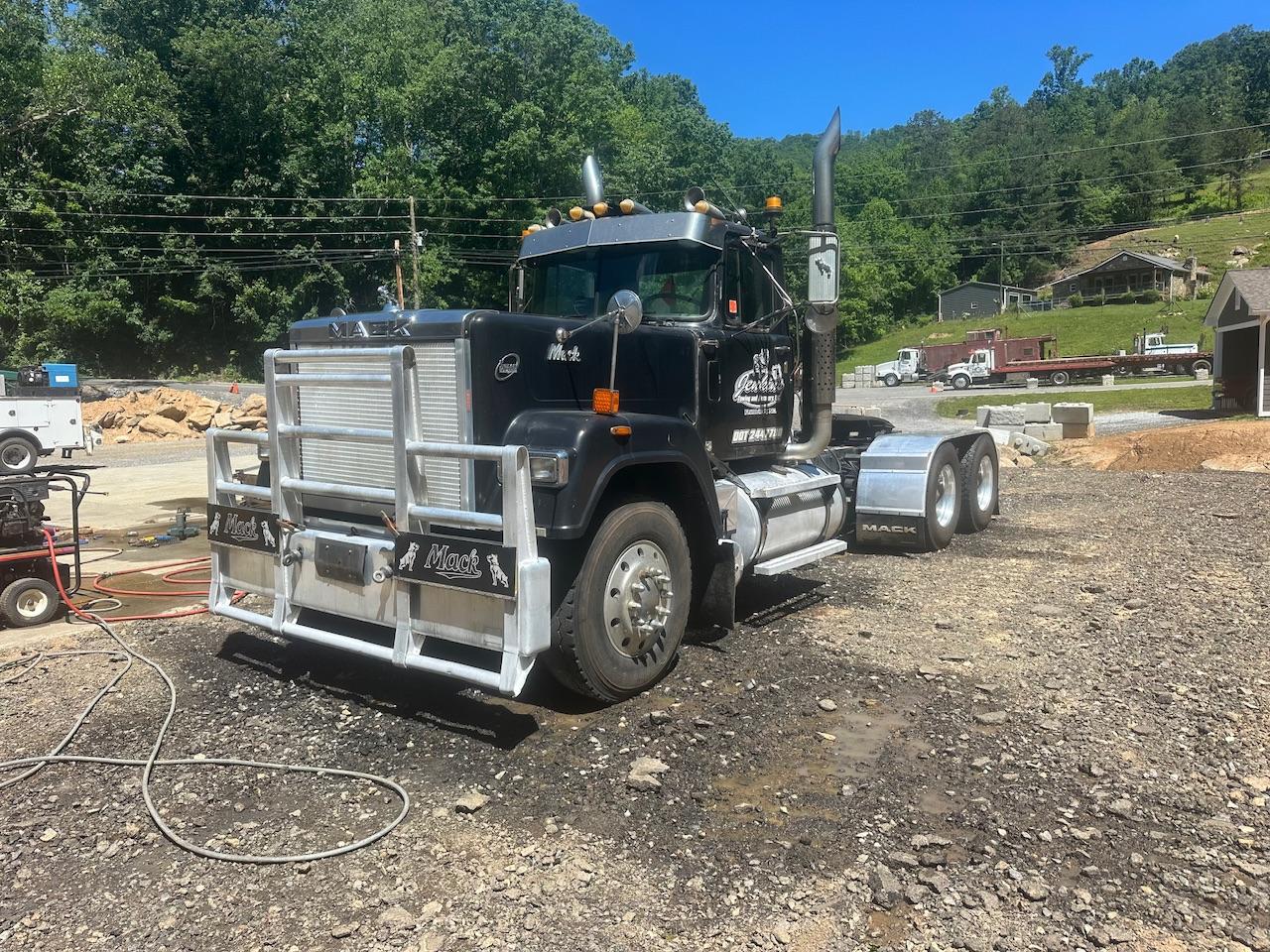

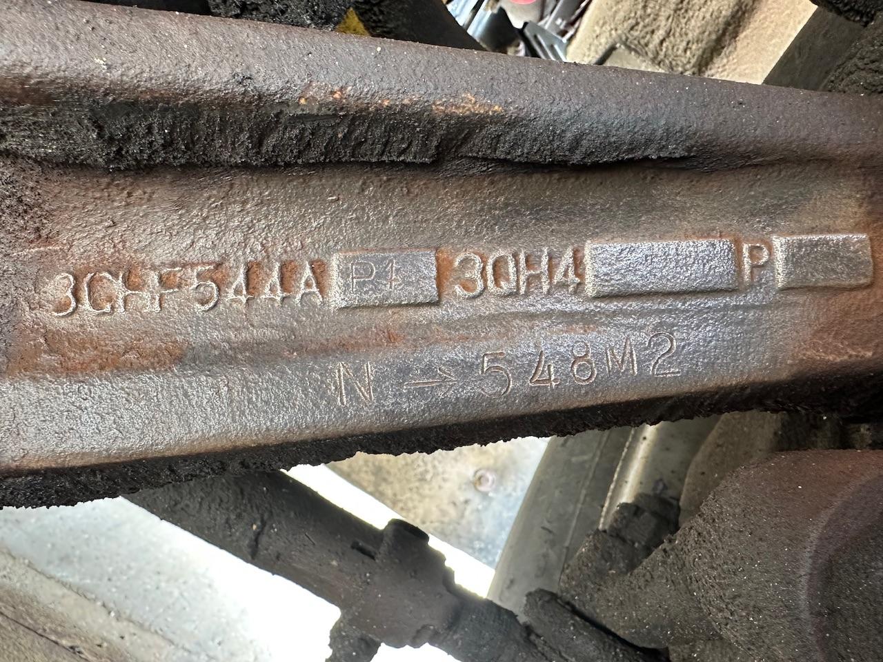

I have been pressure washing in my spare time, I took the Herd guard off today, so I could really get some good measurements, I’ll post a picture of the axle number if anyone can tell me what rating it is. Also center bolt to center bolt is 34.5 with a 4 inch wide spring, from what I can find a RW & MH is the only axle that is the same, Unless some CLs had a 4 in spring, It has converted hub pilot hubs on it now that I could use if I can find a axle with the same rating ( it came new with twin steering boxes and the right one was removed by the previous owner. ) it’s  a pretty decent old Superliner, 3406B , 18 speed Eaton, Newer Mack air ride rears 3.90 ratio. I’m planning on restoring it when I get the shop repaired and using it , but the steering axle the first project.
That truck looks to be in nice shape.
